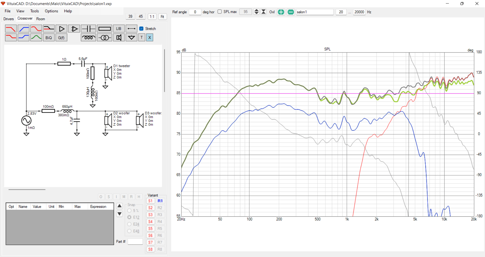

Here's my main speaker design, there are 2 of them (I need to rearrange the crossover to get a bit more bass since I've tested it)
So, yes my main speaker goes around 100Hz. I was thinking that letting it go around 150Hz-250Hz would be more efficient and clear (that's why 20Hz - 250Hz). Is it a good solution ?

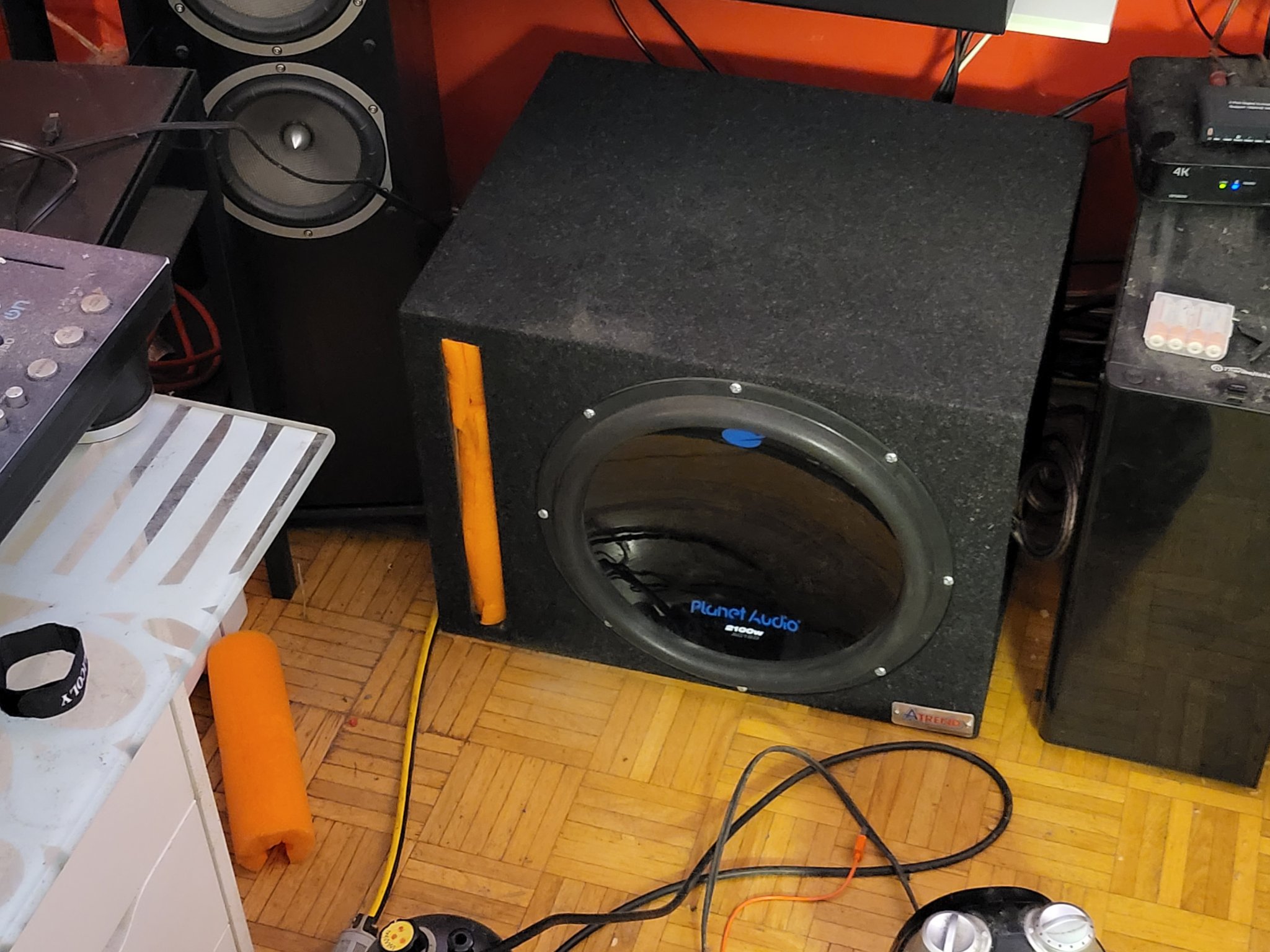

LOL no not near flat anyway. It will certainly wiggle at 5 Hz like my other speakers though. It's just so the slope works... It's not brick wall filter at 13Hz... It's just there to fill in sub 32Hz and I don't really want to hear it above that... It feeds a Yorkville AP1200 set as a 950W bridged amp into an 8 ohm 15 inch car sub. It's plenty for a 12x18 foot room :") The vented box is now "sealed" with a pool noodle.

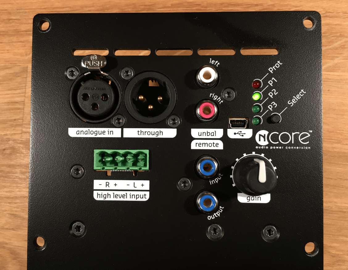

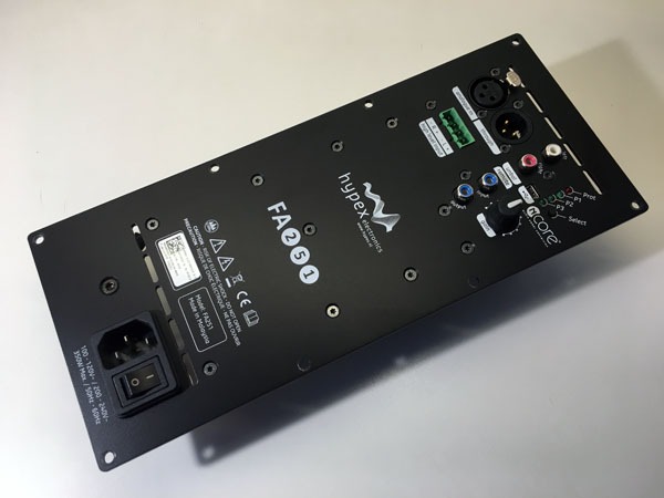

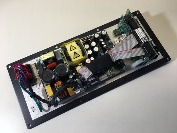

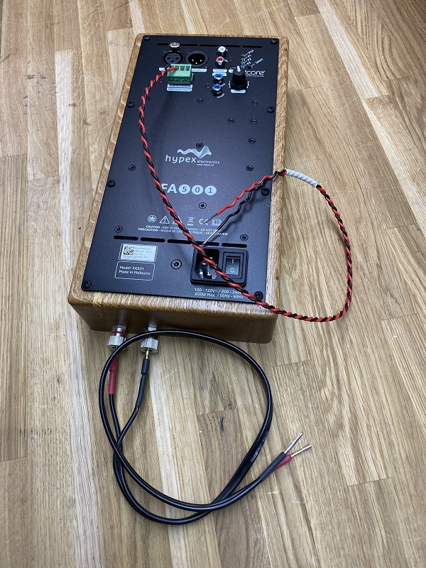

Since you sound like you could use the amp as well. These might be the next best thing since the invention of the subwoofer. This side of about 1500 CA anyway. I pushed the button on one to test out the waters, a second may soon follow its way in to my listening room.
The FA251 250 x1 with all the filters and boost you would need http://www.troelsgravesen.dk/FUSION_FA251.htm
I heard them in some NAD amps, Hypex are real work horses and stay cool, and up there with cutting edge D stuff.
I was going to go with a Crown XLS (which is a very good but slightly different route) but I wanted the extra versatility the Hypex offers especially eq, my subs will fail without a few db of boost to sound right. Despite the eq boost I think the Hypex will do much better than the crown, also despite having less power that the 1500 crown.
I am under the impression they make rock solid sub amplification.
I just hope there are no windows hang ups being the FA line is still relatively new.
So far its looking like great bang for the buck. Plus I love how they are going to custom fit and integrate with my rack. Pictures later as always. they are enet surplus (not mine)
