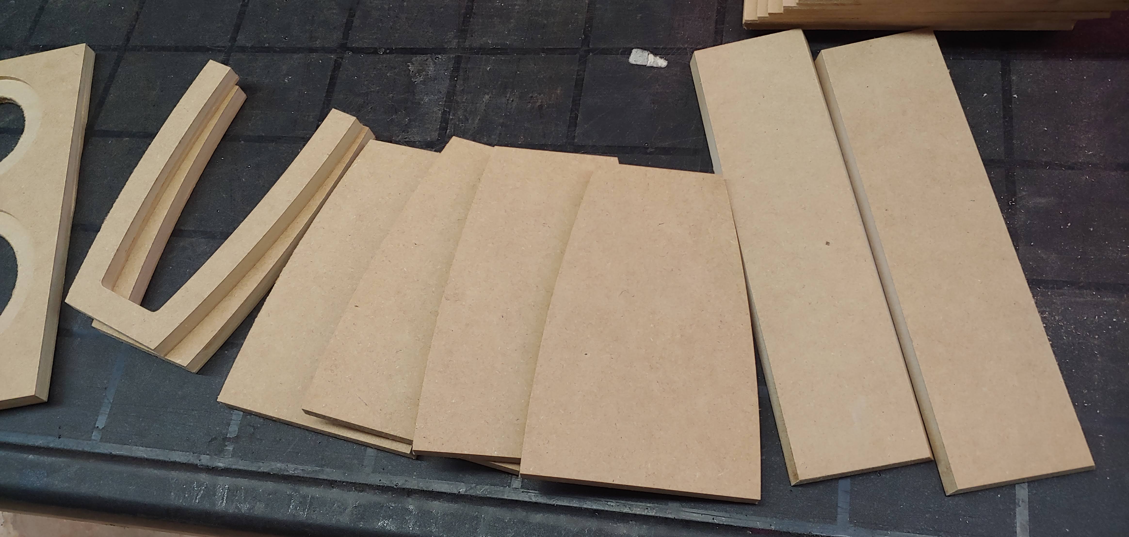

Build start
Hi Boris,

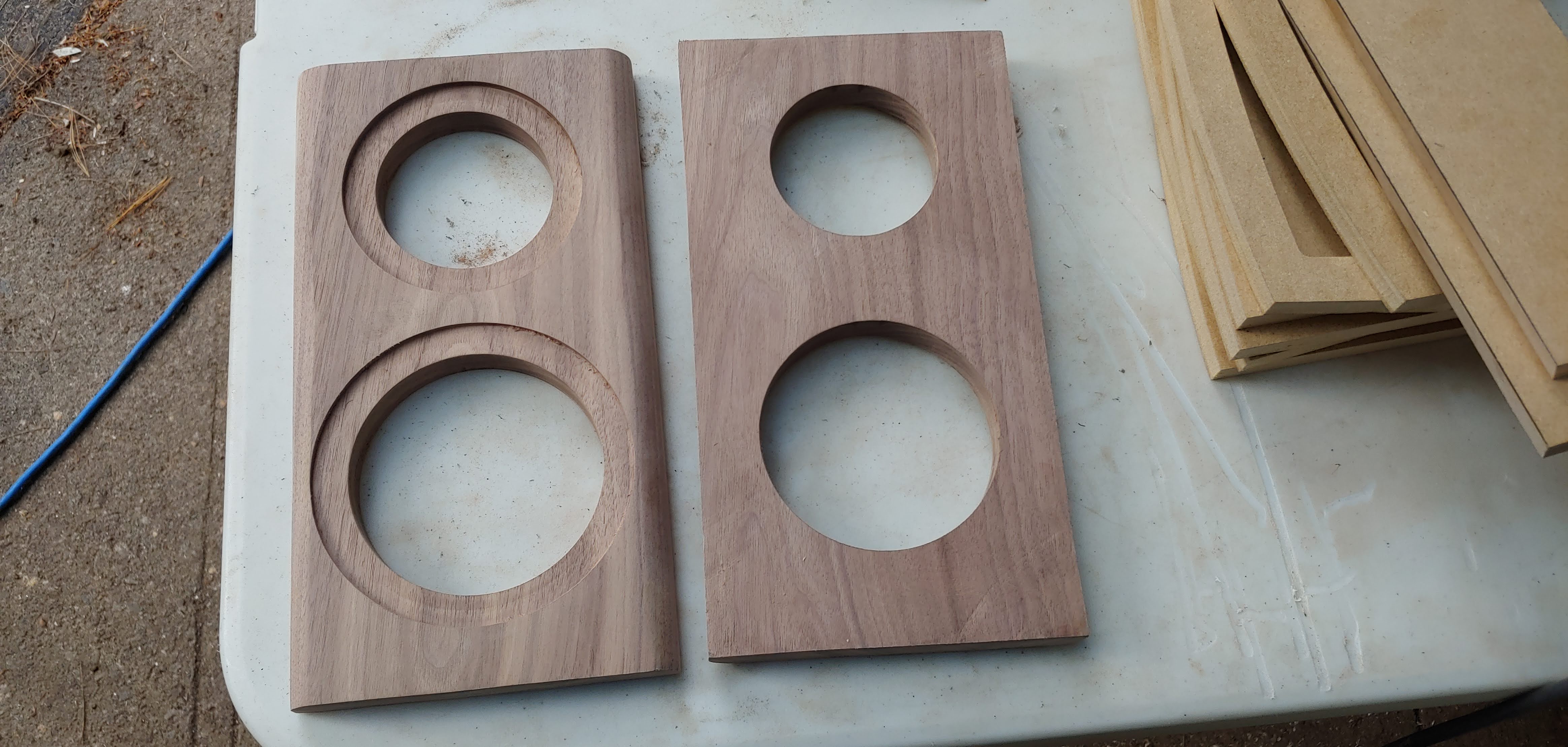

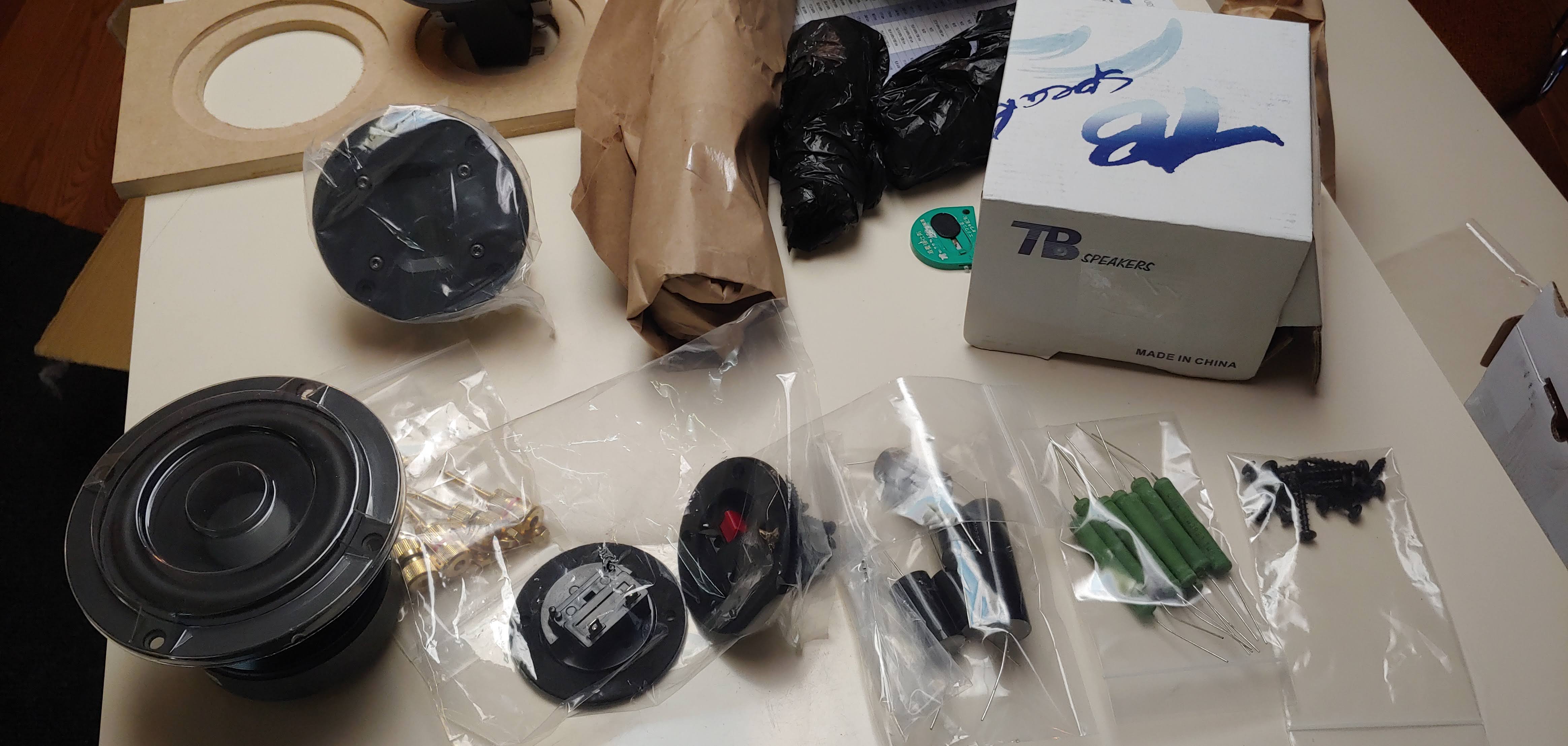

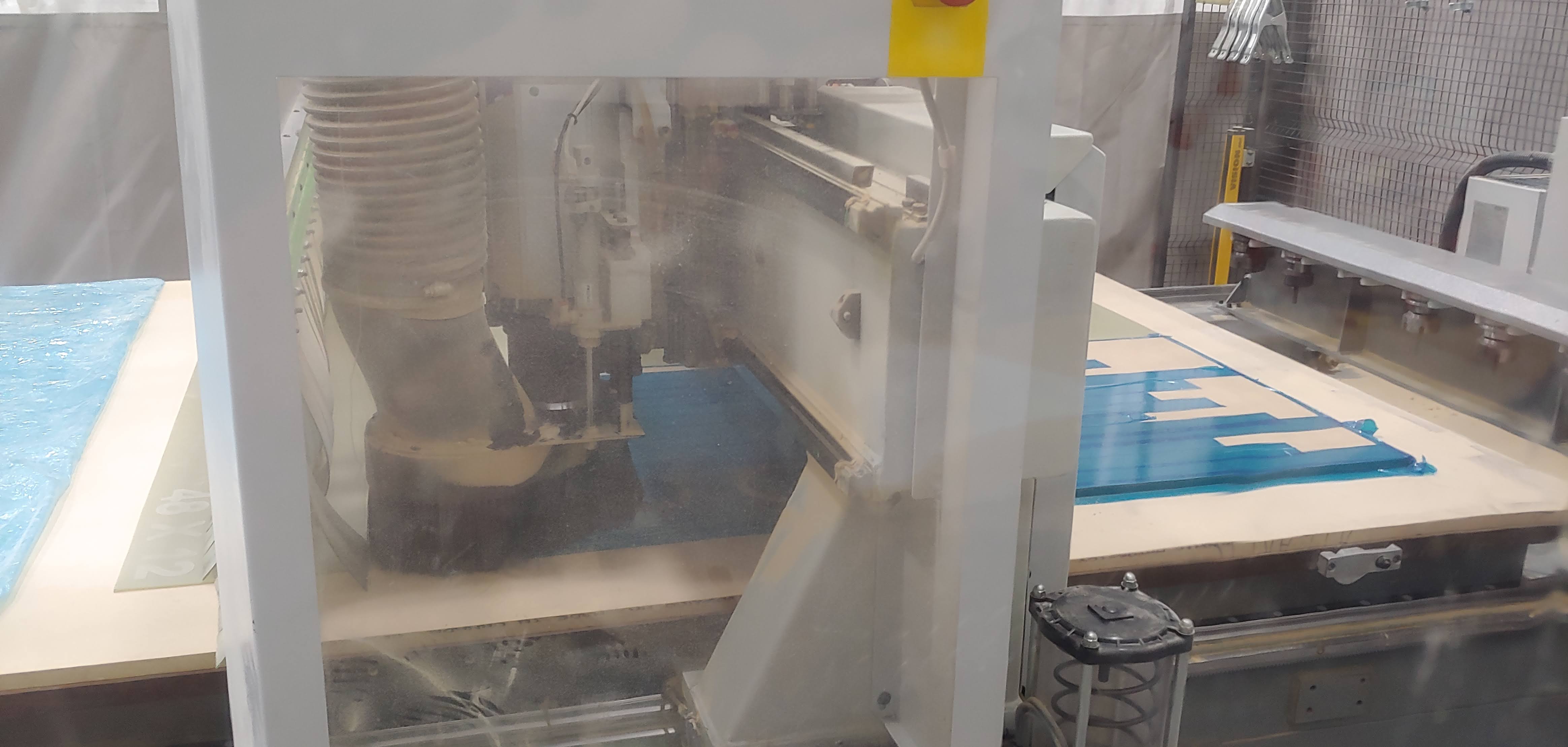

Thanks for your feedback. I bit the bullet ad ordered the parts for the Speedster. I took zman's advice and kept the baffle width the same (6 inch external). To keep the same volume I have raised the height of the speaker by 1 inch. This allowed to lower the woofer by 1 inch to prevent the overlap of the original design.

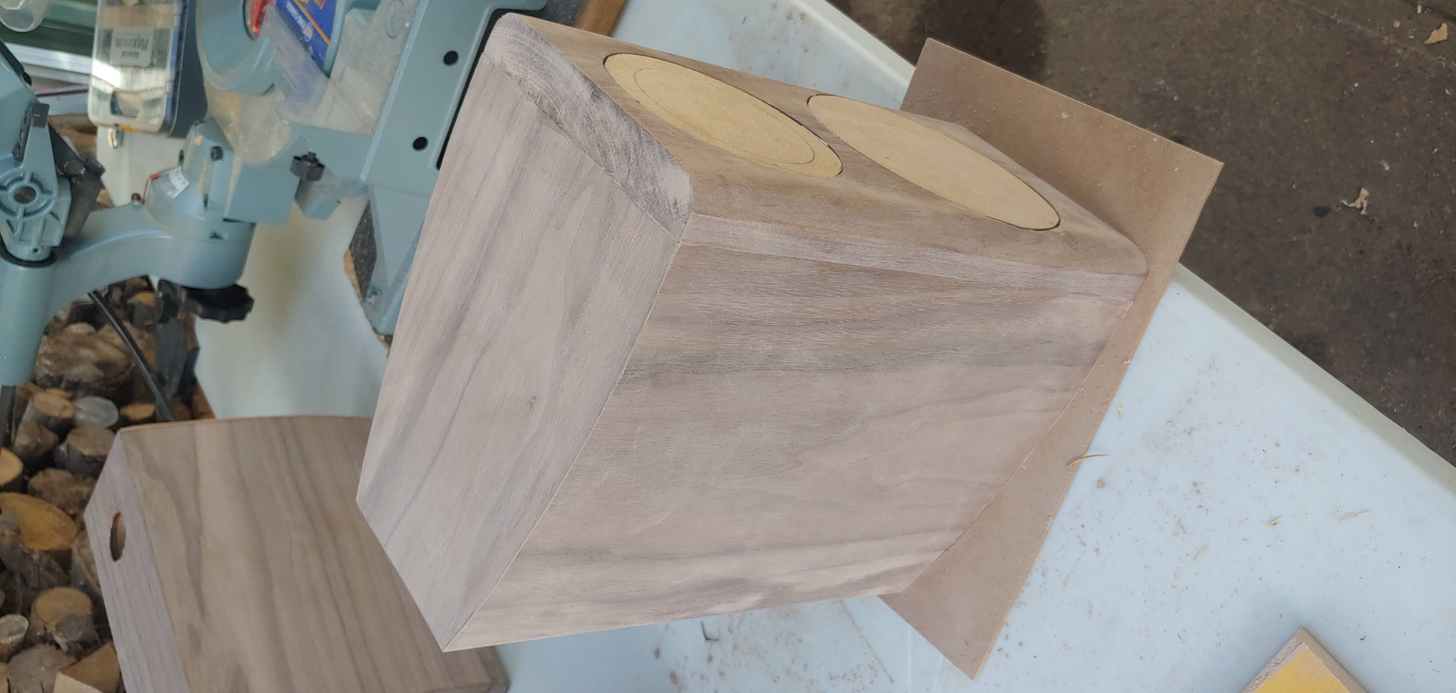

I originally wanted to make a curved box with pieces of brass trim for extra effect. However I had a hard time coming by the brass I needed. I tried some aluminum and other wooden trims, but they just didn't seem right. I settled on a black walnut baffle with curved sides that will be veneered in back walnut.

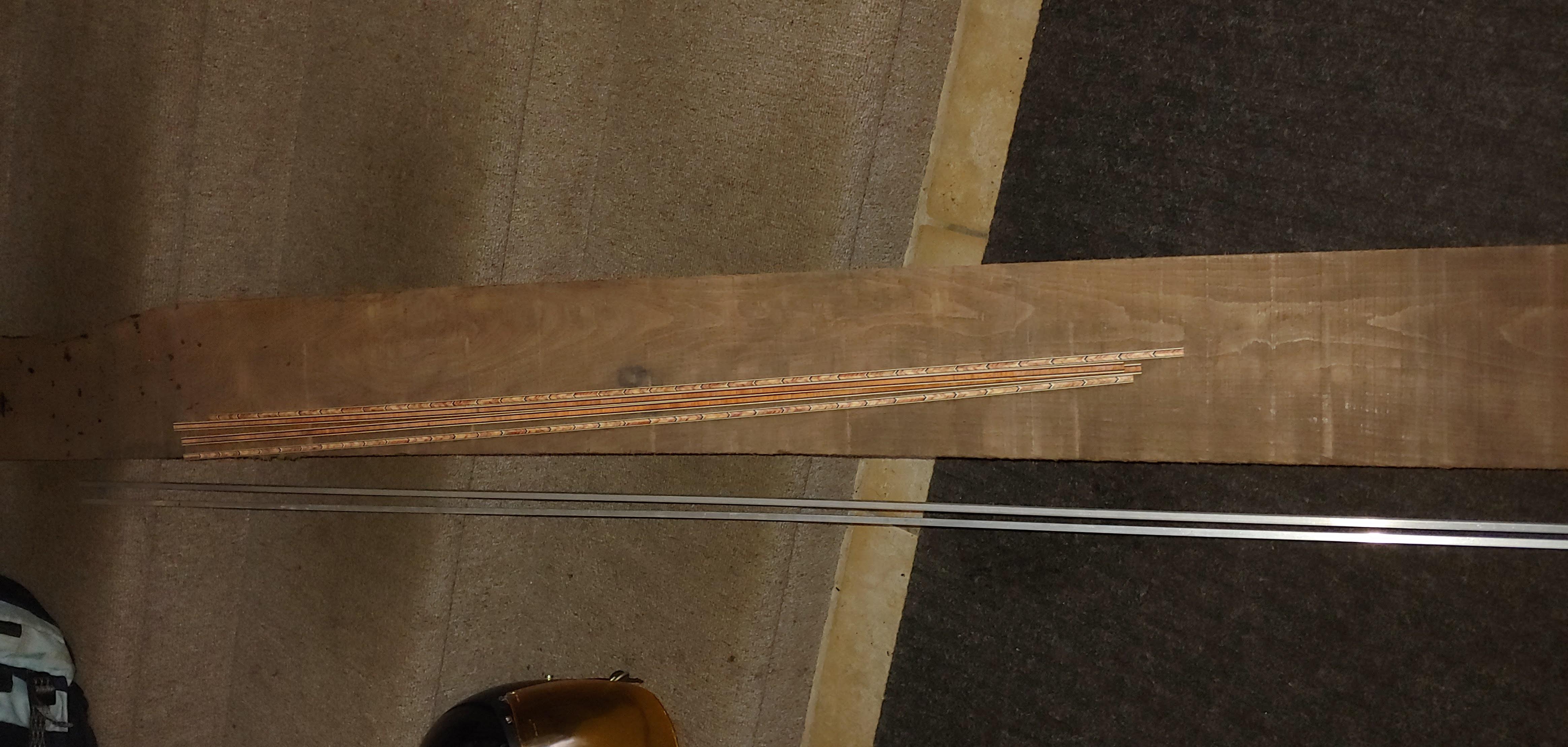

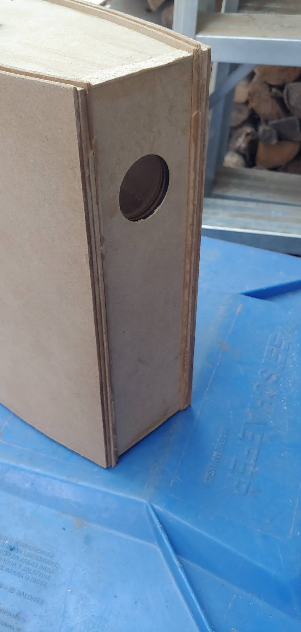

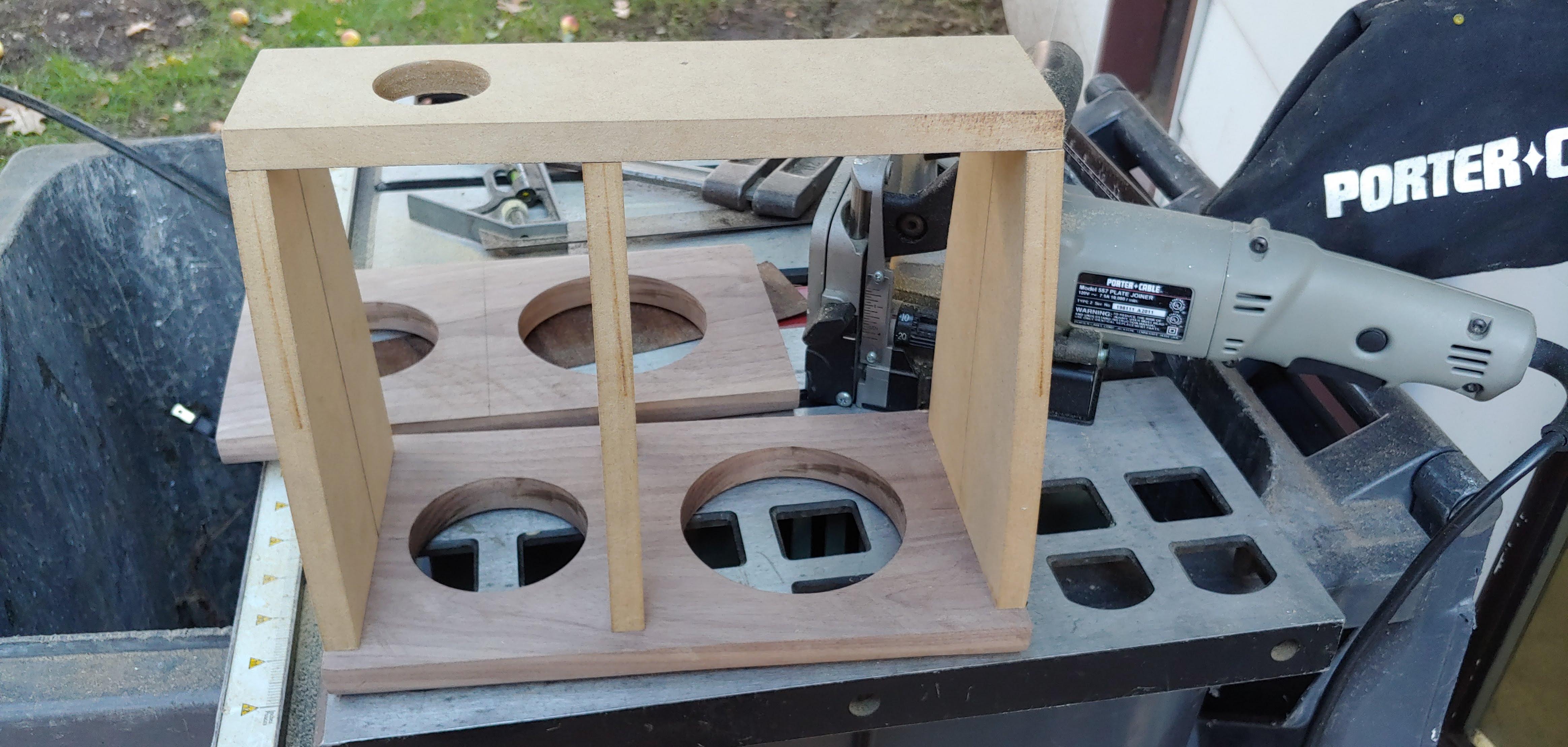

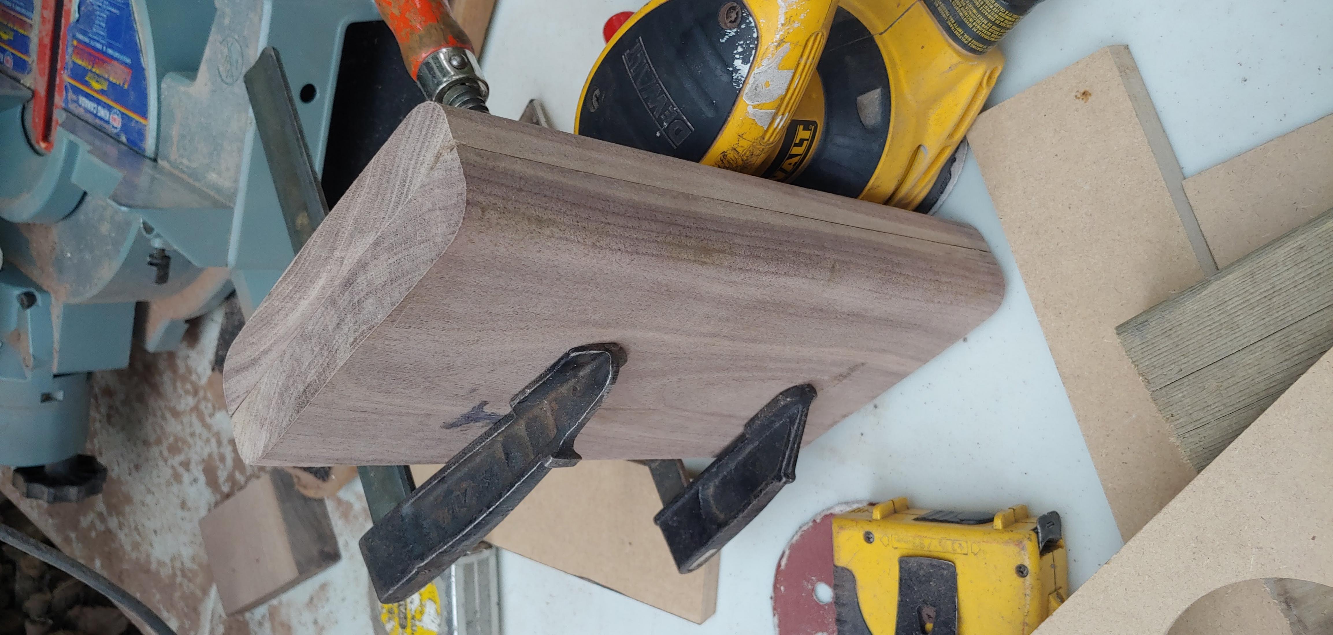

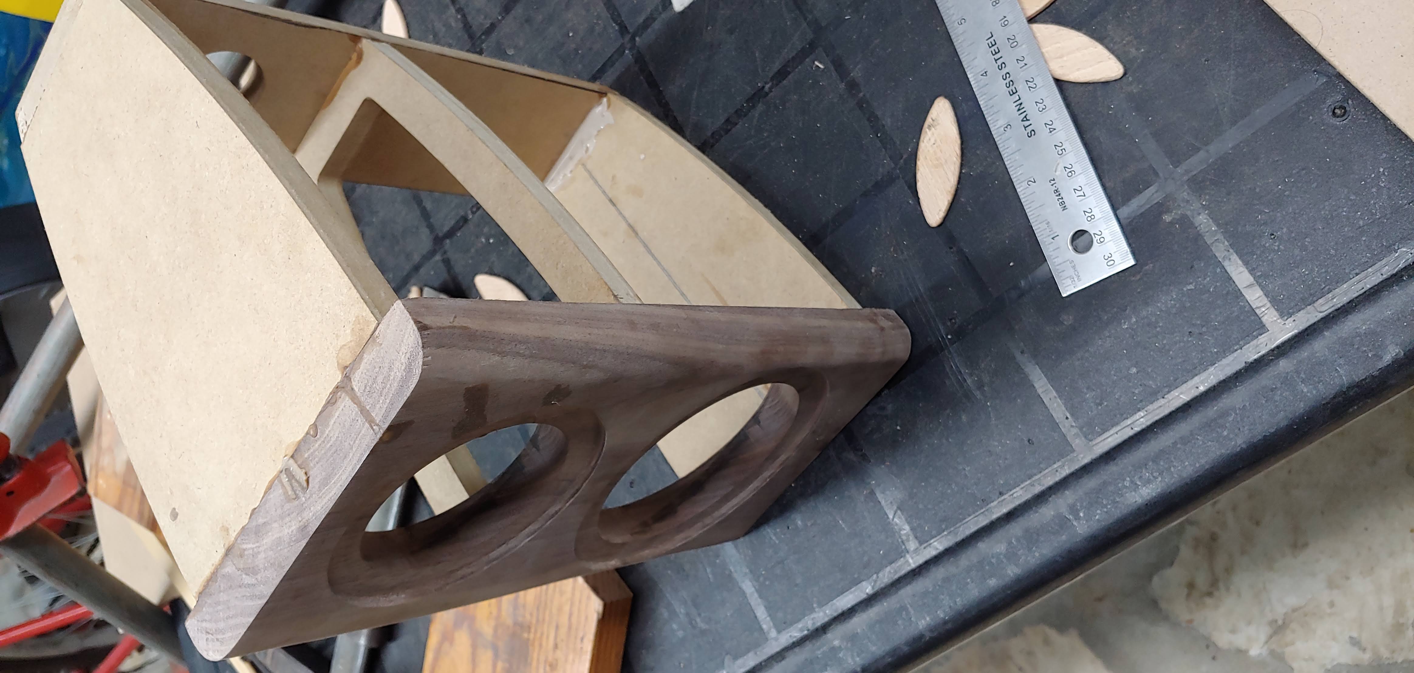

I started with a rough plank of black walnut for the front baffle. I CNCed the rest of the 0.5" MDF on a 3 axis I had access to. I worked the black walnut for two days. Long story short, I did not have the right tools and I lost a few more along the way (RIP table saw...).

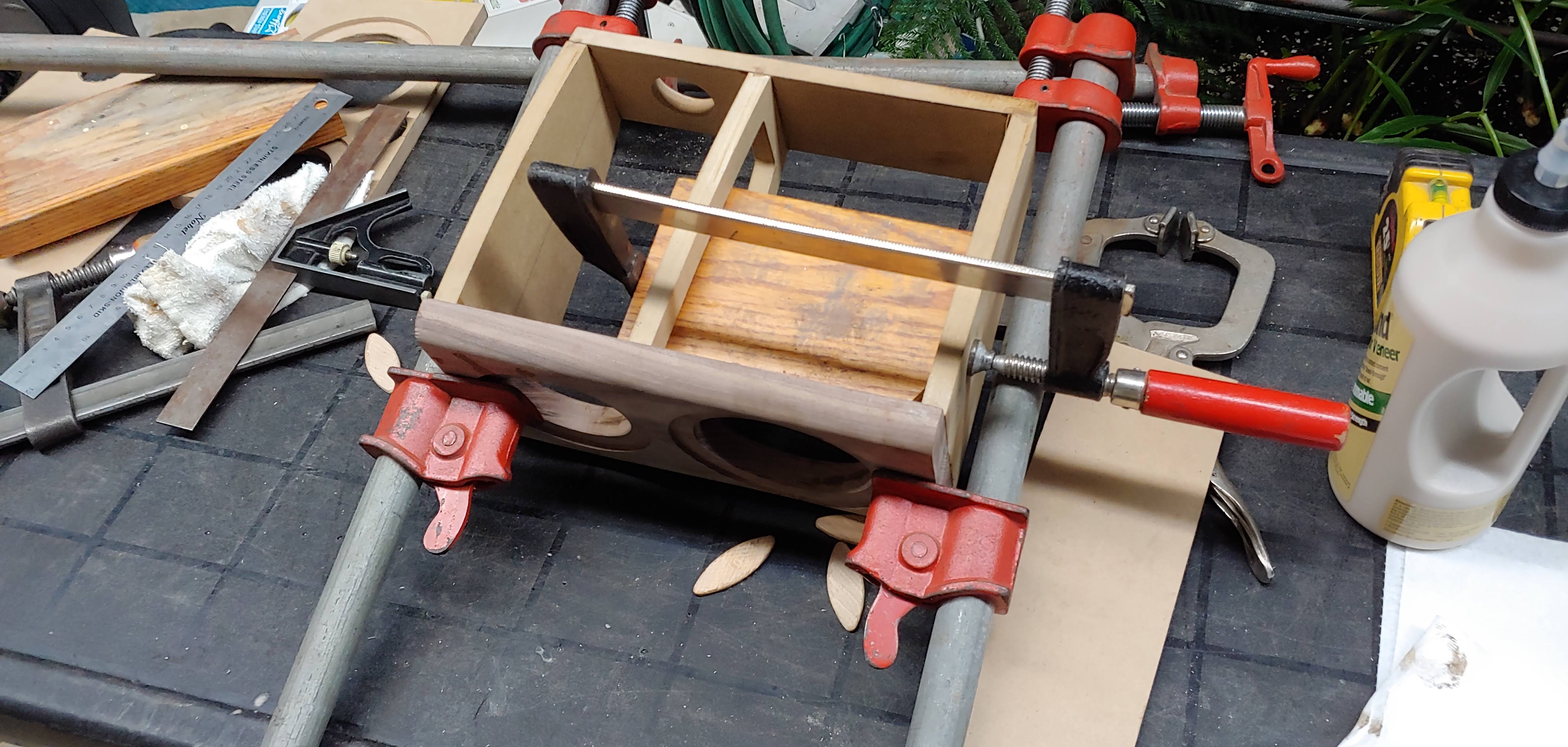

I ended up using biscuit joints to join the MDF with the black walnut. The gluing together was a bit of a pain at first as I only had massive clamps which made it hard to work with the small enclosure. Keeping things square was especially hard. Thankfully it worked out fairly OK. Also, I thought I had yellow wood glue left at home, but unfortunately had run out. I ended up using the Titebond cold press veneer glue I had bought for my veneering job. It might not have been ideal, but the bond seems quite good and it gave me extra work time to set things straight.

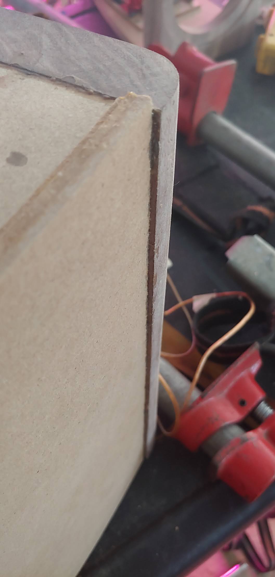

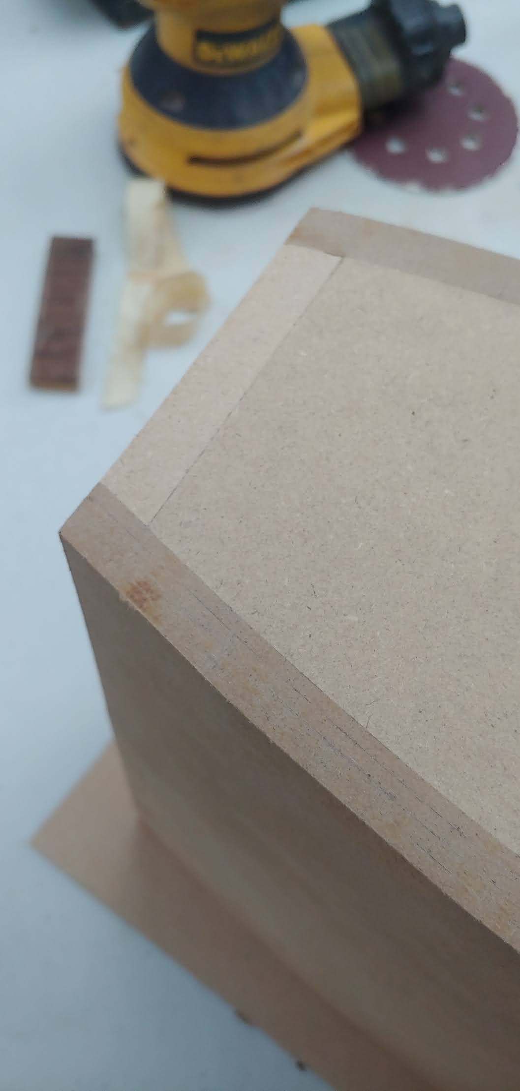

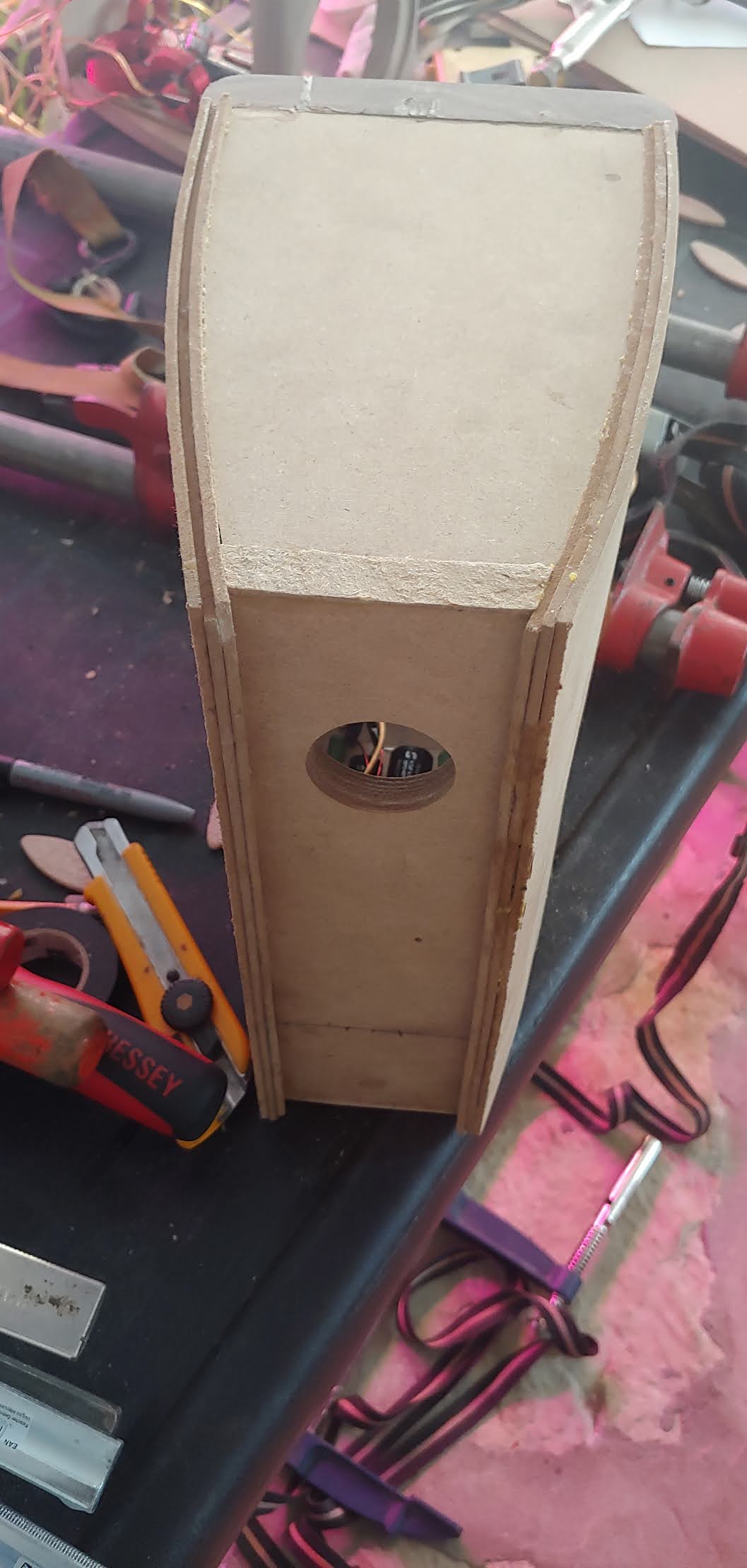

The back board ended up being too short and I have had to make shims an glue them on both edges to fill the gap.

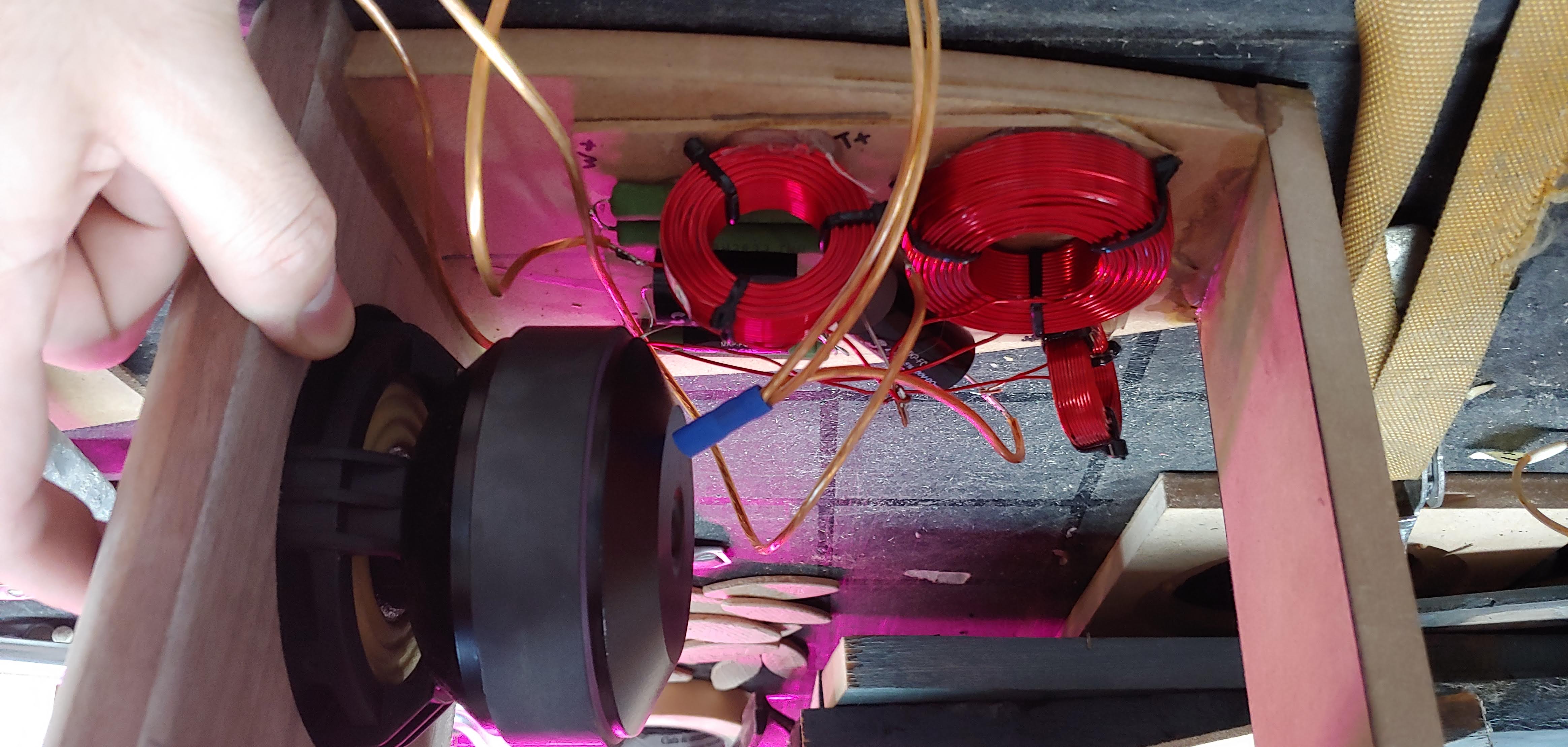

I made the crossovers and tried my best to keep things as compact as possible. The curved shape makes space inside the enclosure a bit harder to work with. I am a bit worried about the inductor being close to the woofer. I'll upload pictures of this later when I get time.

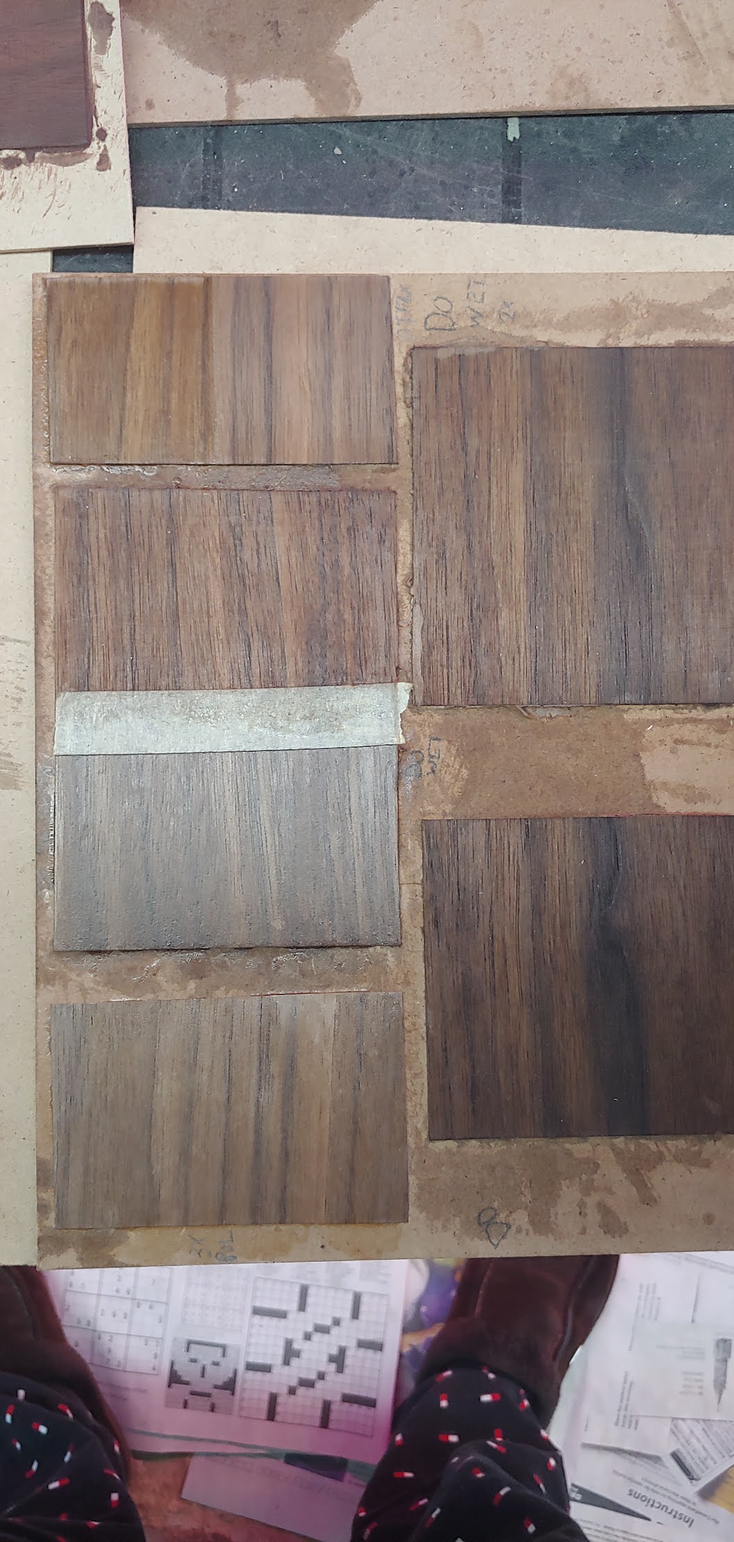

When I veneered my projects it was three pieces. The set of Speedsters I purchased had the battle done up just like yours. I was told the builder and Paul C. conversed on that and Paul said that would be ok. That's what I was told. You might be able to find his build in the archives of Parts Express' Tech Forum. If I remember correctly his name was TechnoDan.

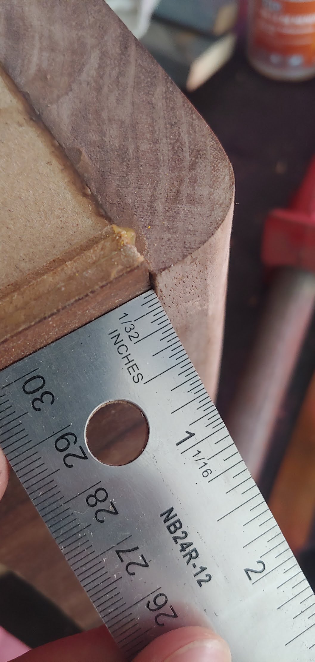

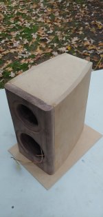

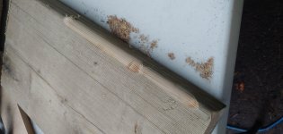

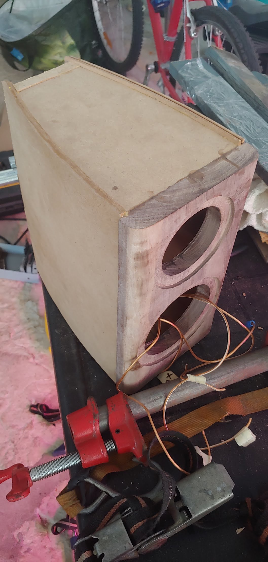

Quick build update with few lessons learned.
Zman, where did you get that the tweeter and woofer were designed to be as close as possible? I read through some other builds and Paul himself (the speaker designer) mentions in post #89 that the enclosure can be build taller to avoid the overlap with negligible effect. That is what I based my decision on.

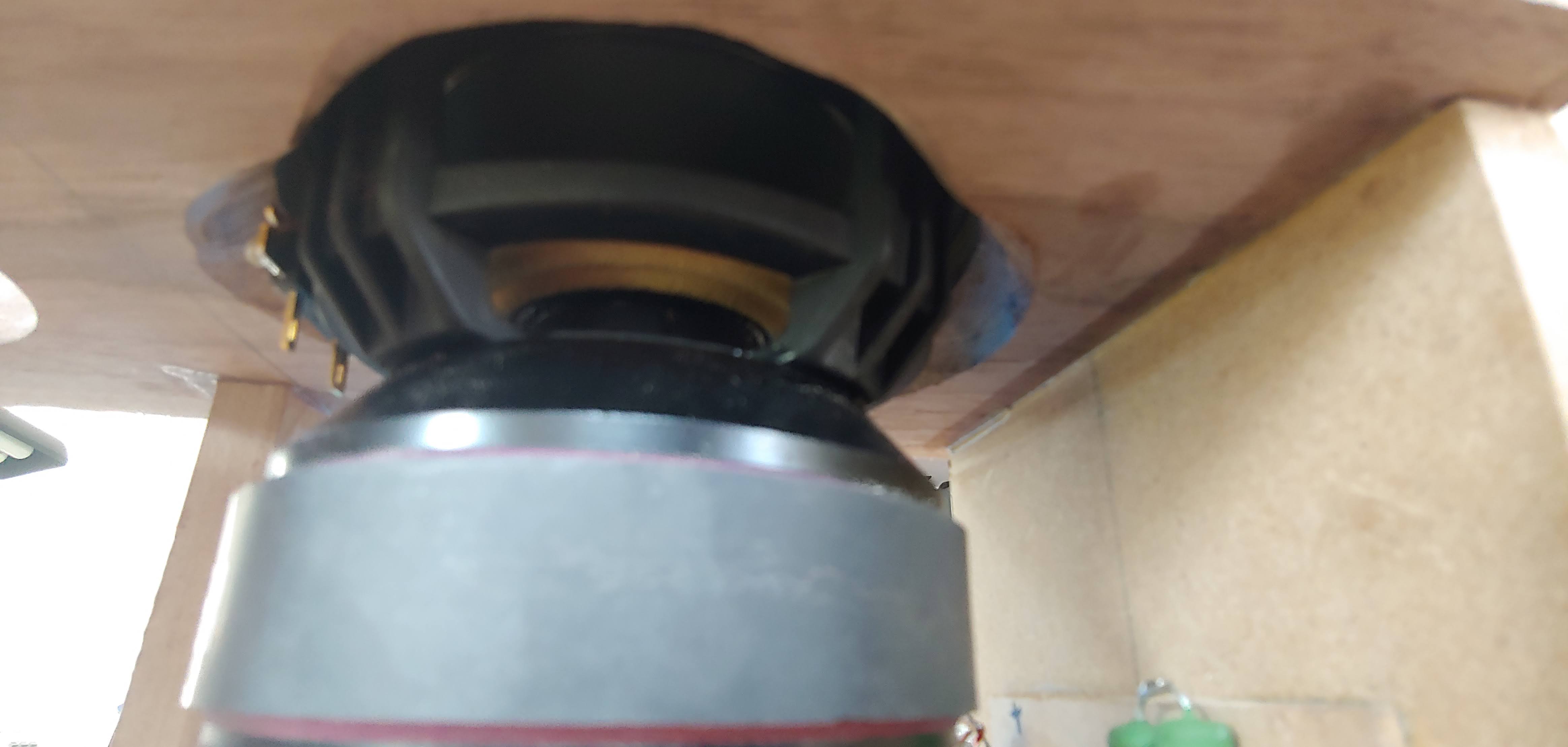

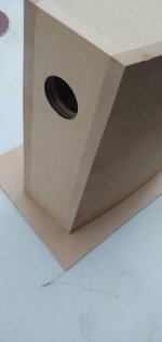

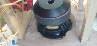

I got the crossovers fitted to the enclosures and glued in place. As mentioned in earlier post, picture of the woofer and how close it is to the coils is attached. Not the best, but the best I could do to fit within the narrowing geometry of the curved sides.

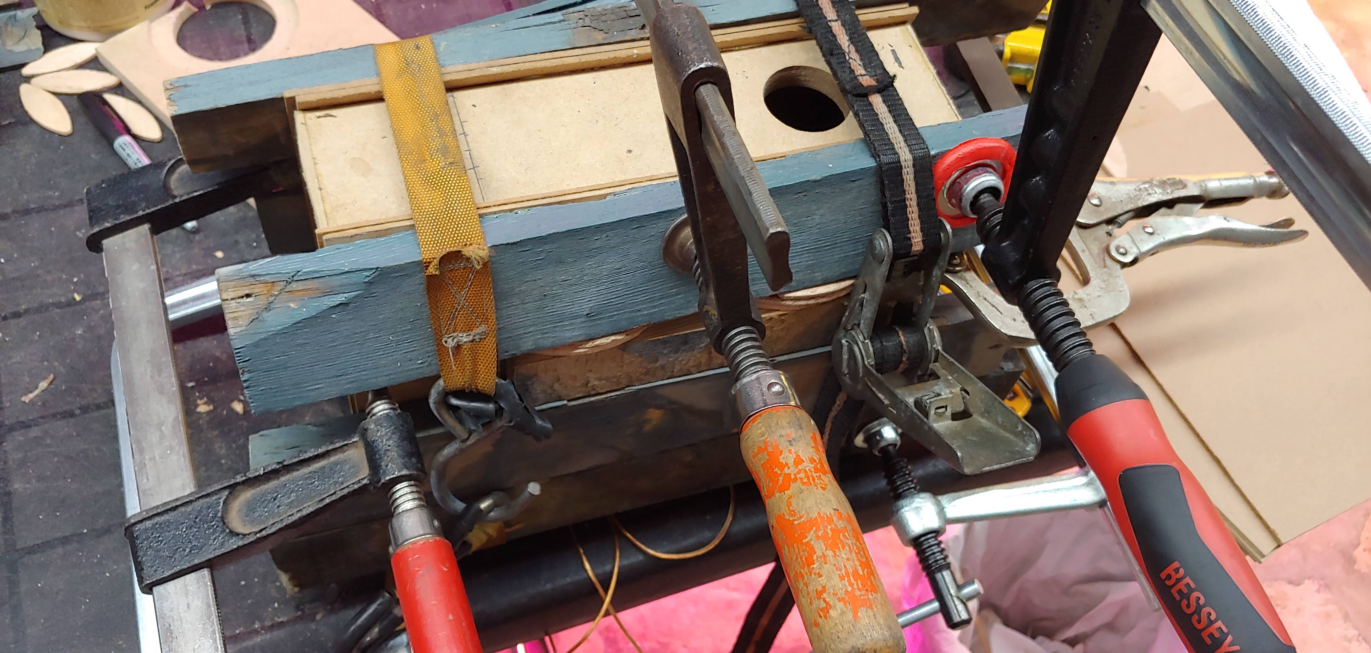

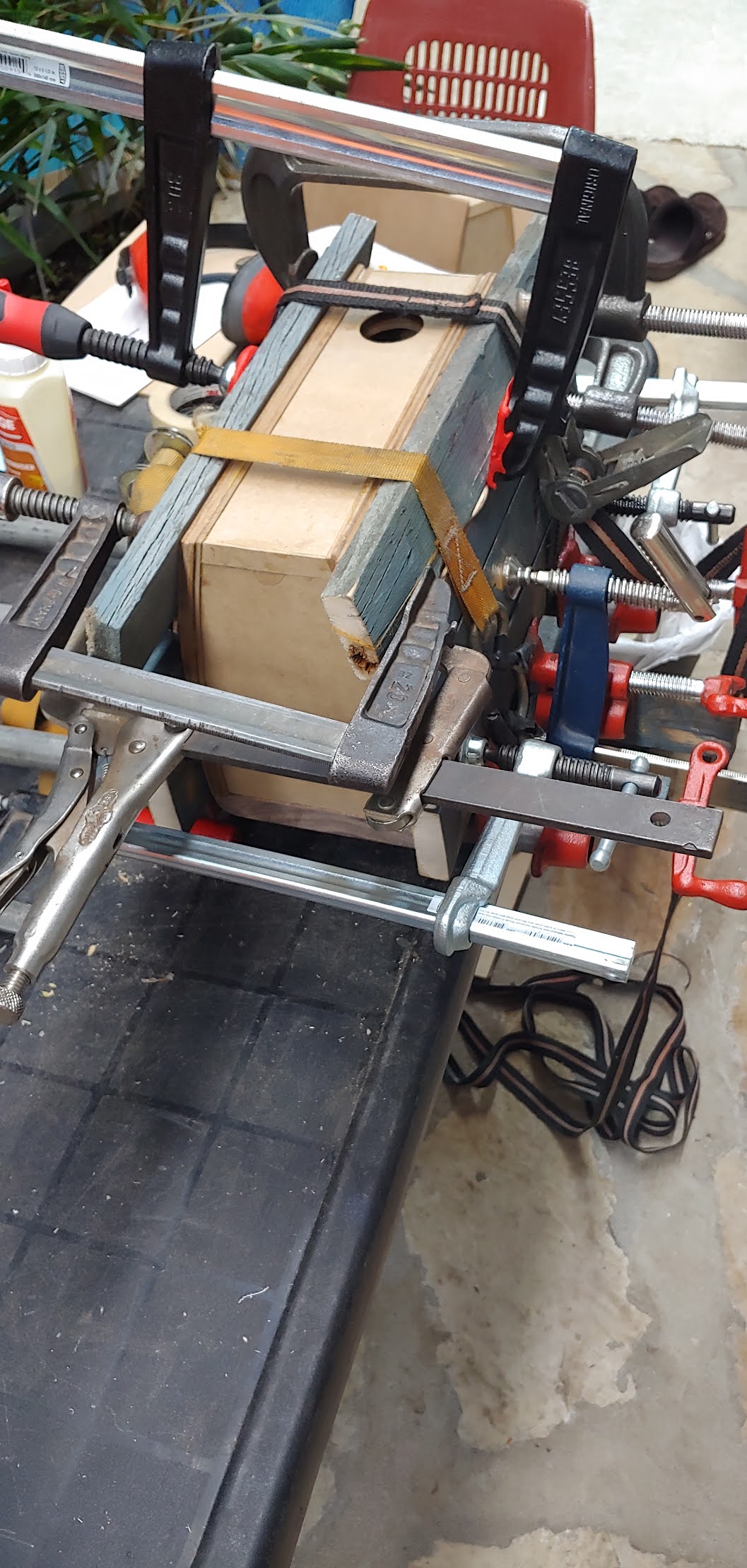

I started laminating the curved sides and decided to do two 1/8" thick boards at once. This was in my opinion a mistake. I should have done a single sheet for the first bond to reduce how much everything can "shift". Also, it requires alot of attention to detail to make sure that there is good pressure where the 1/8" panels meet the inner ribs. Only one sheet thick would make that process alot easier.

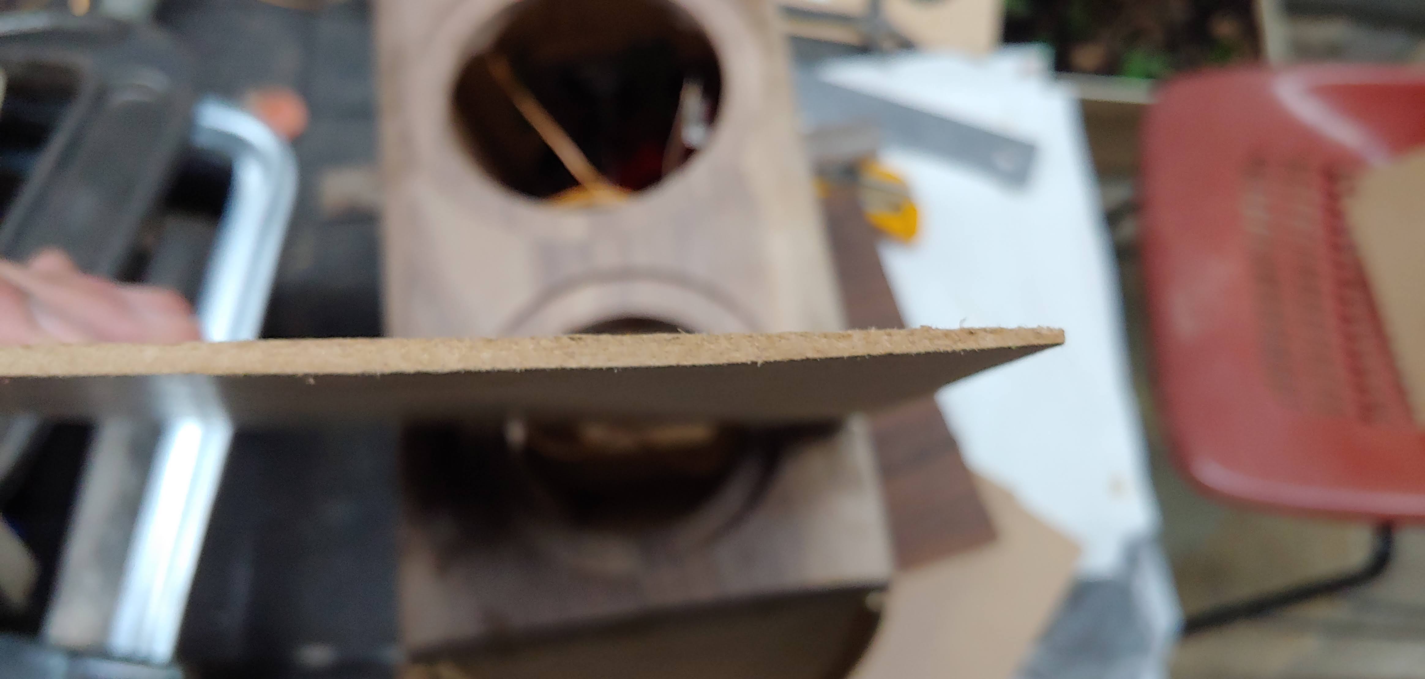

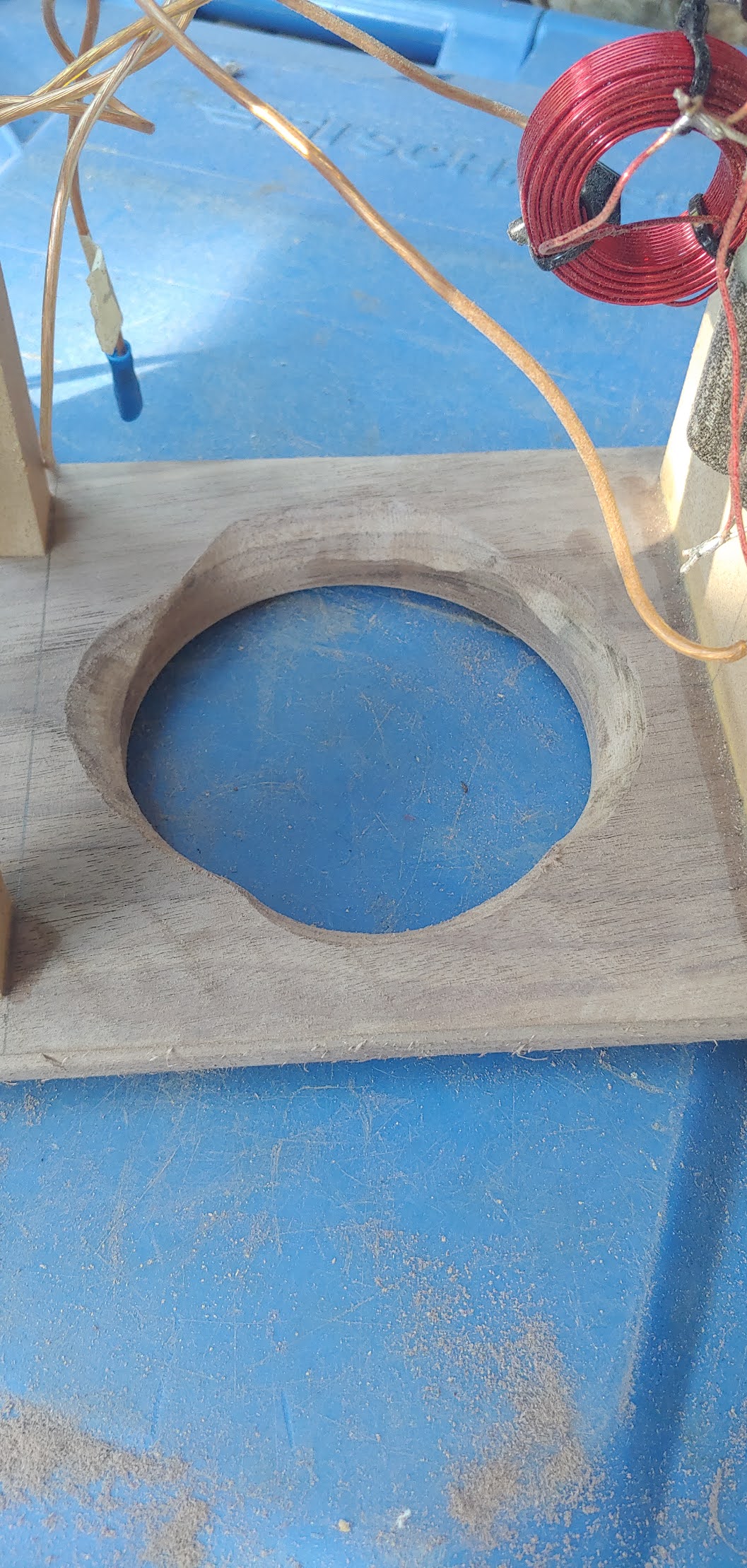

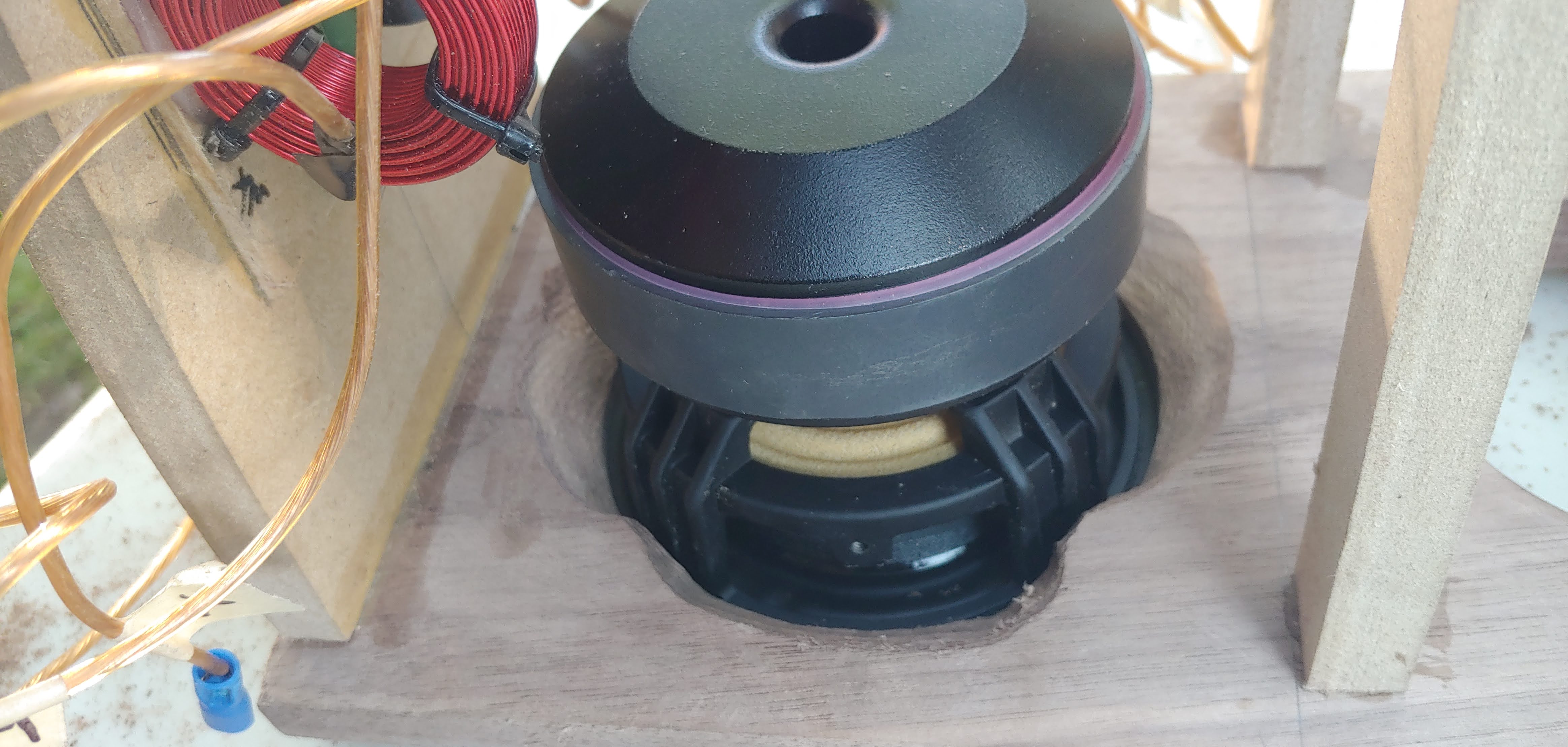

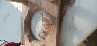

I also forgot to chamfer the inside of the woofer hole. The front walnut board being 1" thick, I'd like to have the chamfer to minimize effects on the sound. I will try to get it done after the glue dries with , hopefully, little hassle.
Since Paul himself has stated that the design can accommodate a little offset, then you should be golden. I was not aware of this discussion on the PE Tech-Talk forum. In most cases (not all) designers stress that the center-to-center distances should be followed.

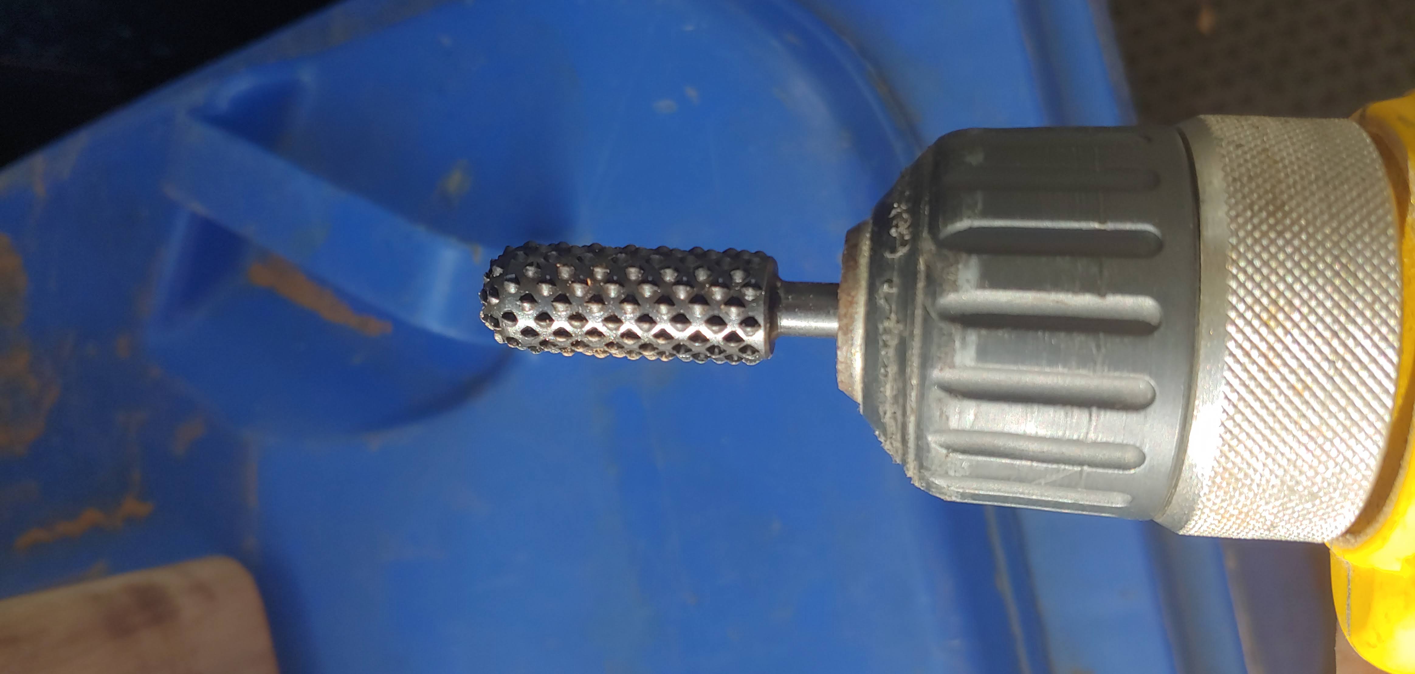

You can do that with a rasp. Will need some elbow grease, and will generate some saw dust.
Good luck with the pending work and look forward to updates.

have a look at this my build: Another 6.5”+1” BR design (Peerless HDS + Seas Prestige)
I think that a solid wood glued baffle can be a problem.
You absolutely need to do it. I concur with zman01, you probably need a rasp but it will be a PITA. I don't know if there is a specialized bit for doing this with a router.

Why is that? The one problem I had with this method was to get the veneer flush. This was calculated in my design, however I messed up. The baffle width was designed to acomodate 1/2 inch either side of the baffle of laminated MDF as well as the veneer. However, having had such a hard time making the pieces of walnut perfectly square and flat made it that the baffle is about 1/16 to 1/8 of an inch narrower than wanted.
I have laminated 3 panels on my first enclosure up to now. Here is my dilemna:
3 panels are slightly not enough, but can easily accommodate the veneer and I can then sand the front baffle flush with the veneer. However, I would only have 3/8" of material on my curved sides. Is this enough??
Adding a fourth layer of 1/8" MDF would exceed the baffle's width slightly. I would then have to trim it (somehow...) to accommodate the veneer's thickness. This seems like a hassle. Is 3/8" enough thickness on the curved sides?? I do have a brace in the middle to help with rigidity.

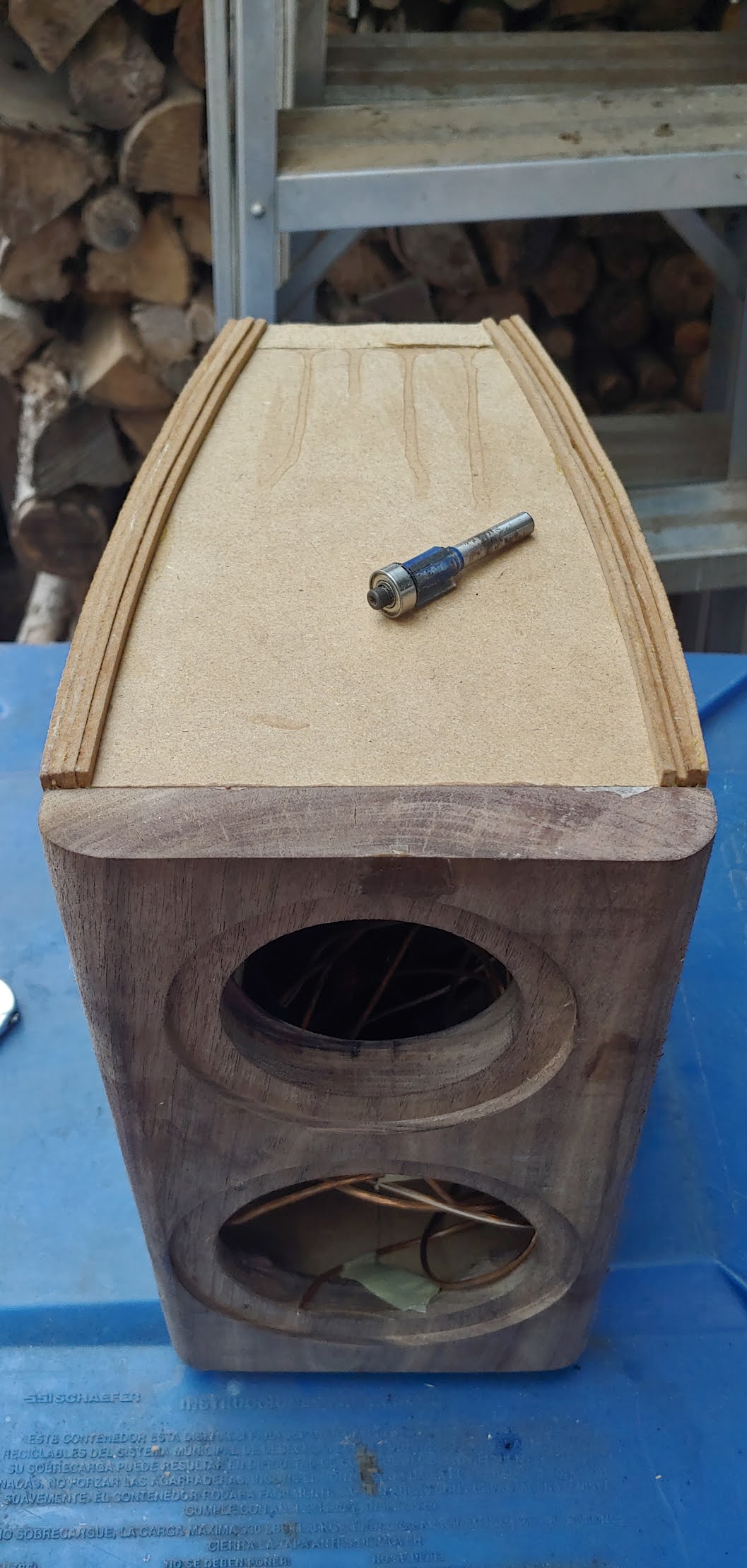

I have started chamfering the un-laminated enclosure. And truly is a PITA. I tried with a dremel with rotating sand paper. Worked kind of OK but not that great. Made a custom tool where i slotted a bolt and wrapped my own 60grit sand paper. Put the other end of the bolt in a drill chuck to make my own dremel like tool. This was quite terrible. Now I am with a rasp using elbow grease. I am unsure how much is enough. I was able to get about half the thickness at a 45 angle degree.
Any thoughts on:
1) laminating of the curved sides being only 3/8"?
2) How much is enough chamfer?

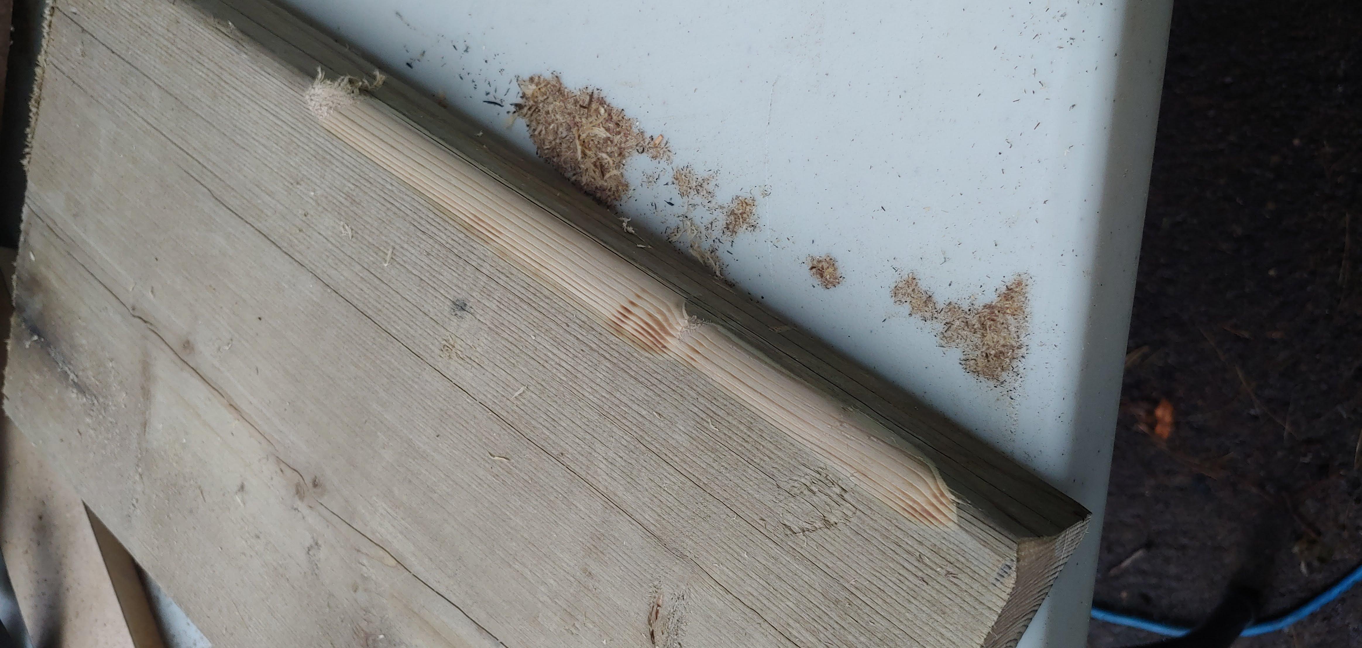

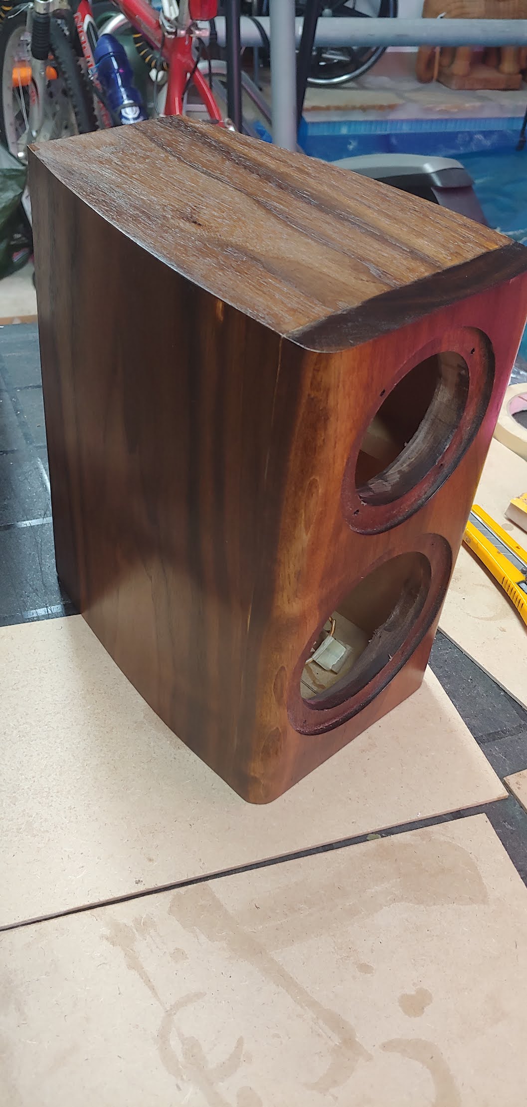

Exciting news. I found a rasp that fits on a drill. Took me 15 minutes to make the chamfers as opposed to the 3 hours I fiddled this morning.
It worked extremely well.

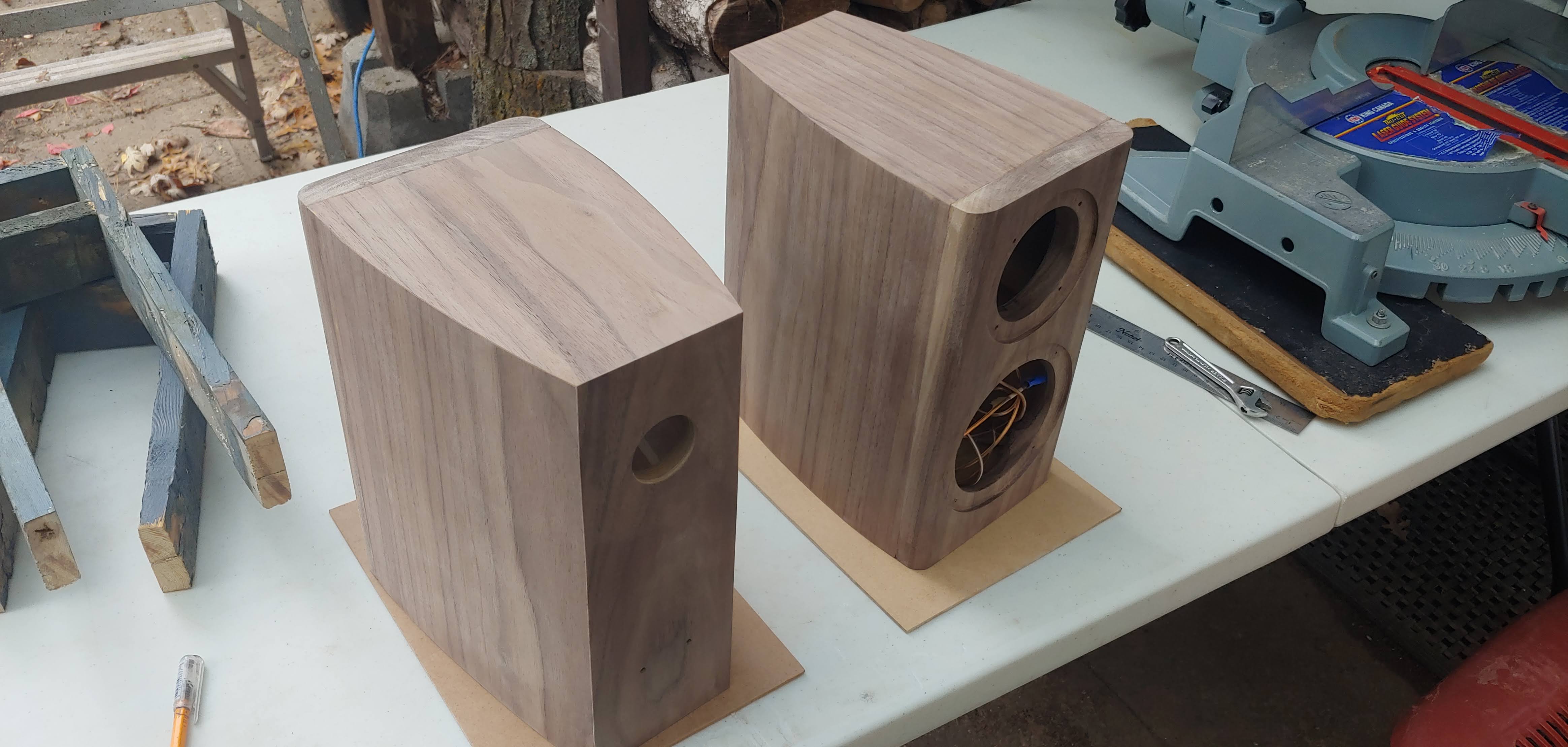

Well underway amidst few setbacks
Hello all,
Wanted to post an update of the work.

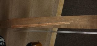

I have continued working on the laminating of the speaker with fairly good success. I really disliked having only three layers of 1/8" laminated on either side so decided to make a jig to shave off parts of an 1/8" sheet. This allowed to add a fourth laminated panel without having excess at the front baffle while still allowing space for veneer.
This was fairly successful. However, after clamping them during the lamination step, one side got "pushed in" too much somehow making it necessary to fill the gap I had just made...
Final clamping:
Before trimming of laminated enclosure:
Trimmed enclosures:

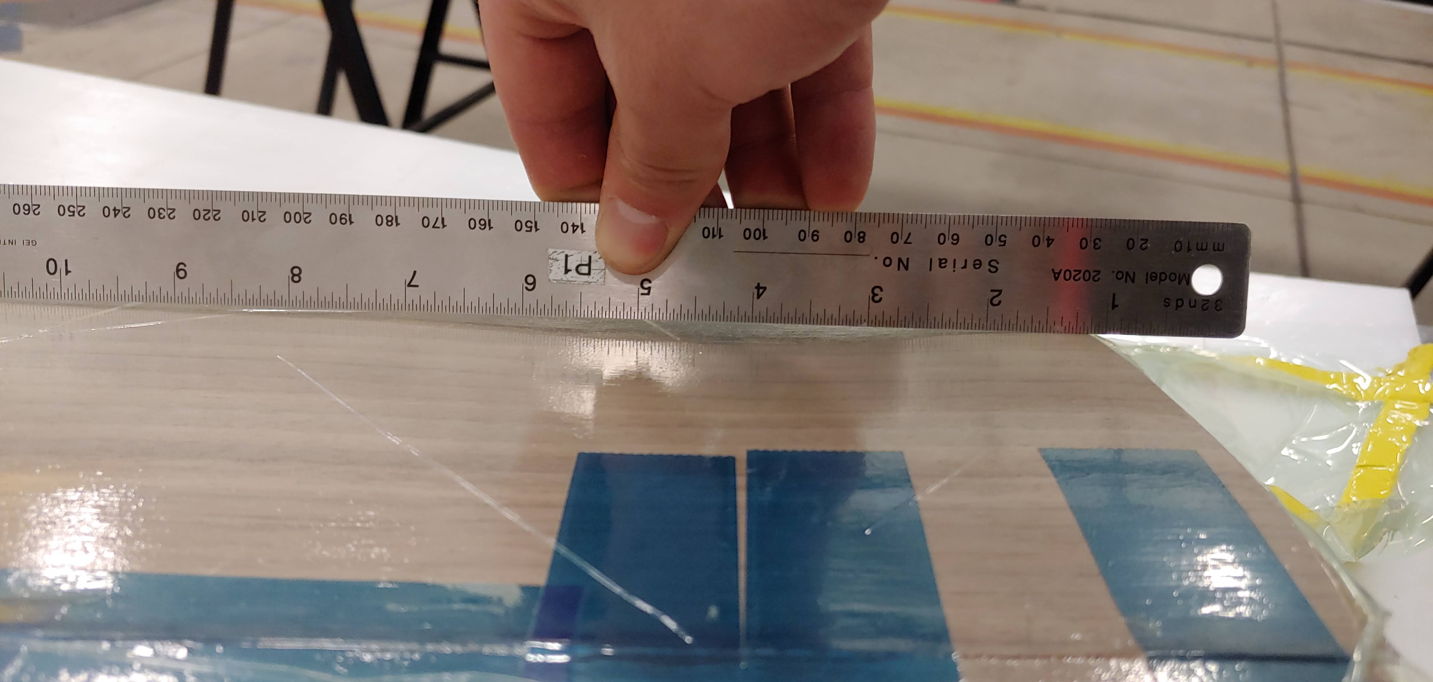

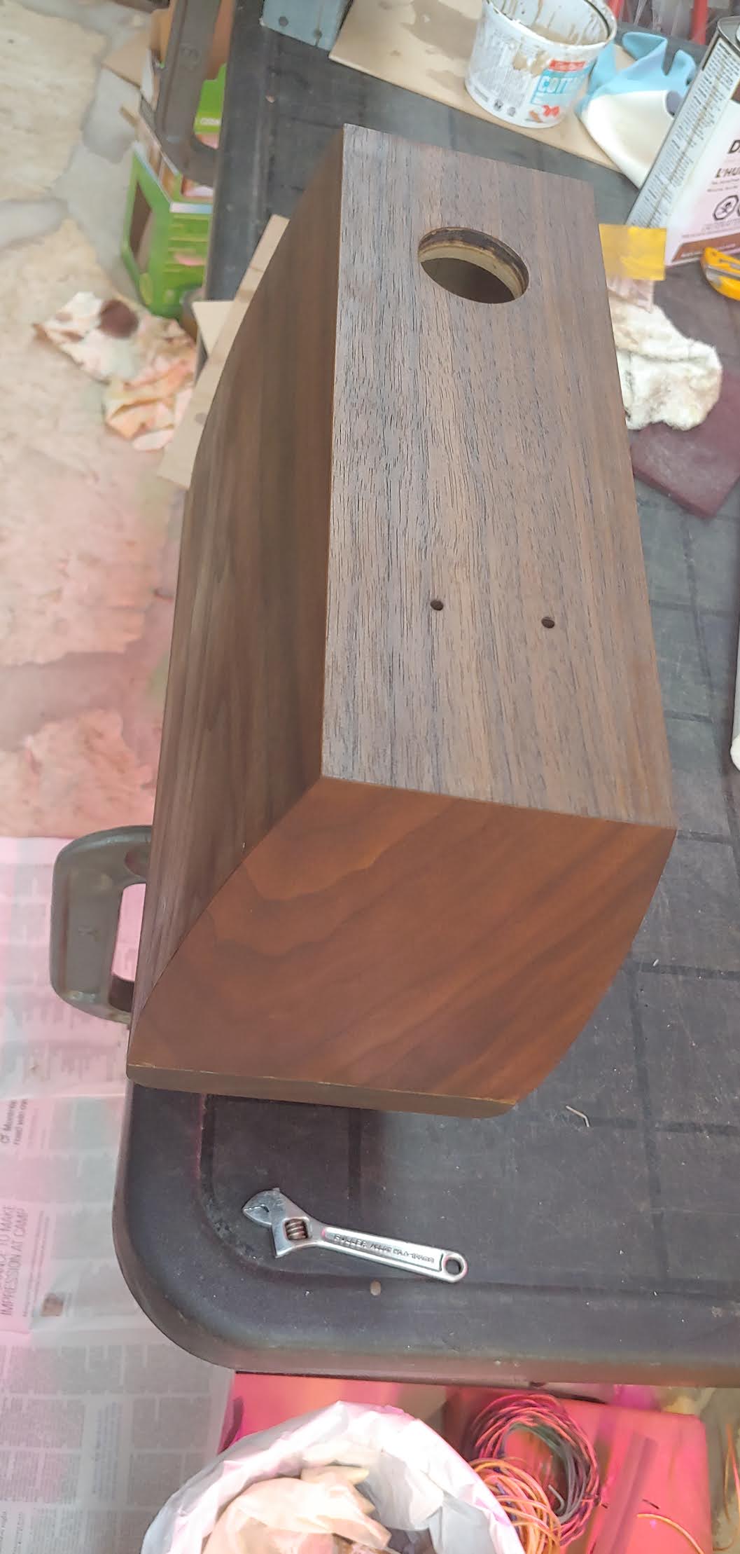

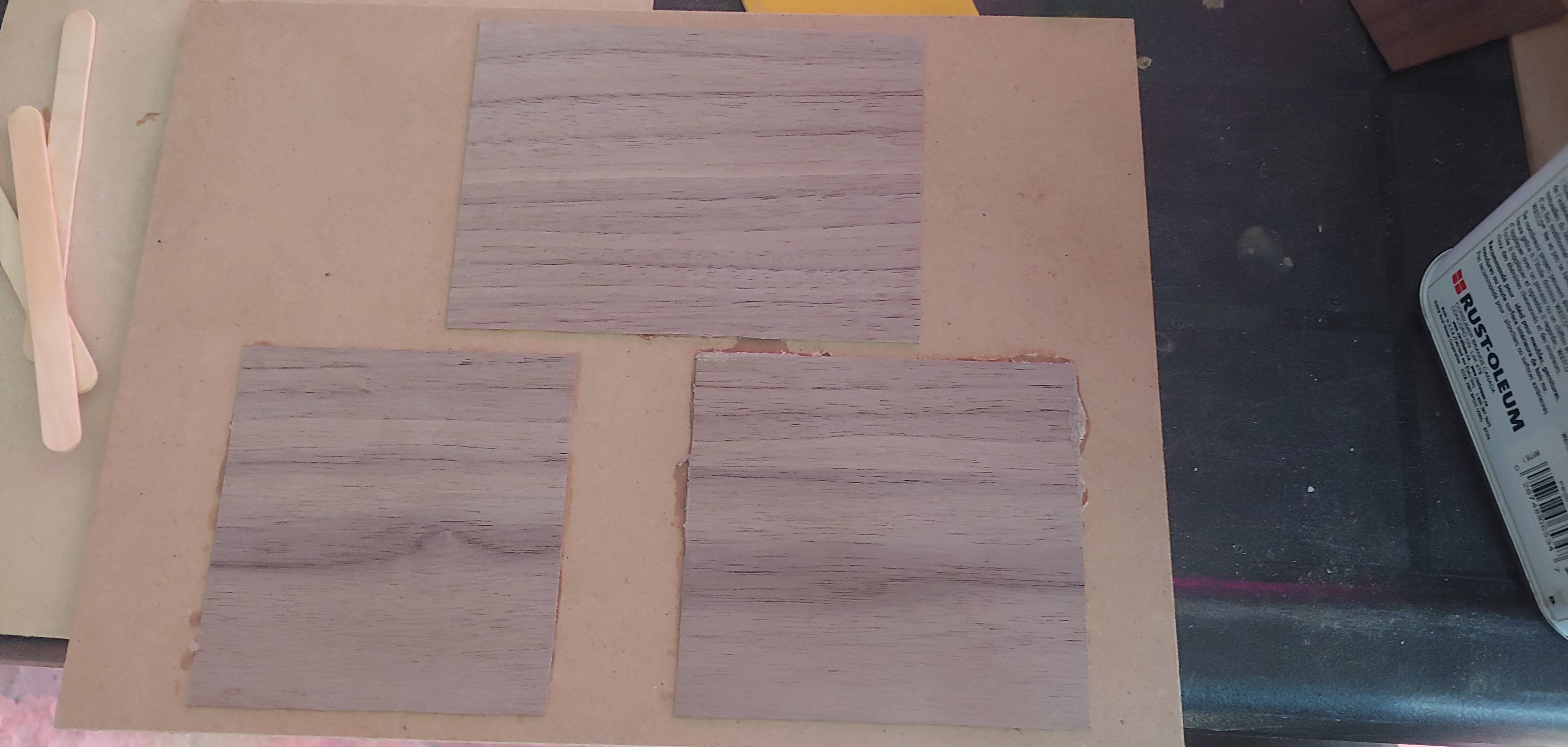

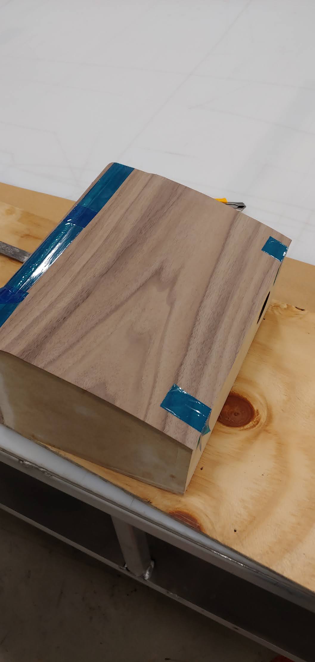

Veneering

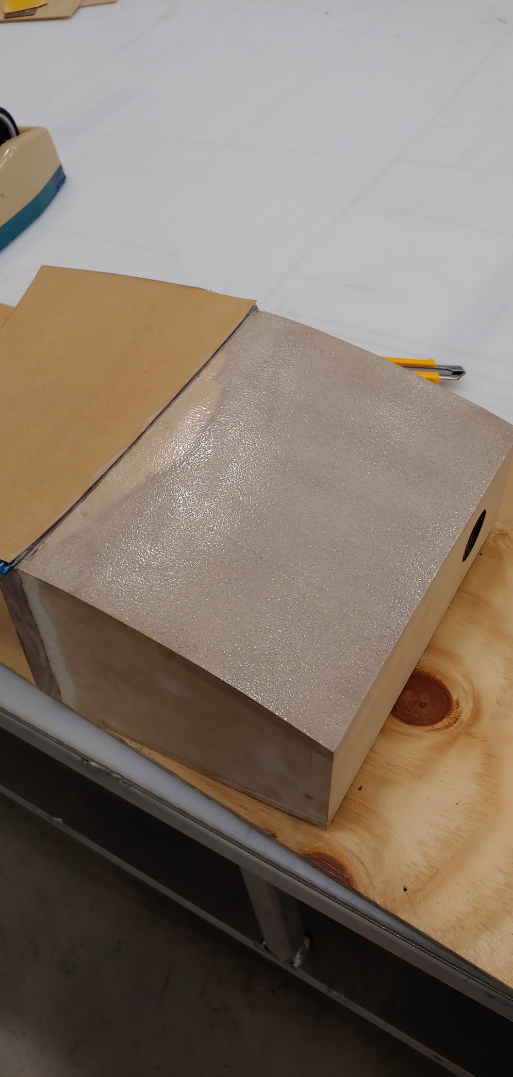

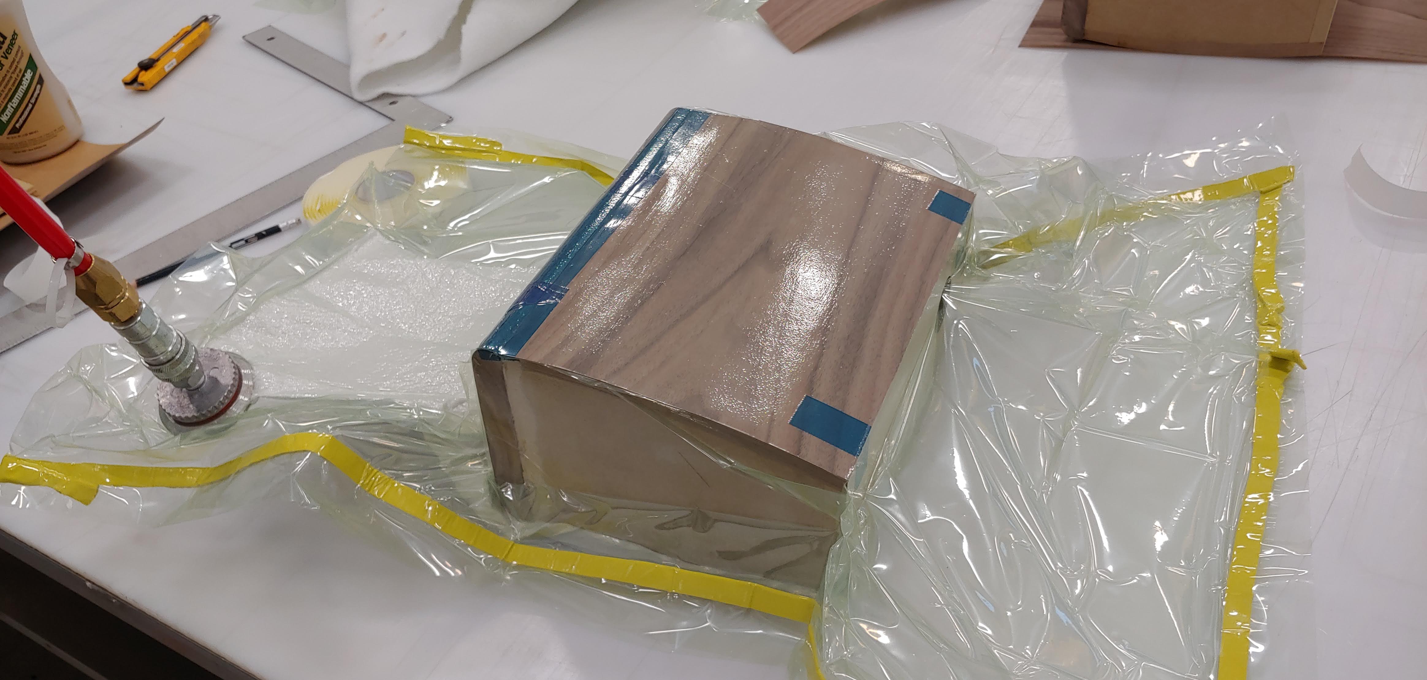

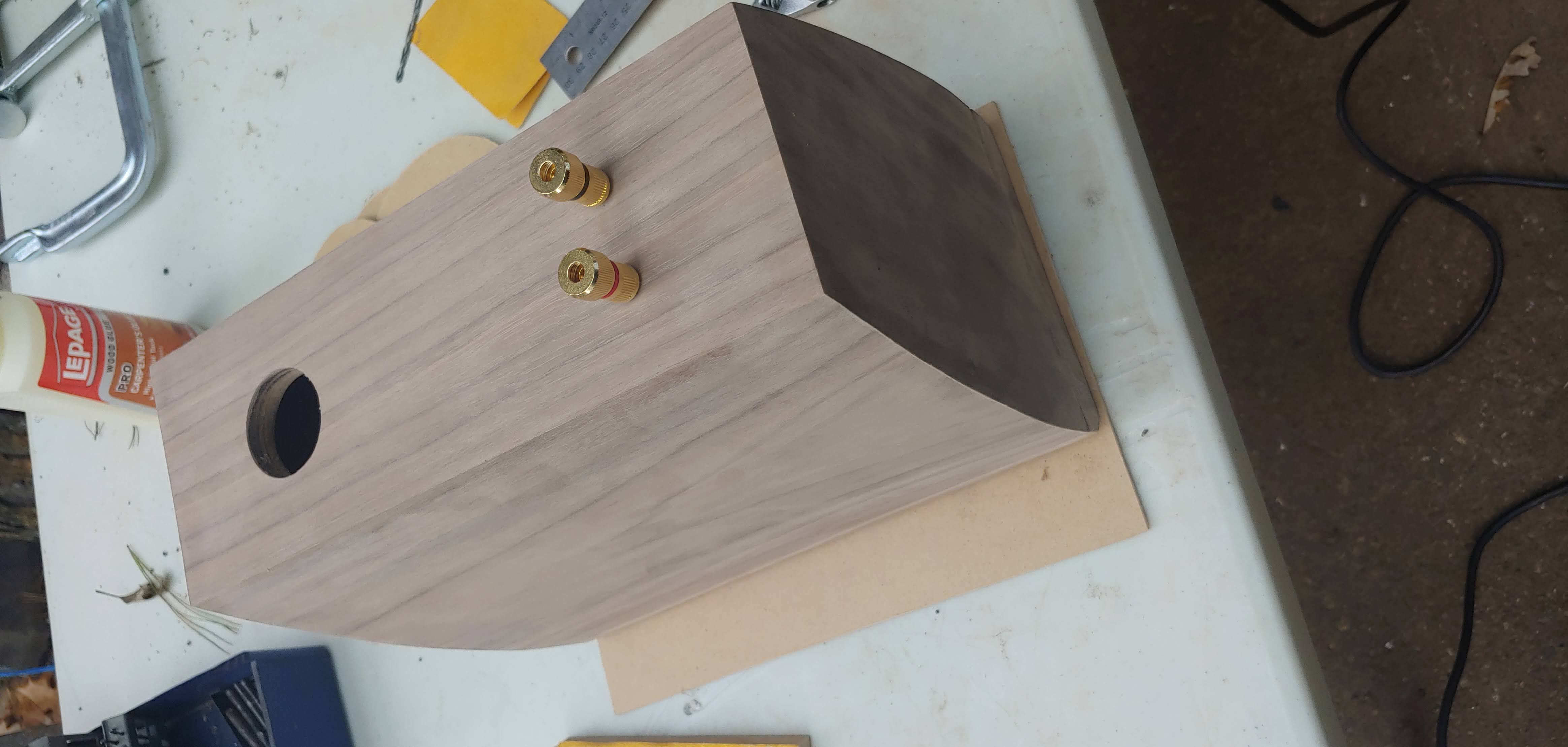

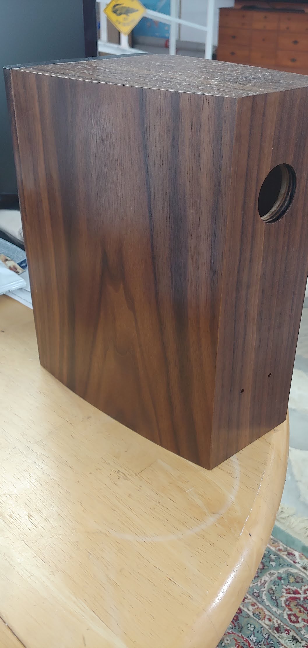

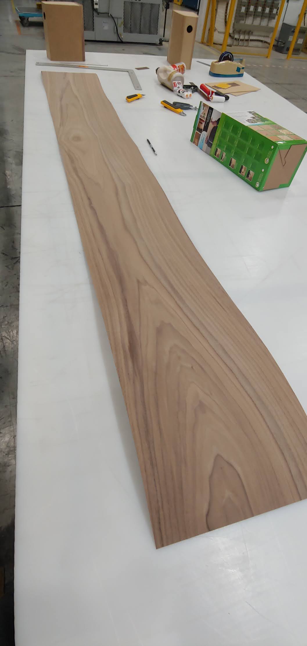

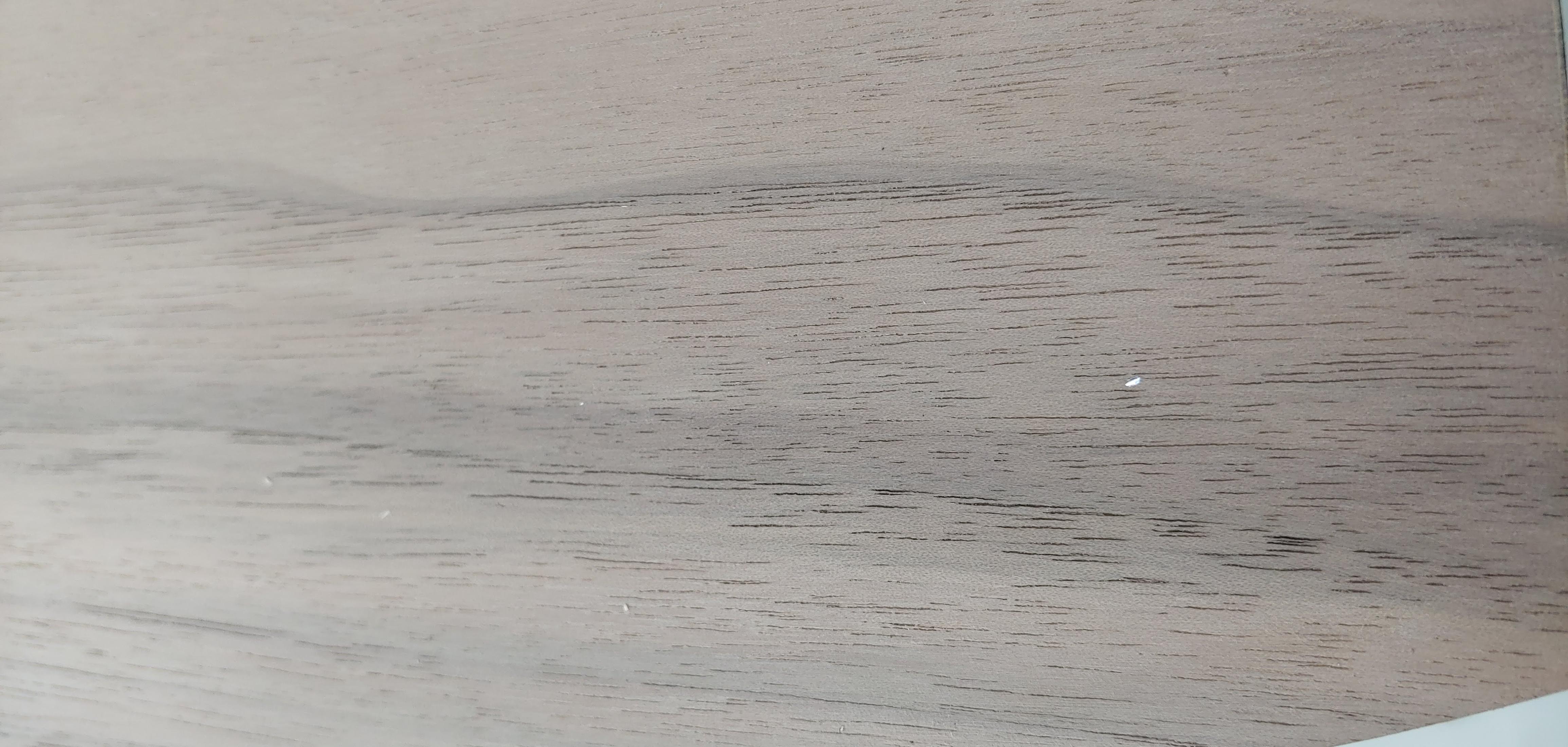

I then started the veneering process. This was a big question mark as to whether or not I can do a good job. I have not veneered myself before although I had helped with iron-on veneering in the past. Having access to vacuum bag hardware at work, I wanted to use Titebond's coldpress veneering glue and do it with vacuum. However, my experience with laminating the 1/8" panels taugth me that with glue things can sometimes shift slightly. Having no real room for error (once bagged and vacuumed, hard to see if everything is going right), I seriously considered trying the contact cement or iron-on methods. I spent maybe a whole day researching pros and cons until I bit the bullet and just decided to vacuum bag it. This ended up in my opinion, being a good call.

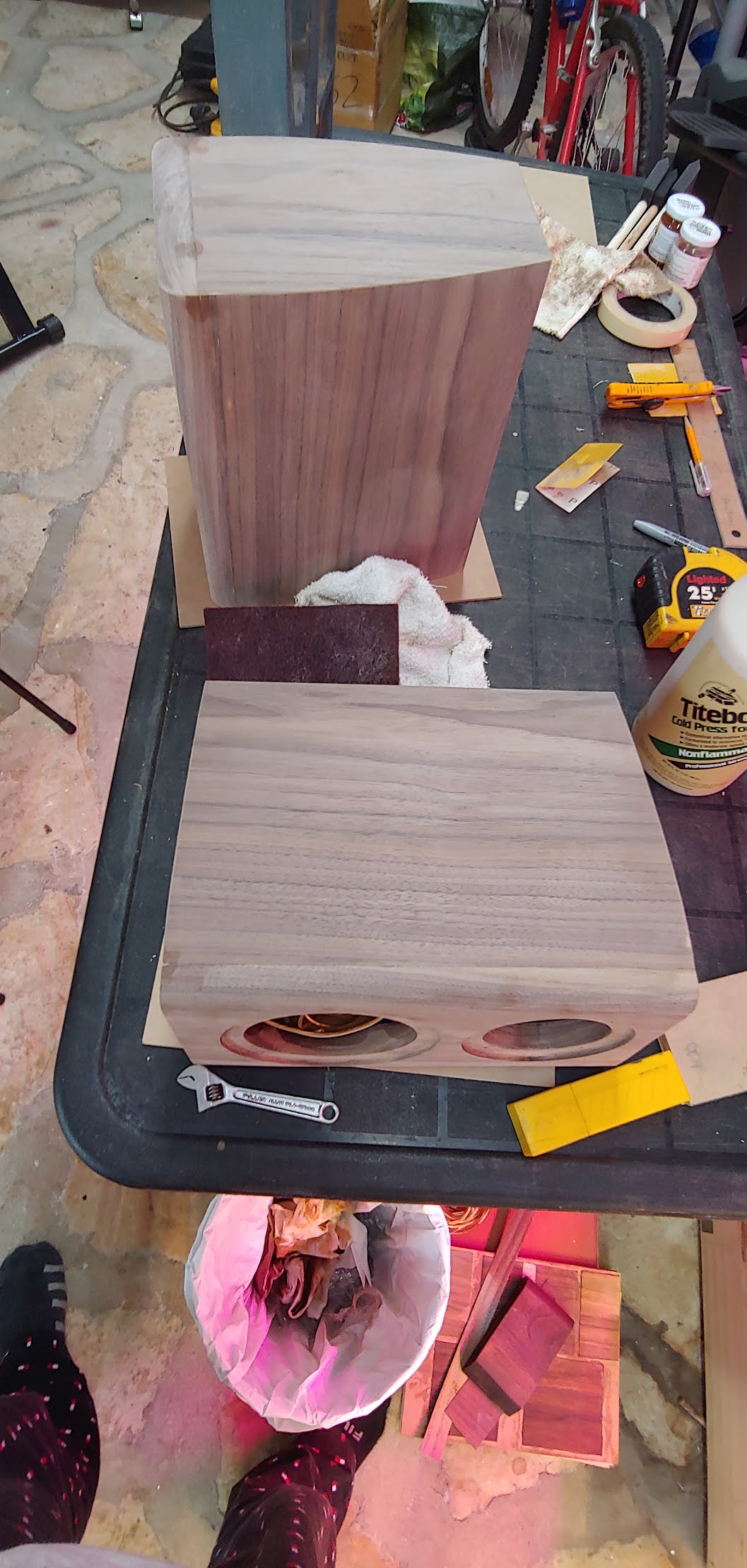

I started out by laying out my veneer and planning which parts I wanted where on the enclosures. This was a pretty satisfying experience making me want to veneer more project in the future.
Walnut Paper backed Veneer

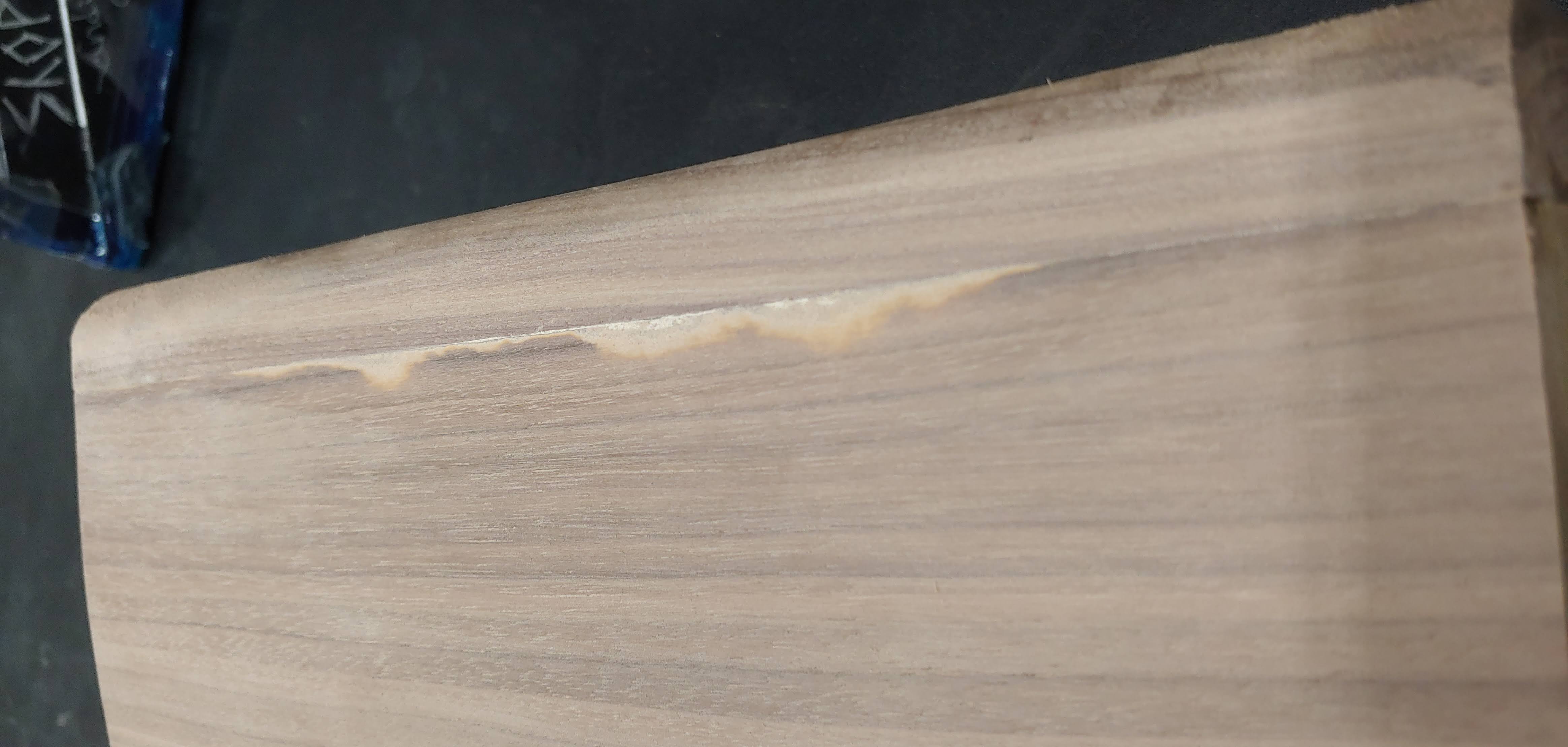

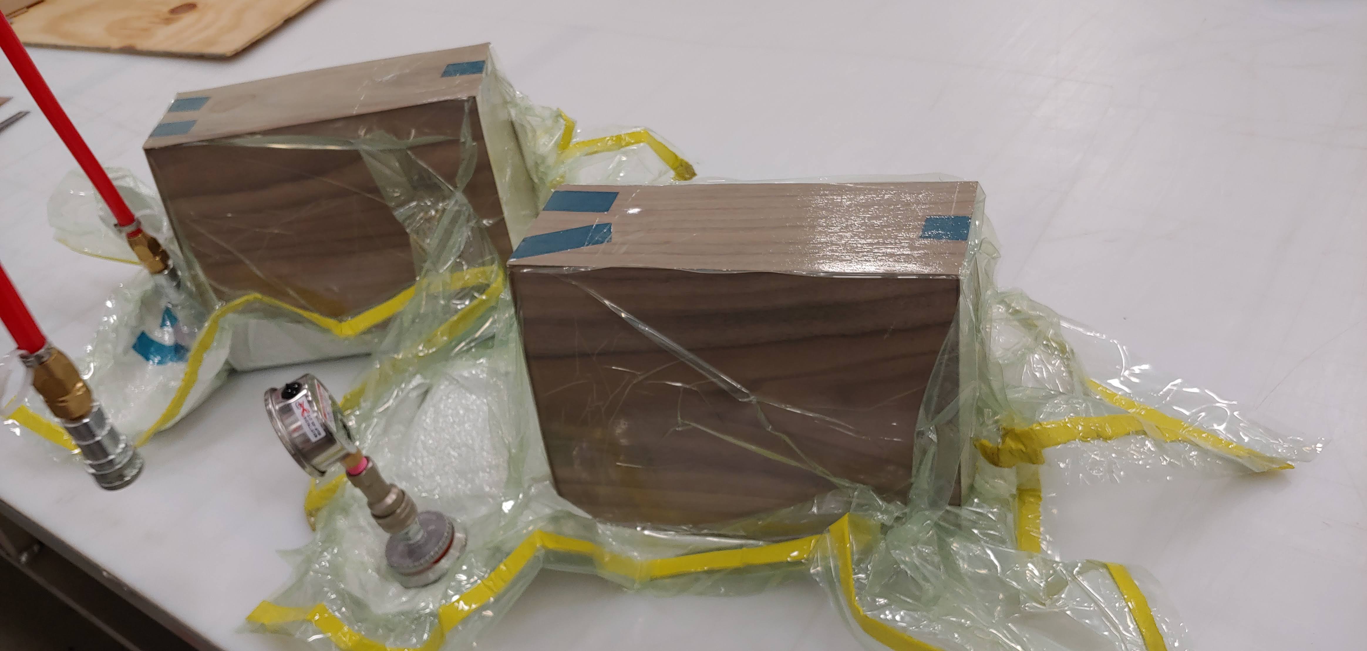

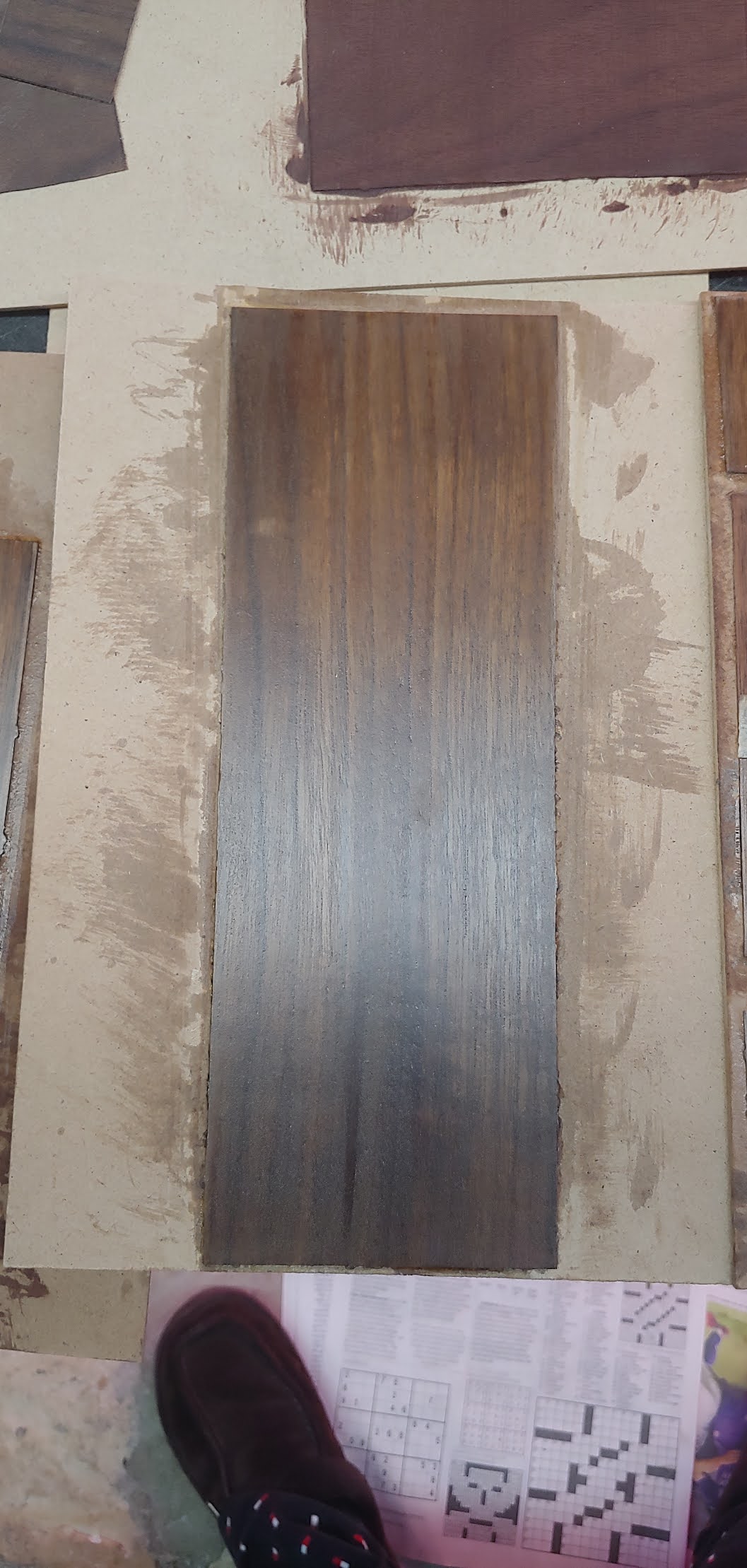

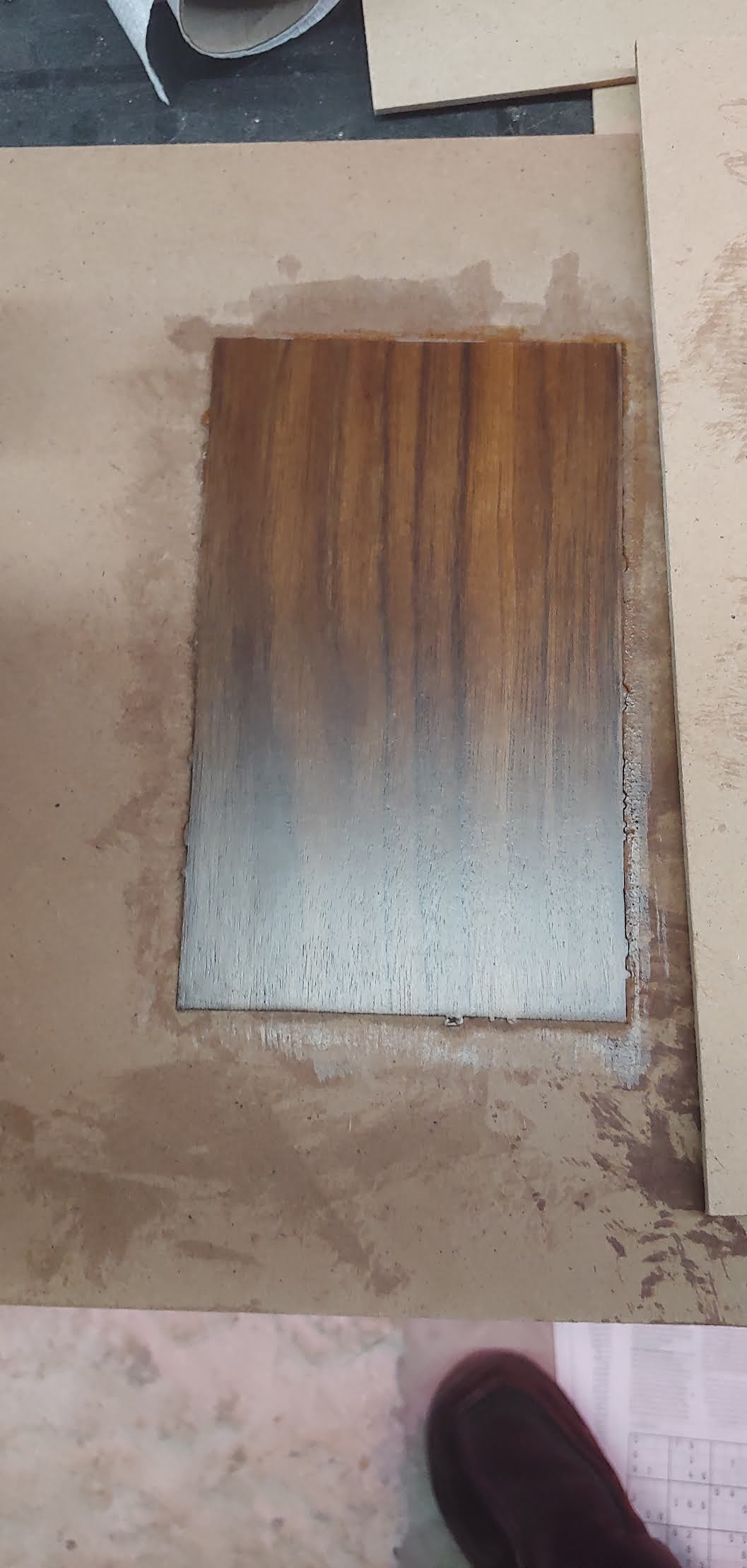

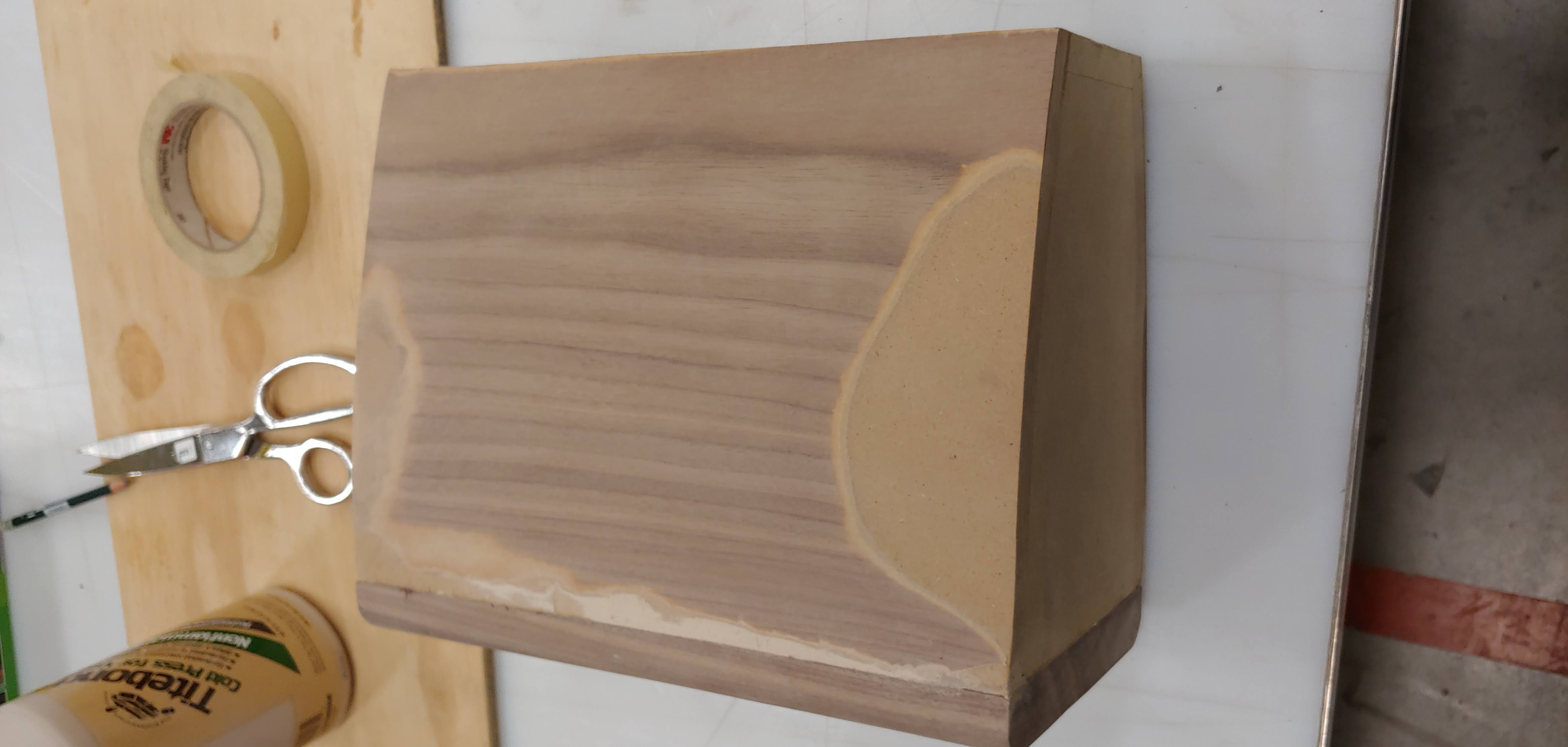

Being very wary at first of the vacuum method and the use of the cold press glue (especially since the website clarifies it is to be used only on FLAT surfaces...), I took my time with the first side placing tape to hold the veneer in the exact spot it needed to be. The gap betwen the veneer and the solid walnut (front baffle) was quite tricky as nothing was perfectly straight and square. Even trying to clean it with a chisel, there was still a bit of glue here and there making it a bit tricky.

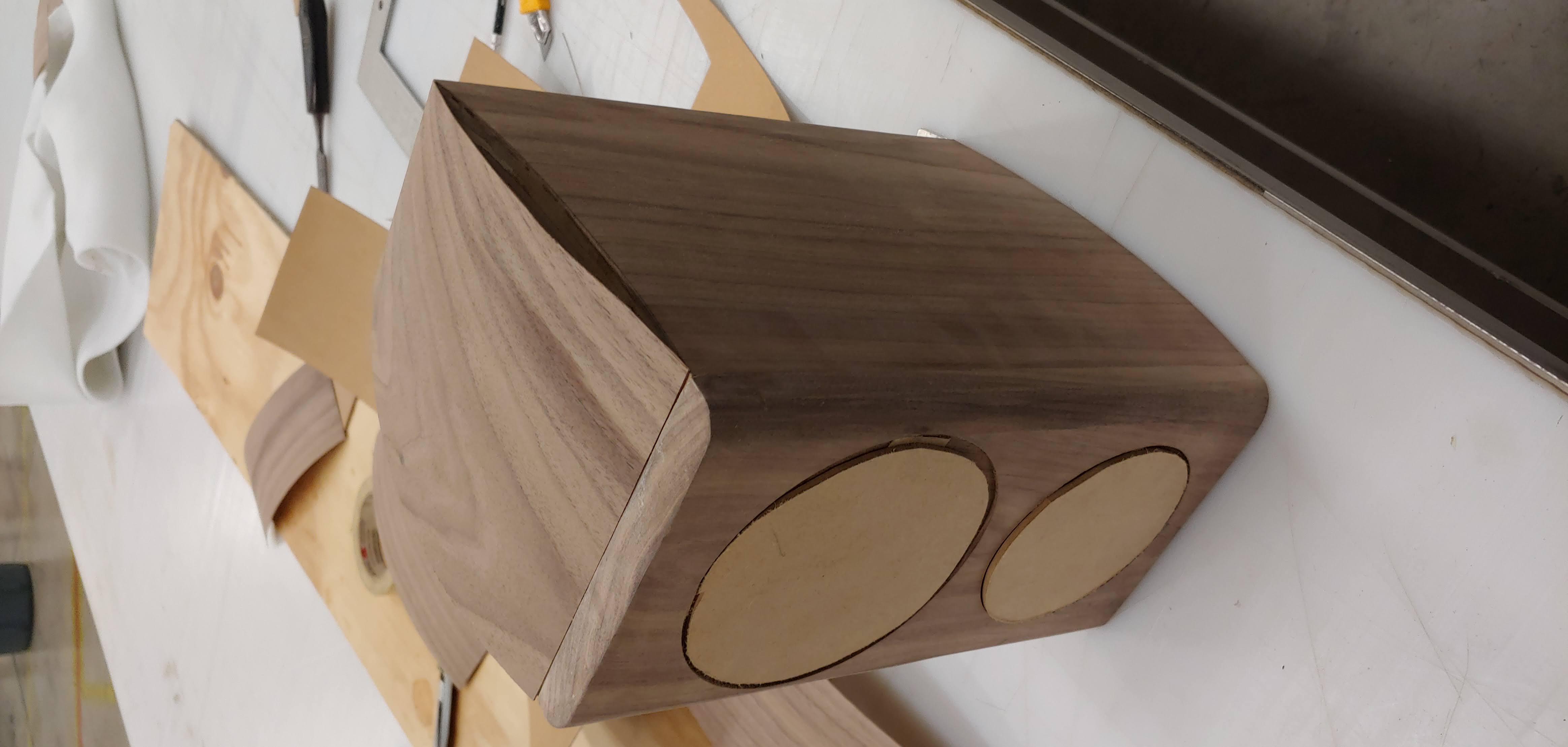

The shiny bag showed some unseen defects...

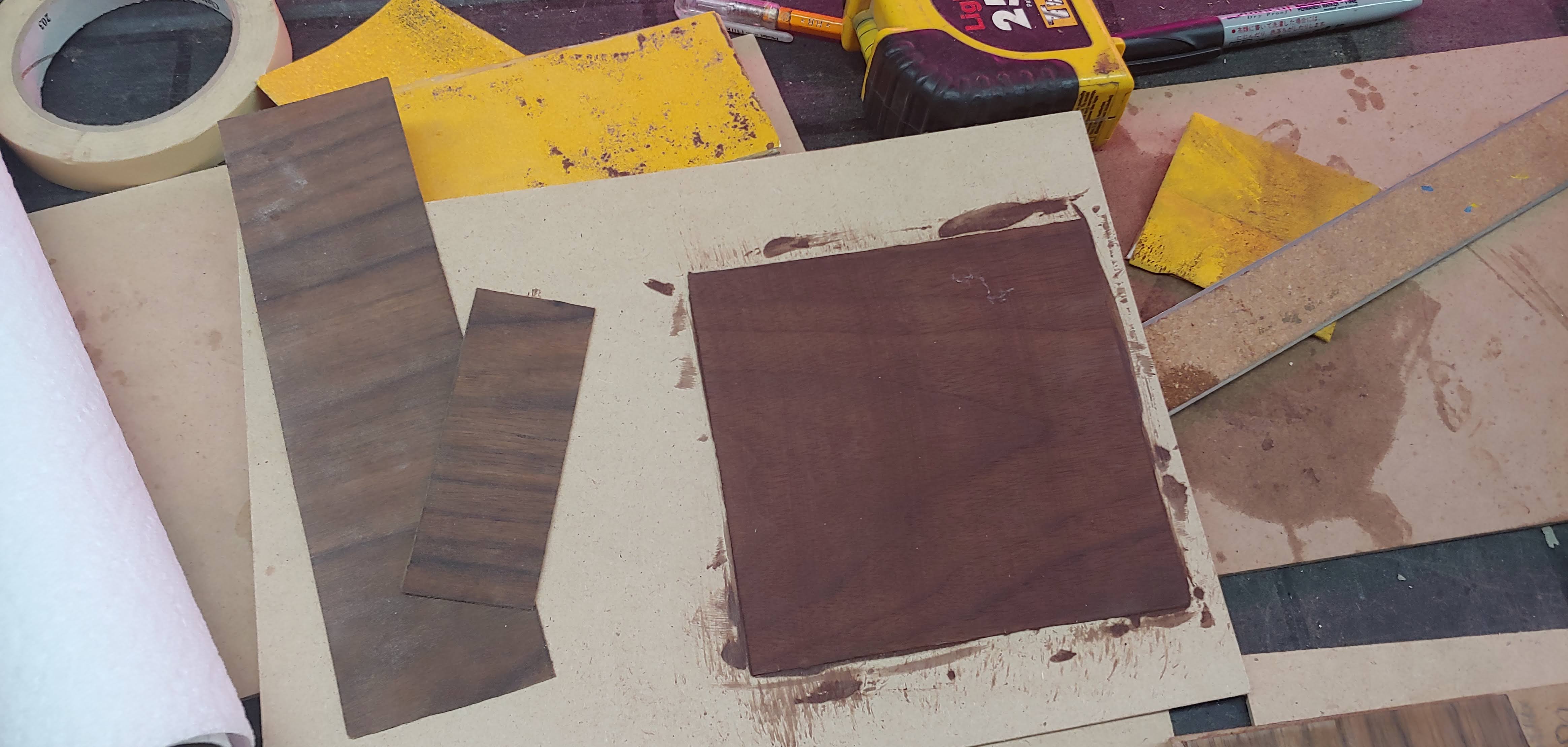

Then what I thought was me sanding off excess glue ended up being me sanding through the veneer..
Deeming this unacceptable I tried chiseling off the veneer and correcting the crazy curve.I re-veneered that side on top of the existing veneer. Not optimal, but hey there's a learning curve.
Everything else worked out much better than expected. There are many flaws, but only I could probably tell they are there.
Towards finishing touches
After veneering all afternoon yesterday, I did all the rest of the finishing before danish oil today.
I trimmed off excess veneer and sanded the boxes down. Made holes for the ports, connectors, drivers. Took alot of care to not mess anything up. Made sanding blocks of various grit to do so. This was by far my most rewarding day as very little went wrong (unlike everything else I have done up to now!).
I can spent a bit more time on the sanding IMO before danish oil. I have started making sample tests. I am still unsure as to how to "seal" or topcoat after the danish oil. I do not want to use a varnish and hoping to use what's available at the hardware store. I bought a hard natural oil sealer at the specialty wood store, but that may not cut it. Maybe it will... I just have nothing to compare it to for now.
One question for the savvy:
As I was sanding the walnut I thought the coarse grain was getting much nicer. When cleaning the wood I realized it is because the pores were just getting clogged by dust making it feel "smoother". Here is a picture of the wood after 180 grit. Is this normal? Or am I doing a bad job at sanding it?
fouchagalaga,
That's a lot of hard work you have put in, and the results are impressive.
Good luck with the final part of applying a nice oil finish!
Look forward to pics of the finished speakers, and then your listening impressions in due time.

Oiling Process
Hello all,
I wanted to provide an update on the cabinets. I will try to make a long story short as there is over a month of work tat I have done.
This is my first time finishing wooden cabinets and have read for many weeks on different wood grain structures, filling of the grain (or not), the available finishes, durability, and have done a lot of testing to better understand the small details of what I have researched.
I originally wanted to do a simple danish oil using Watco dark walnut in a few coats then cover with a polyurethane topcoat. I have since changed strategy from the various tests I have done.
I ended up doing one coat of said danish oil to provide better color. Then I covered using 4 coats of a hard natural oil sealer that was bought at a premium price (over 60$ for 750ml 0.0). Tis sealer provided a much better "pop" of the wood while softening its color a bit from the danish oil. It is hard to explain, but bottom line is I liked it. I am now waiting four weeks for it to properly cure and to test the "hardness" of the oil surface. I am at the 2.5 weeks point and will most likely cover using a water based polyurethane topcoat.
I started by making many samples using the left over veneer and the scrap HDF panels:
Cabinets prepared for finishing:
Made some holders to be able to do the entire thing at once:
The oil took few coats to really get that layer. I will be scuffing the surface before I put on polyurethane, but will still wait few more weeks.
