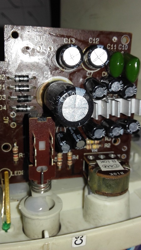

I originally thought of connecting an external power supply to supply dc current to the amplifier circuit. Like it says in the article I quoted, this is for safety. I did not feel safe allowing 220 Volts AC current into the unit I was going to be working on. On opening up the unit, however, I saw that the transformer was connected to the board and marked "AC" : there were four electronic components just next to the AC input : I guessed they were diodes to rectify the AC current to DC.
Yap! The secondary ( winding) of the transformer provides the necessary low voltage ISOLATED from the mains ( GAlvanic isolation )

Here is a picture of the board. If I can find the output from the rectifiers then I can connect a DC adapter to this. Otherwise stick with the original AC input and enclosure.

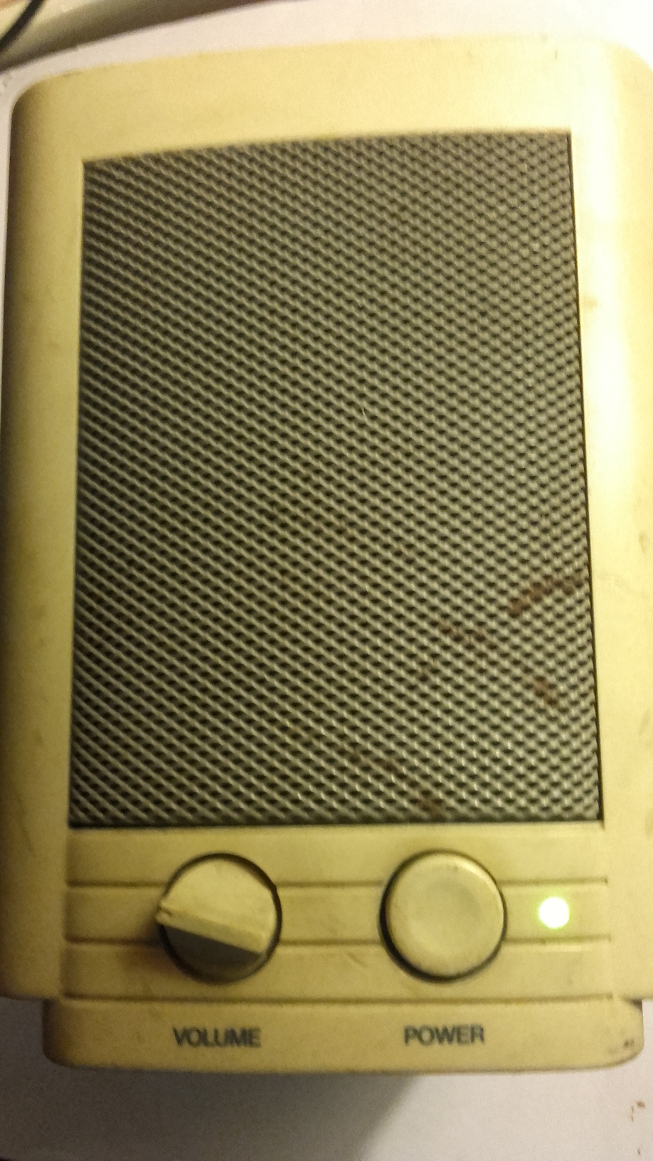

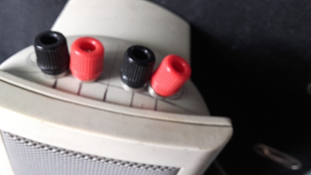

Another attempt to locate the soldering points for an external DC 12 volt power supply instead of the AC transformer power was not successful. There is a large capacitor near the set of 4 diodes and I am not sure what is connected to what. Better leave it as it is, and connect two speaker output terminals to the top of the box. Paint the box and then I am done. Next on to the speakers.
Comlpleted PC speaker to amplifier conversion
Connected speaker outs to speaker posts on the case. Works fine. 70 dBA SPL at 1 metre.
How does it sound? Well with my speakers on another thread, I am getting a clear output using only the two 6" woofers used as open baffle.
Already it is better than any of the mini stereo systems on the market.

What I usually do is disassemble the unit so I can get a voltage reading at the filter cap. (Unit filleted open and plugged into the A.C. source as in normal operation) That gives me an idea of what D.C voltage I can apply..
If the unit has a full wave diode bridge, (Like the one in your example) D.C. can be applied at the connections of the original transformer with no regard to polarity. The full wave bridge make it impossible to connect the D.C. incorrectly..
Update: It works! A 9 volt battery powers the speakers, and it does not matter how it is connected. It also works off 3 volts. Burned out a speaker running this way - could there be a connection? (no pun intended).
