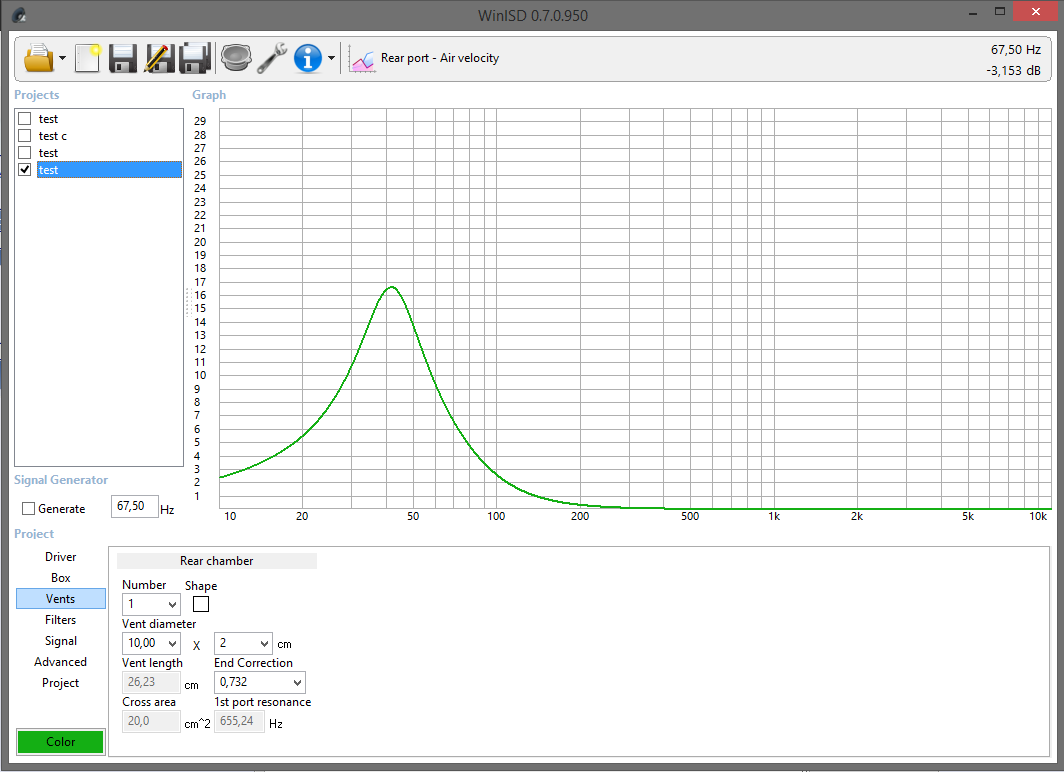

The volume excluding the port is 4.56L and I got the box tune at 42hz and gives a 1cmx42cm port at the bottom.
I am not sure if i have done everything correctly. Is a square tower a good for speaker box? The goal is to built a good sounding desktop speaker with good bass output. I know it's impossible to achieve punchy bass with a 4" fullrange driver but at least it should not sound thin without bass at all. Or are there better driver for this task beside the CHR-70?
The box is to small, i would not put this driver in a vented box below 8L you also tune it way to low for this driver, 50Hz is the lowest i would try (or it has to be a TL). And a small box will always be a compromise. This is the best i could get out of it (on the published specs) with this driver and your goals and compromises you want to take...
And no, a square tower is never a good id, it makes that one frequency wil resonate more. So make it deeper or wider.
PS: port size is set so the velocity is below 17 at full power (20w) to avoid port noise.

LOL. I got overly optimistic about the superbass. I check the Helium and the bass is output looks similar. I did play around with a round port(2cm x 6cm long) tune to 50 hz.
Is this response any better? Let say its for nearfield where the speaker will be about 2 ft from the ear. What I really want is is clear detail sound that is balanced with a decent bass. I am not expecting chest pounding or heavy bass. I choose the CHR-70 because I saw many good reviews in much larger build. Will the CHR-70 bring much improvement from those cheap PC speakers in $100 range?

You try to tune this speaker below it's possibilities, and it will sound bad. I made that mistake also in the past. This driver in this box will sound boomy because the box is too small and you tune it to low for that box. What you try to do with this driver is impossible. Then better follow Scottmoose's advice and try to find that 6.2 driver that is more fit for this kind of super small ported speakers.
I looked at this and the vent looks too long, but the sims look OK. The high ratio vent will reduce the peaking just before roll-off.
Except for the strange vent length, it is much the same volume as the mCHR-Ken (4.7 litre), but the tunign number (IIRC is lower).

Hi Dave. After reading somewhere that long port would induce noise and losses, I redesign the cabinet with round port.
Like waxx said, the design will sound boomy because its too small and I tune it to low for that box.
