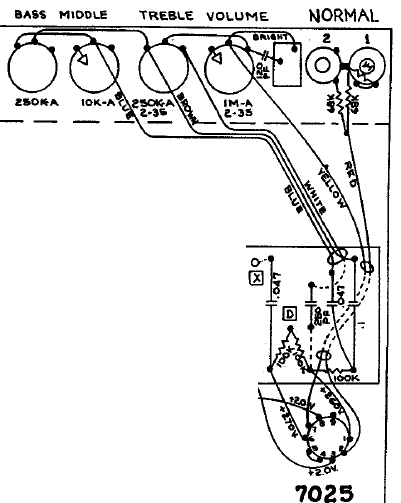

http://www.prowessamplifiers.com/schematics/fender/twin_reverb_ab763_layout.pdf
clone only the normal channel.

What is that, seven turrets? Hardly worth making a PCB, let alone the phenolic/epoxy-tainted sound of PCBs.clone only the normal channel.
EDIT: I see I snipped a couple cathode networks. Ten turrets. 10 copper tacks in cigar-box wood.

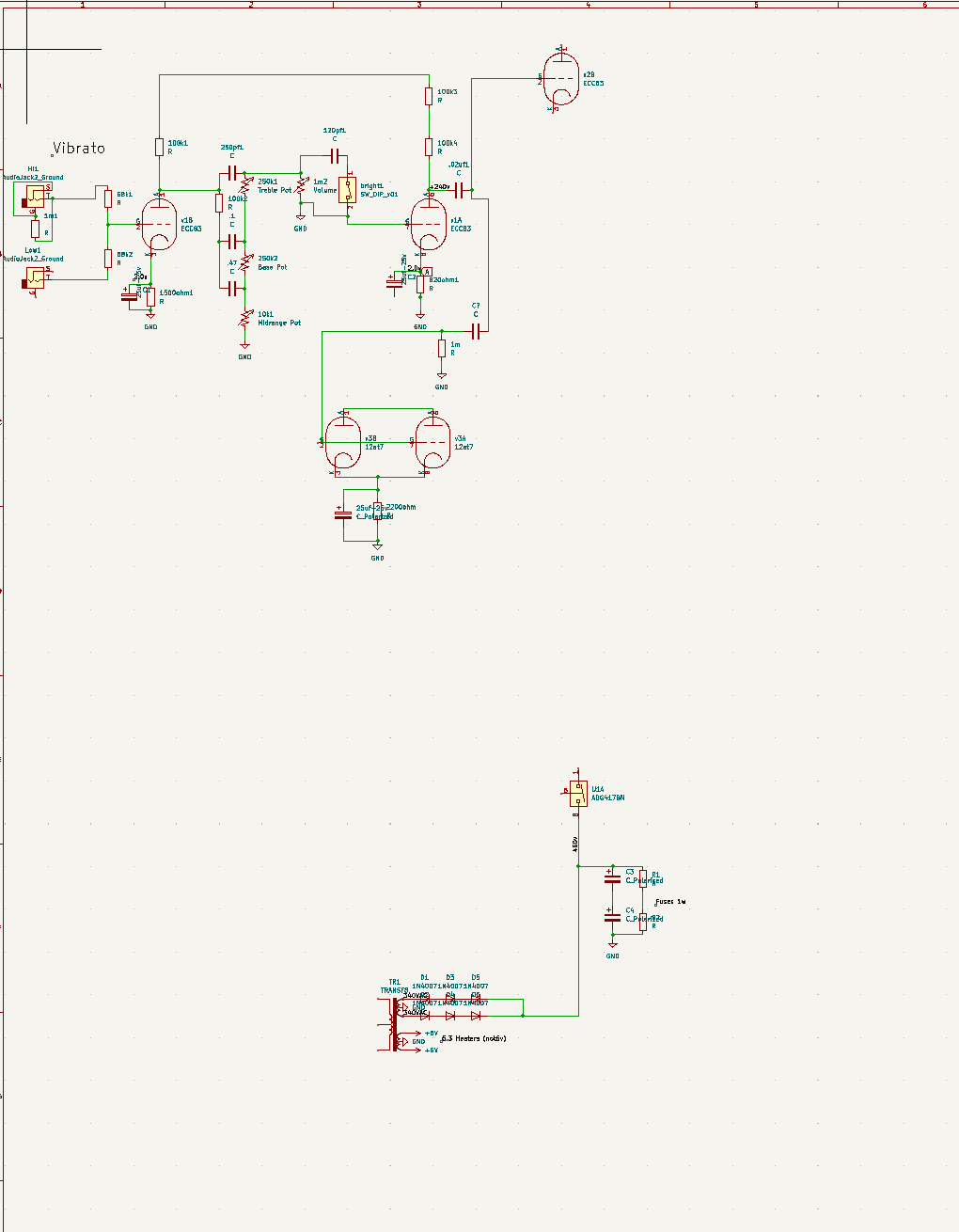

Thanks for the rec's. I started making the schematic pre mods. But I cannot find the correct transformer layouts. I guess i can worry about power later. But when I ran a quick test I guess according to the schematic checker, i dont even have any power here. HA. Is there a way to layout the actual power and have the voltages change within the circuit on the schematic or does everything have to be written out? Thanks!

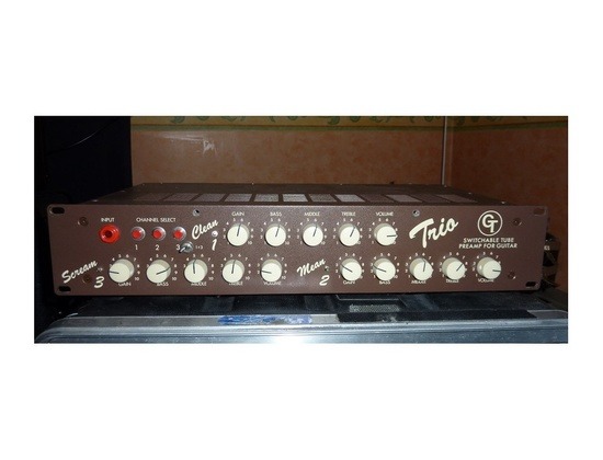

In the early 1990's until his death Garcia used one of these Groove Tubes Trio's which was modified but still through his McIntosh and JBL speakers!
Treble and volume pots connected wrong.I guess according to the schematic checker
Voltages? Are you doing PCB layout or circuit design? While the both can be found together in some (usually very expensive) software, I suspect if you copy Leo's values the voltages will find themselves.
Neither could Alembic 😉 , it´s hard to wind hair thin wire (actually thinner, go figure) for thousands of turns for high voltages without going veeeeryyyy slow and even more, still having lots of breakages. A true PITA.
Any transformer winder around here will confirm that.
But look at what they did: used a voltage doubler, so half the turns, twice the wire section ... a win-win situation.
Start searching for a similar transformer yourself.
In fact a simple cheap 1:1 120V-120V isolation transformer will take care of he HV rails, you still need 6.3V winding: if lucky in the same HV transformer as shown in schematic, if not care of a second 6.3V filament transformer ... easy peasy.

His post #10 schematic is basically same as what he originally described on post #1
