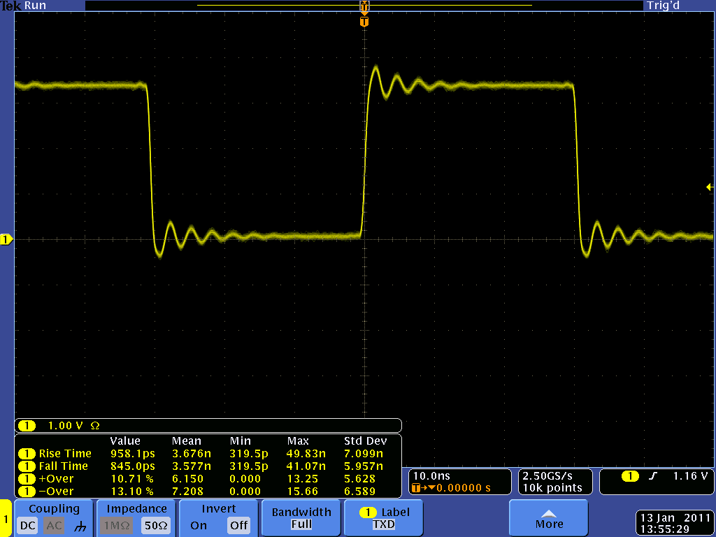

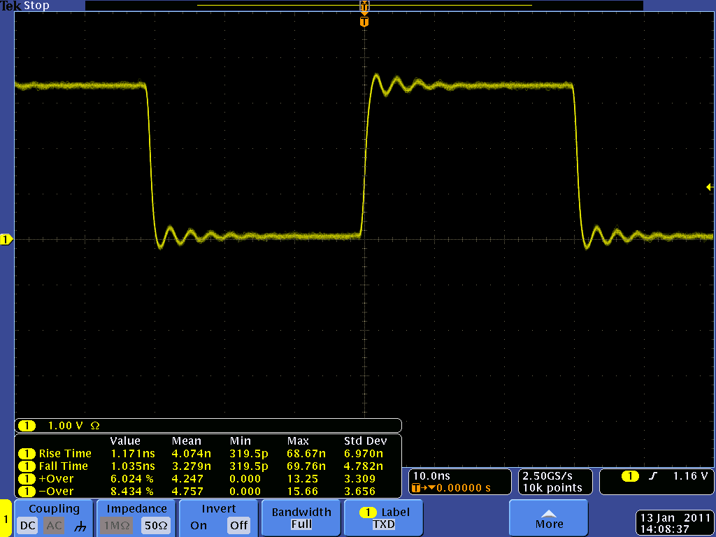

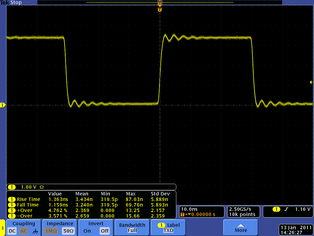

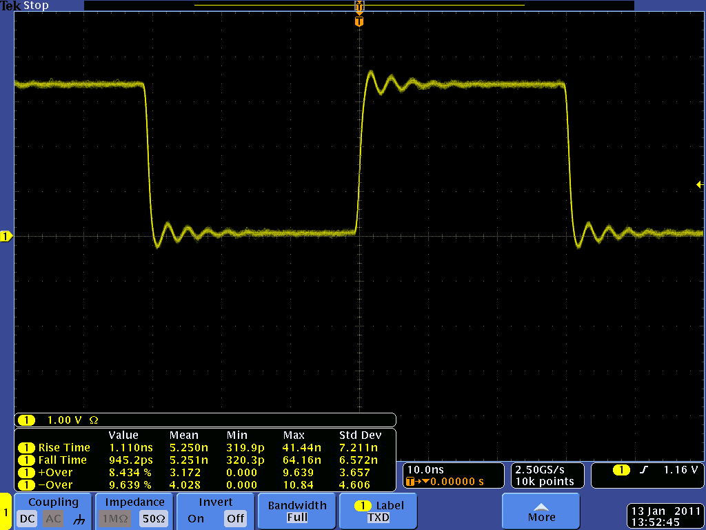

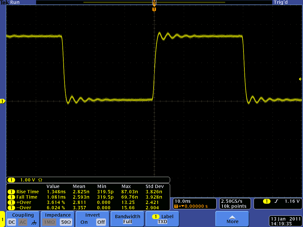

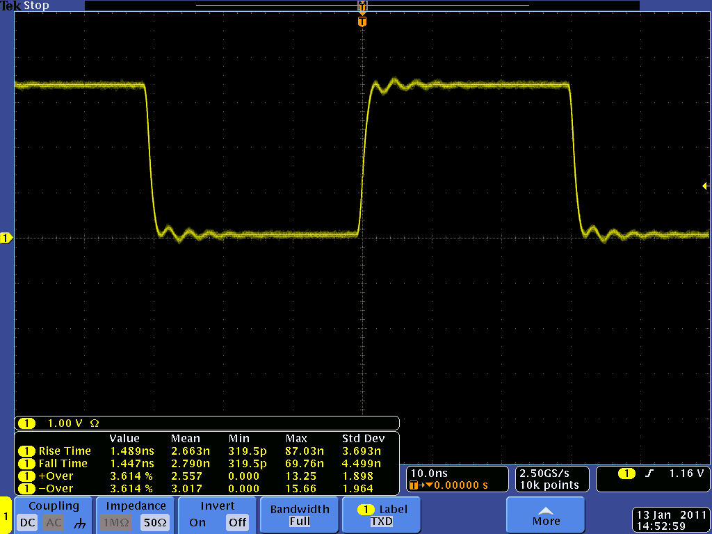

A 47 Ohm is not always the best choice.. It depends on the layout, the drive strength of the driving gate, the ability of the receiving gate to sink current etc. I would again recommend providing some further links for reading....
Real world examples...

I agree, but 47 ohm is a good starting point if you don't do any board optimization. But if you want to optimize the damping resistor, it should be tuned with respect to driver impedance, the clock signal impedance etc. As with any subject, its possible to dig deeper into further details and optimization.
Nothing is like real world examples!
My point in the blog is to adress some critical design issues that are simple to solve. And also to show the effectiveness by relevant, simulation results. In most cases simple solutions and simple models are good enough if implemented correctly.
