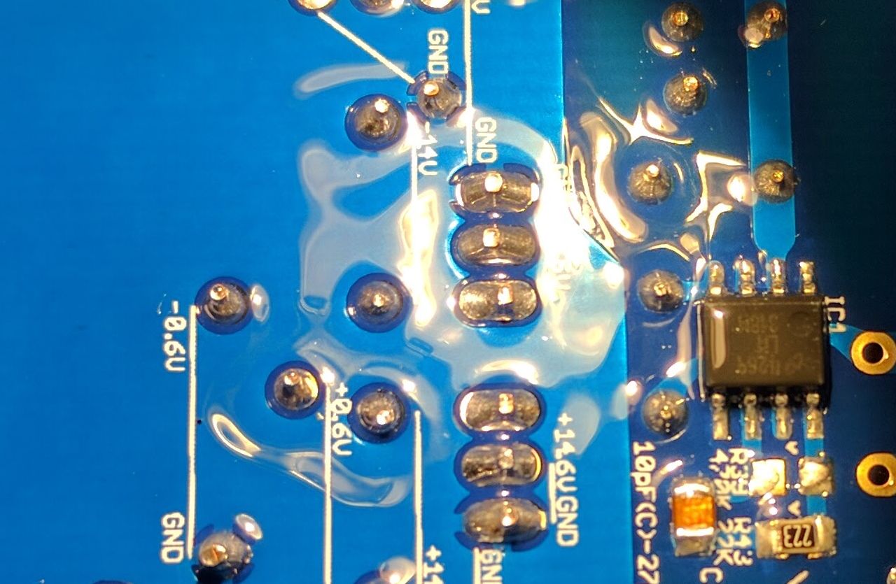

I always use this: https://www.conrad.nl/nl/p/kontakt-...de-en-beschermende-coating-200-ml-884197.html
Picture is of my myref fremen build.
Well many thanks important question: does it allow normal desoldering and soldering after application without problems if there are components to be replaced after some time (weeks, months, years) or does the paint tend to boil, cloud over or other problems with the heat of the soldering?

Well what is normal. It's not pretty when you desolder and resolder. You'll just have to clean it up. I usually just desolder (only once or twice ever) without removing it first. Then just scrape/clean...en recoat. Never as pretty as when you don't have to disturb it.Well many thanks important question: does it allow normal desoldering and soldering after application without problems if there are components to be replaced after some time (weeks, months, years) or does the paint tend to boil, cloud over or other problems with the heat of the soldering?
