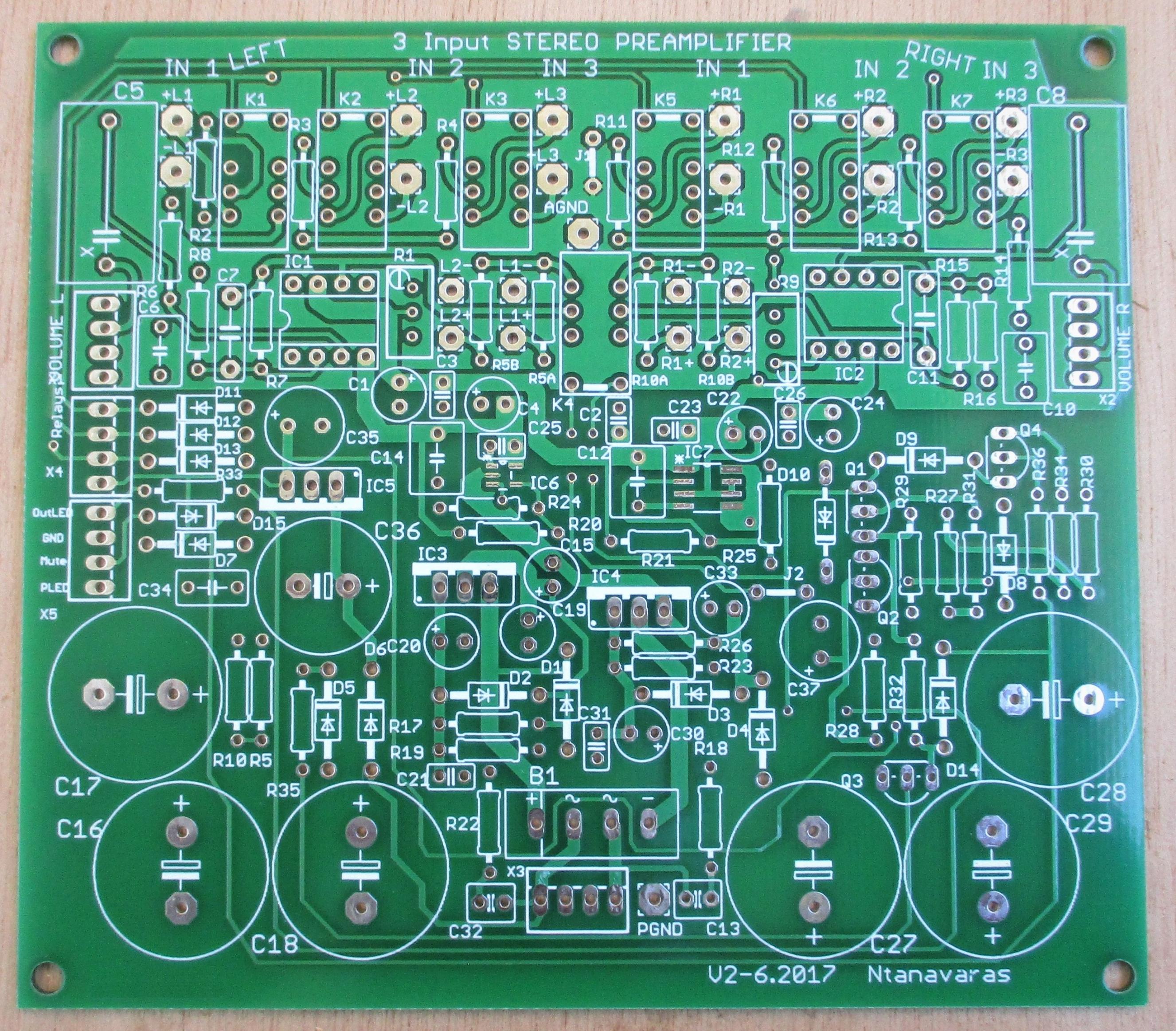

I have a few PCBs (as shown in photo) for the construction of a stereo Line preamplifier as was presented in my article in Audioxpress January 2019.
The preamplifier is based on OPA627 and has three unbalanced stereo inputs and two unbalanced stereo outputs.
Due to copy rights I cannot post the article here.
If someone has access to the article and want to build it, the price for each PCB is 28 Euros (shipping is included).

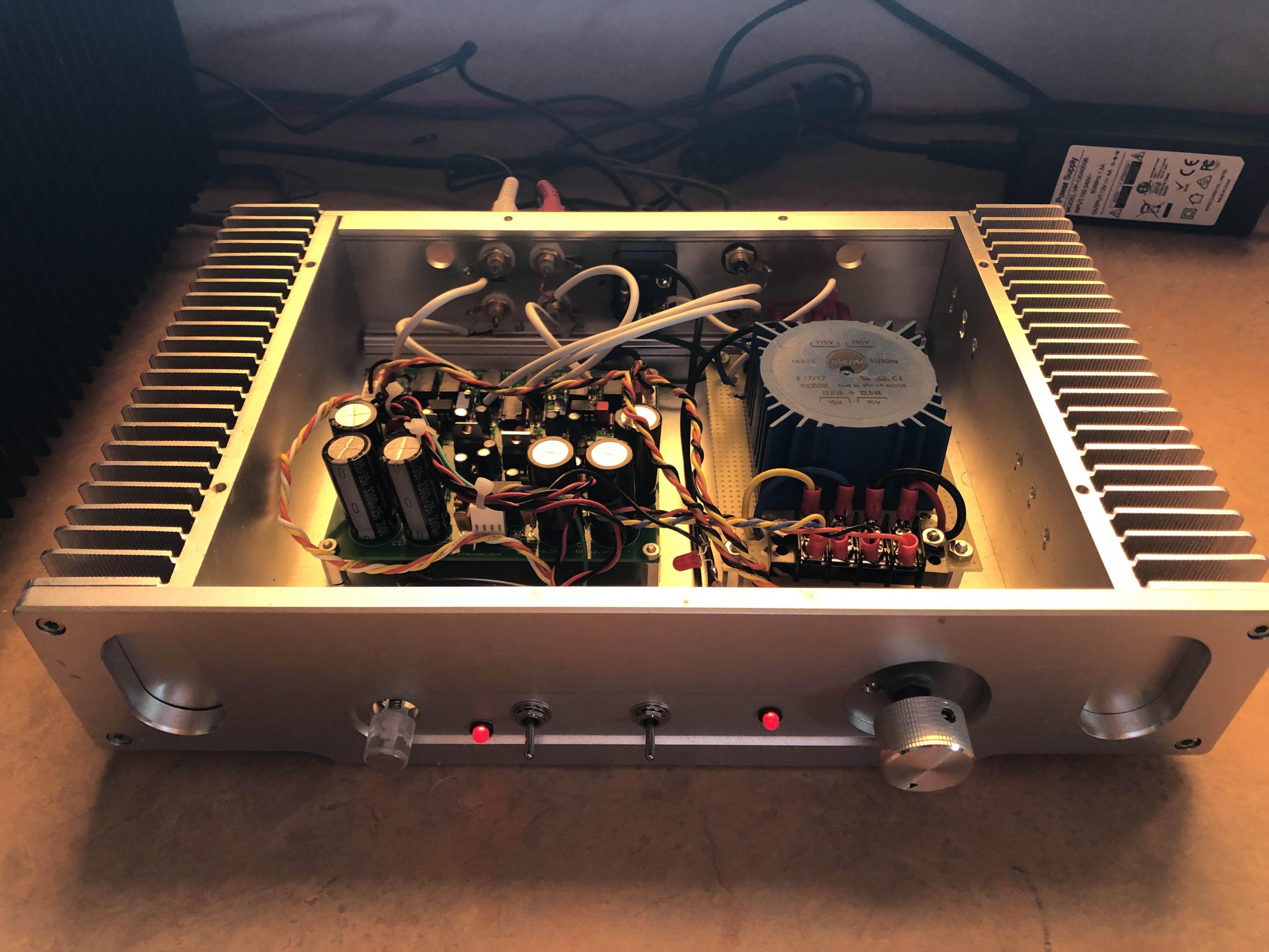

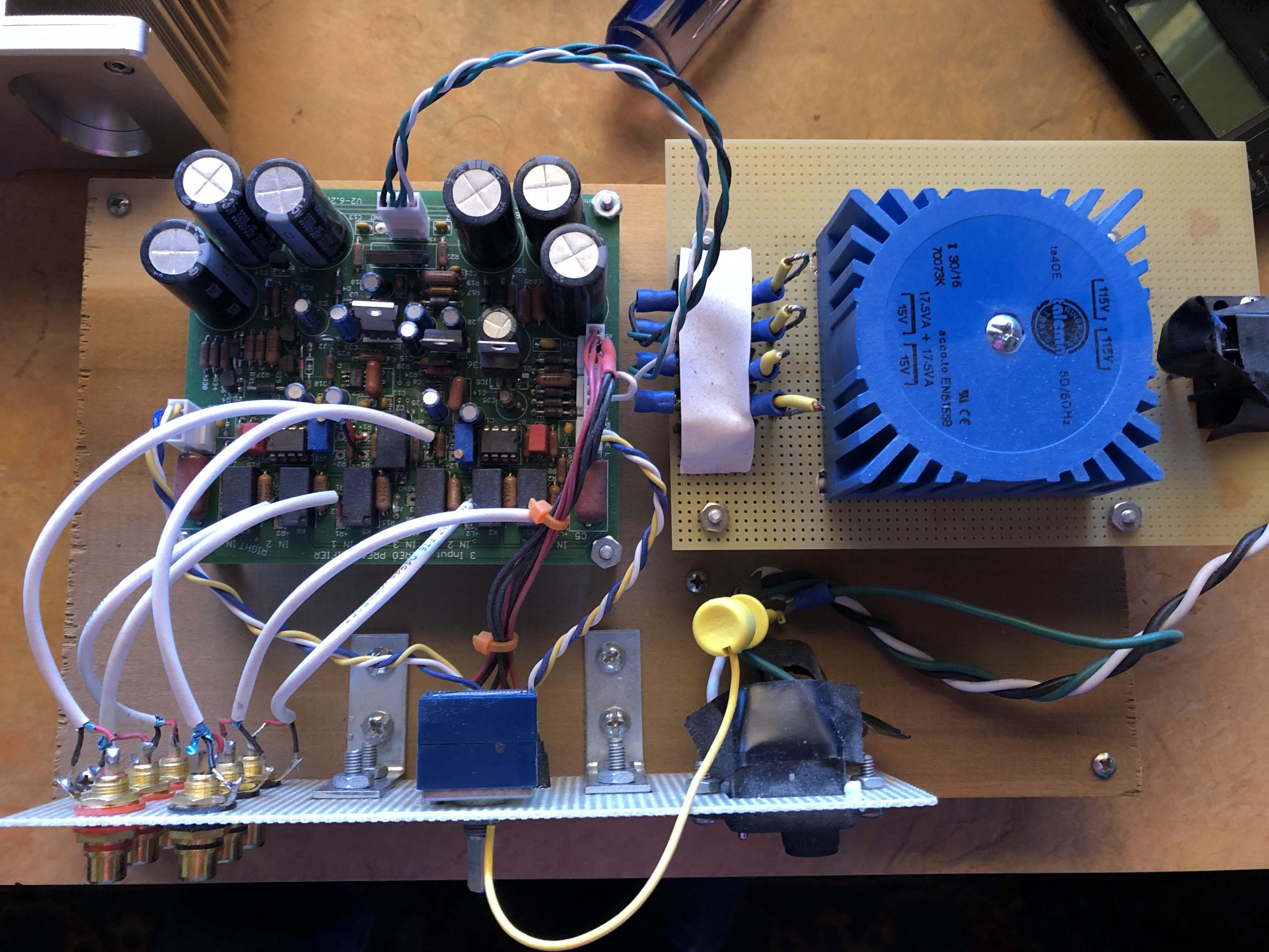

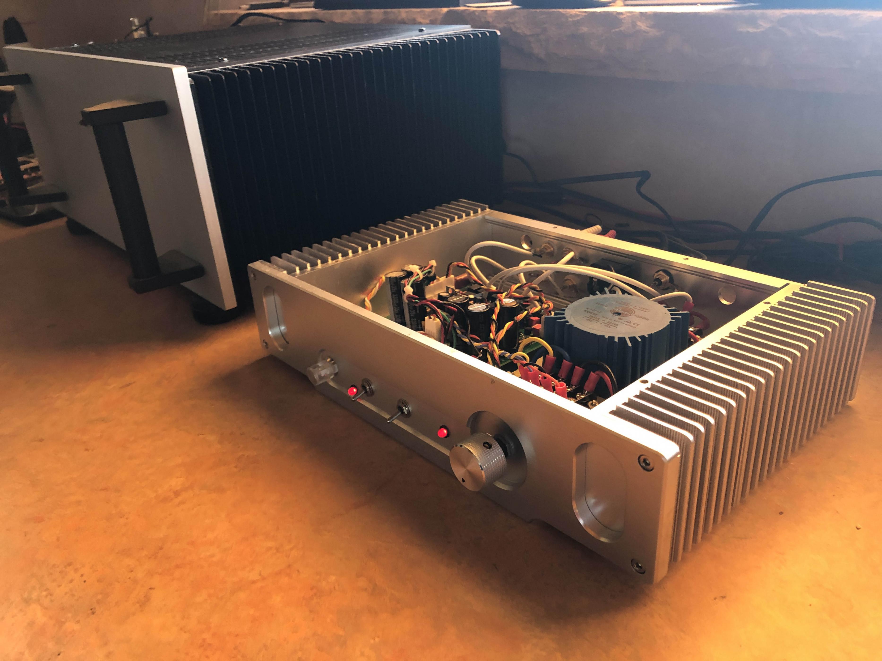

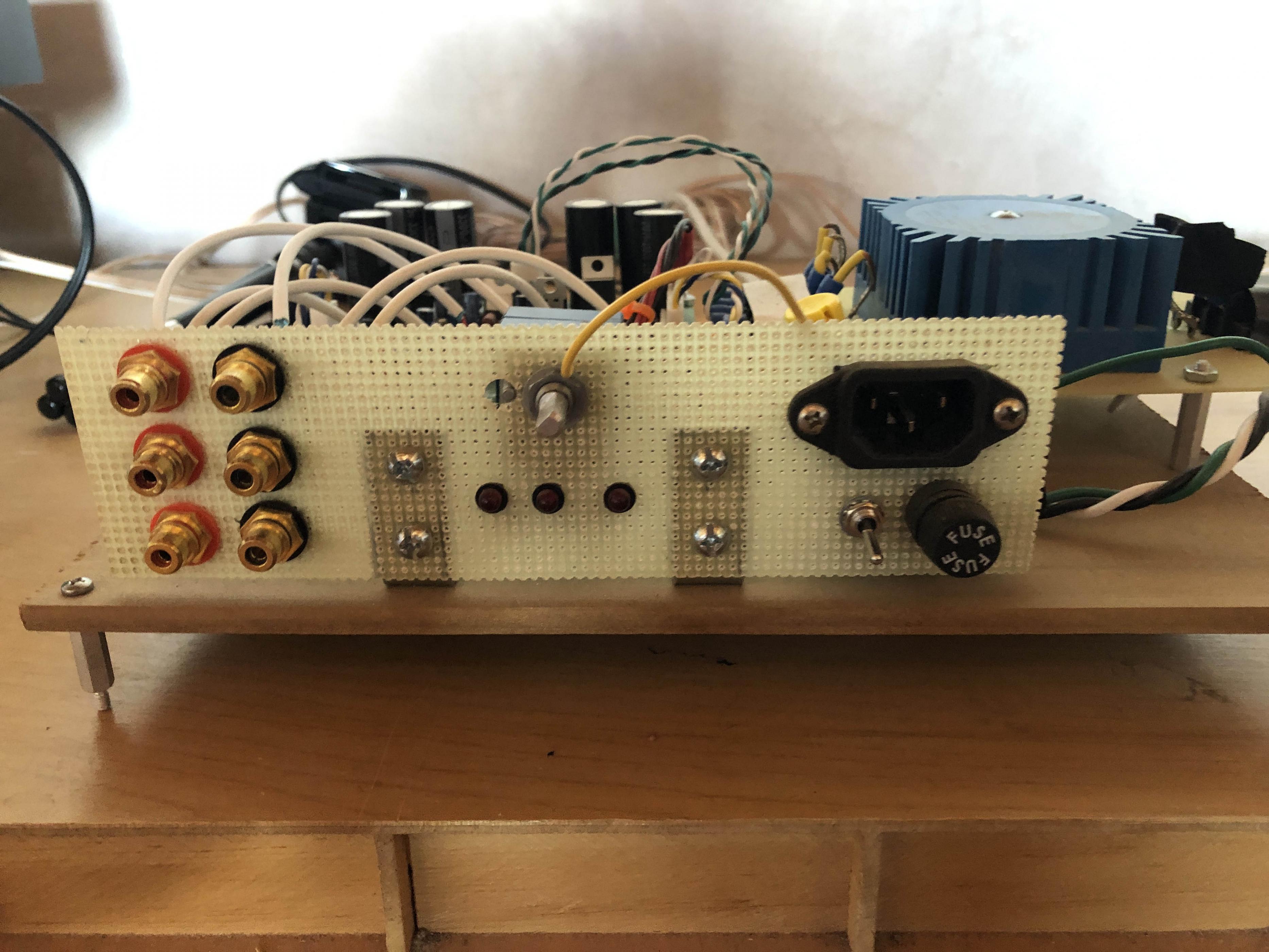

Here are pictures from my 2 builds. I did one on a breadboard and I paired it with a refurbished Dynaco ST120A. It is on my project list to put everything in a nice case. Maybe this spring.
I put the second in a chassis that I bought off Ebay and I use it with an Aleph J power amp. The case came with the heat sinks but they aren't needed.
For the power supply, you just need a transformer since the rectifier, filter caps and voltage regulators are on board. I used a Talema toroidal with dual 15VAC secondary windings.
There are 3 inputs to the board that get connected to the preamp input through a relay tree. I'm just using 2 of the inputs so I just have a channel 1 / channel 2 toggle switch, vs. a rotary 3 position switch.
These are high quality boards and the finished products sound great.

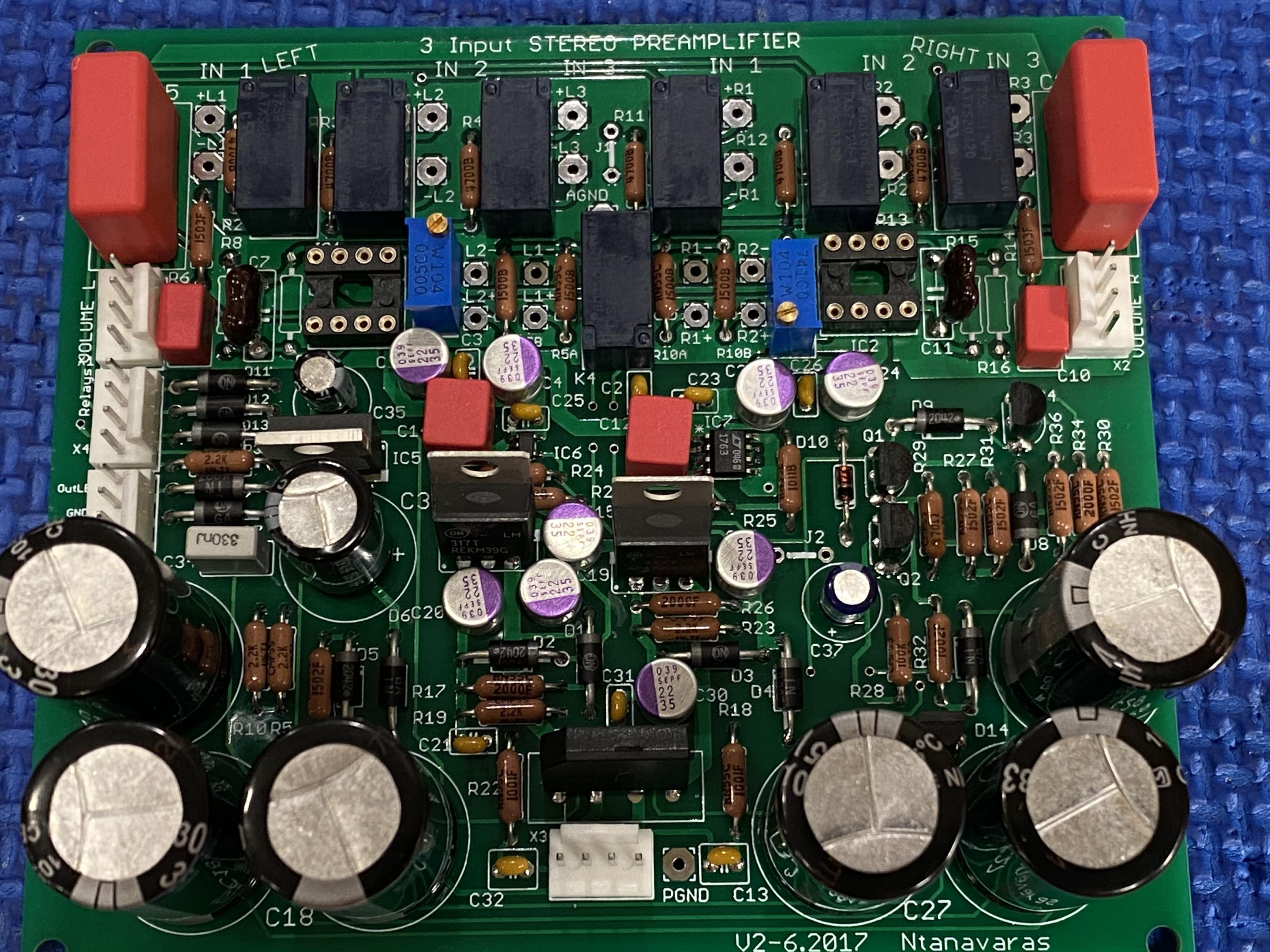

Hi George,
I finally received your preamp pcb and had time over the weekend to populate it. Unfortunately, I have to wait for a chassis now before I can get a listen :(
I couldn’t get the polystyrene caps, so I replaced them with Wima films.
Cheers!

Trying to order all the components before the pcb arrives, but having trouble confirming packaging.
Is everything through-hole or is there some surface mount? In particular the first line of caps, C1, C4, C15, etc. come in several different packages. Is there more detailed information somewhere other than the components list? The pictures in this thread help some but perhaps I should wait until the pcb arrives.
Thanks,
Jeff
Joined 2014
The LT1763 and LT1964 LDO regulators are the only two SMD components on this board. Take a look at the pic of my board, everything is there.
I think there are Mouser and Farnell part numbers included on the part list.
