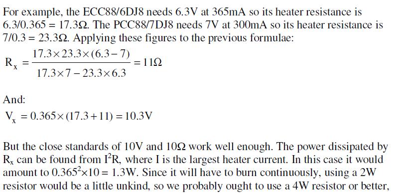

If you use a 10V heater supply with a 10R series resistor you can plug in ECC88 or PCC88 in the same socket and both will receive the correct heater voltage (current close enough)...The PCC88 tube is often claimed to be a direct replacement for the ECC88 / 6DJ8 tube. However, the heater of the PCC88 is specified to operate from a set current (300 mA), while the ECC88 / 6DJ8 heater is specified for a set voltage (6.3 V). So, replacing an ECC88 / 6DJ8 with a PCC88 usually results in the PCC88 operating with 6.3 V heater supply designed for the ECC88 / 6DJ8.
See also https://www.tubecad.com/july2000/page7.html

If 7.6V is supplied to the PCC88 heather, how much is the heating current deviation expected? It's just one resistance wire after all. I don't think CCS is mandatory.
For 10V supply, I calculated 10ohm for ECC88 (6.3V; 365mA; resistor voltage drop 3.7V) and 8ohm for PCC88 (7.6V; 300mA: resistor voltage drop 2.4V). how did you calculate?
The heating power is the same for both tubes, 2.3W approximately.
I was going by the 1958 spec of 7V rather than 7.6V

Filament voltage is not a parameter of relevance here, it may fluctuate as long as the current is as specified. If this is all too hard don't bother.
Yes, I took the data 7.6V in some datasheet.I was going by the 1958 spec of 7V rather than 7.6V

Take a look at the diagram in the first post. That's why I posted it.If 7.6V is supplied to the PCC88 heather, how much is the heating current deviation expected?
Your attachment says "PCC88 needs 7V at 300 mA". That's not correct. The PCC88 wants 300 mA. There is not set voltage. I am pretty sure the voltage you get from 300 mA through a PCC88 heater will be different for different makes/brands/batches/samples. Just use 300 mA and don't worry about voltage if you want to be on the safe side.I was going by the 1958 spec of 7V rather than 7.6V

Yes, I looked at the xls file now. It is similar for the ECC series, +- a few % deviation of the current on the heaters.Take a look at the diagram in the first post. That's why I posted it.
