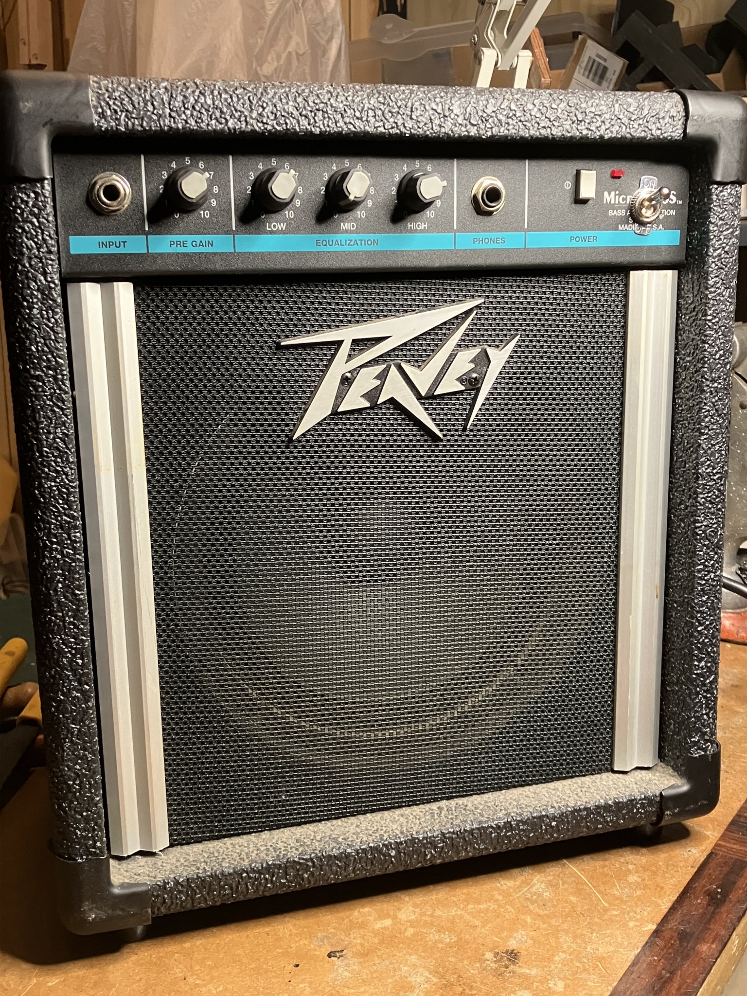

Yesterday, I was given a nice little bass practice amp, a US made Peavey MicroBass, probably a 1994. It precisely matches the photo on the 1994 manual and I've read the imports do not. Extremely heavy (30lbs) 1x8" combo. The tolex work is stellar. The amp works and it's surprisingly loud for 20W solid state.
What worries me is a faint hum from the chassis while the power button & indicator are OFF. It only stops when I unplug it from the wall. It's audible only when I put my ear to the front or back of the chassis. Not the speaker or headphones [which do hiss slightly at idle with power switched ON and no instrument plugged in - that's normal, right?]. Presumably a transformer hum? But how, unless there's power bypassing the switch?
I haven't pulled the chassis, because I'm concerned about charged capacitors. Should I be, it's 20w solid state? At any rate, I'm no tech or EE. All the problems I know to look for are bulging electrolytic caps and anything charred or loose.

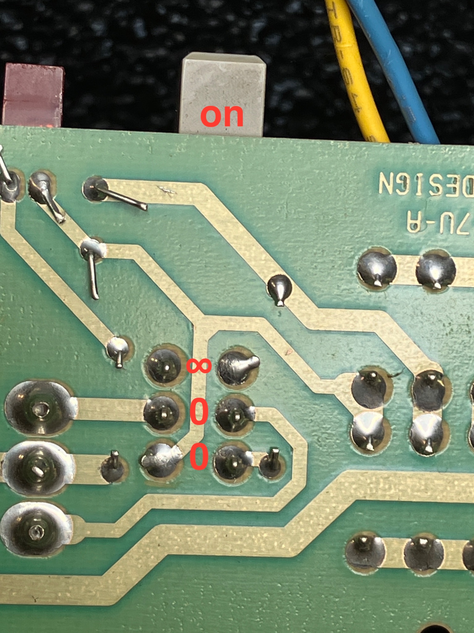

How did you measure the switch? They can break down under voltage in the off position, especially if you hear a hissing sound. It might measure fine at DC on your meter. wg_ski is right also, it could be C29 if polarity was reversed. Since mains goes to the PCB, it could also be tracking underneath the board. You'd need to disassemble it to get a look at that side of the PCB.
Hmm, interesting. You're right, the way I tested the switch wouldn't detect continuity between mains and the circuit in the off position. With regard to polarity, I thought the question was the polarity of my house wiring which is not reversed. Are you proposing that if the previous owner plugged into a bad wall socket it would have damaged something, so that the amp now hisses no matter where it's plugged in? Maybe fried a filter cap? But that wouldn't stop the amp from working, just make it a fire hazard?

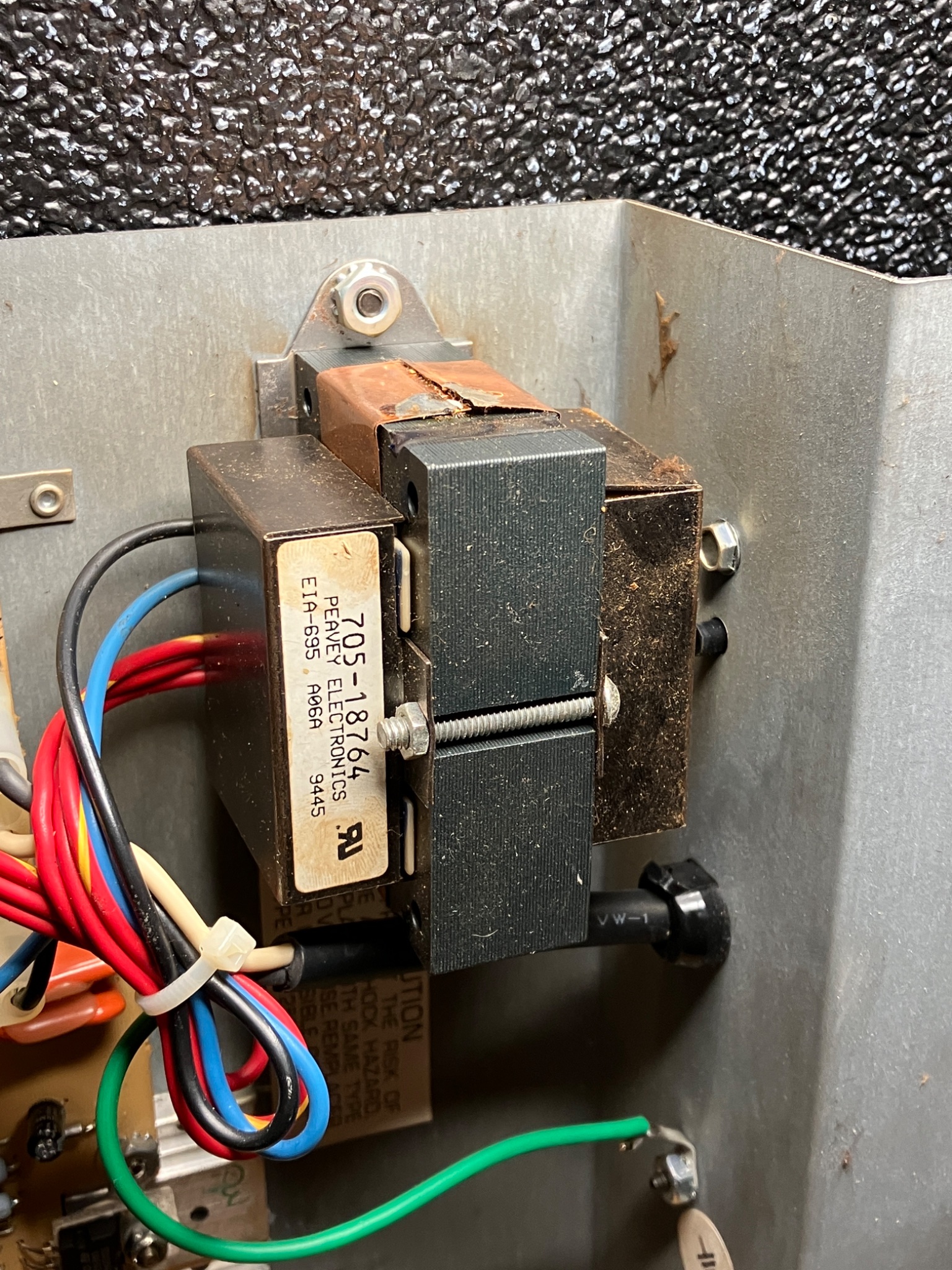

And what about the transformer? The copper shielding came apart where it had been soldered together. It's a bass combo, so maybe the joint vibrated loose. But, one of the steel covers is also warped. Seems like heat damage to me. Which brings something to mind! This is a closed back combo. The chassis isn't vented. Nor is the speaker. No airflow at all. The speaker is mounted to the baffle from the front. Yes, the bare metal side of the spider screws onto the wood and the padded rim is exposed behind the grille cloth. The back of the speaker is further separated from the chassis by an internal baffle, with one little hole for the speaker wires. And the rear panel of the cab is integral to the enclosure. Five sides of the cube are sealed in one seamless sheet of tolex. Even the bottom. The PCB is stood off from the chassis floor, but has one transistor screwed to the center with heat transfer paste, which I think degrades over time. Heat can only radiate from that one point to the control panel & rear of the chassis. And when I pulled the chassis, there were brown cobwebs inside. The outside & inside were plenty dusty and I assumed the brown was from the dust. Now I wonder if the brown was from heat!
I hope I'm wrong, because I like this little amp. But, an EE friend at Boeing has previously mentioned to me that it's a bad idea to put circuitry in an unvented enclosure - even if the enclosure itself is designed to work as a heatsink. In his opinion, that never works in the long run. Maybe because the heat paste degrades or the metal warps from heat and loses contact. And I read a 20 year old thread in which Peavey's new QC EE said years before he joined the company he had a MicroBass and had rearranged it into a head/cab. He didn't say why. But, he said more than once in that discussion that he couldn't reveal proprietary info. I wonder if he was implying that this thing is a fire hazard as designed? This is just me thinking as I write. But, I must say my 2006 Peavey Valveking Royal 8 has 2 transformers, both mounted so they hang down underneath the chassis with the tubes, exposed to the air. It's an open back combo. And my other bass combo, a Fender Rumble 100 V3 is a closed back. But the back of the chassis is vented and there's a warning label saying not to block the vents.

The transformer shield just came unsoldered because it got very hot. But if the amplifier is switched off and you still hear noise, that mean's it's not the transformer. It's the power switch or bad joints on the PCB underside. Both of these are fire risks, so don't continue to use this amplifier until the issue has been solved. Unplug it, then inspect the underside of the PCB. If there's nothing going on there then there isn't much left to blame except the mains switch.
That transformer didn’t get too hot. To get it THAT hot there would be other signs of damage. It looks like a poor assembly job. Those welded laminate transformers are ChEA-p (with emphasis on the ea, and a hard P at the end, because they really really really mean it). And they DO hum, it’s normal for them. What we need to do is find out WHY it’s doing it with the power supposedly off. Maybe somebody wired the power switch off the secondary instead of the primary (the way it’s supposed to in the schematic). Which would leave the primary energized all the time. That’s not dangerous per se, but it does waste electricity.

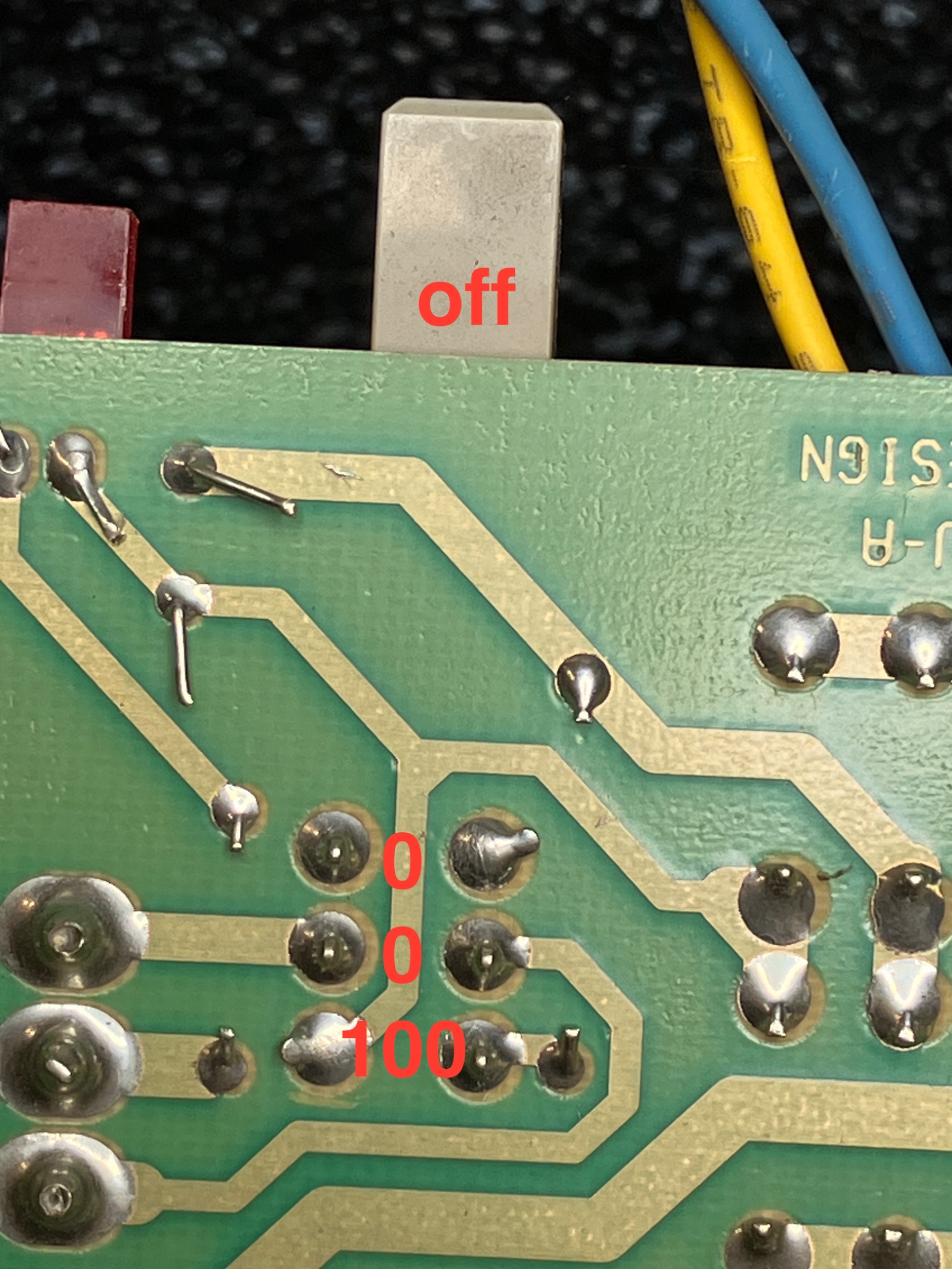

Thank you, wg_ski. I have just taken off the PCB. I'm not sure how to test whether the switch is wired backwards. It turns out to be a 3PST, 6 prongs to the PCB. S1 is the only switch on the schematic and it's a single pole, right? Nor do I find continuity between any pole and either mains wire, switched on or off. Yet, I find 0Ω between the mains, regardless if it's switched on or off. None of that makes sense to me.
As to the switch itself, it doesn't seem possible to mis-wire it. Each prong is soldered to its hole. I couldn't find any solder bridging on the board. So, the switch could only be reversed if the mains were reversed, which I can't tell. I DID find one anomaly with the switch! As illustrated below, I found 100kΩ across one pair in the off position. Is this the culprit?

Yep - they changed it. One pair of poles is going to the LED indicator. The others don’t have the required clearances for mains wiring. The secondary is indeed switched, leaving the transformer primary energized any time it’s plugged in. So it sits there, hums, and uses a watt or two, even when turned off.
The 100k is probably there to bleed off the charge in the caps after switch off.
The shielding is supposed to be a shorted turn outside the transformer core, to cancel any stray radiated field. If it’s open, it’s not working an could induce hum into the audio circuit, or any others nearby. Might be needed for FCC compliance. I’d just solder it back together.

I am about to solder that shielding back on the transformer. Now I'm learning about cheap. The copper barely overlaps, no wonder the joint failed. I'm planning to lay a few strands of bare wire across the joint to give the solder something to grab. Unless anyone thinks that's a bad idea.

Done! I didn't feel like leaving off to wait for a switch. Maybe later, unless it's a bad idea. I soldered the transformer shielding with some wire buried under a big ugly wad of lead. And holy smokes, I was able to check my email on the phone standing 2 feet from the amp with no hands on the strings and heard no cell interference. [by comparison, my 2007 KRK VXT6 studio monitors go nuts unless the phone is clear outside the room] 60 cycle hum also is no louder than I get from my other bass & guitar amps! So satisfying. I'd never opened an amp chassis before.
