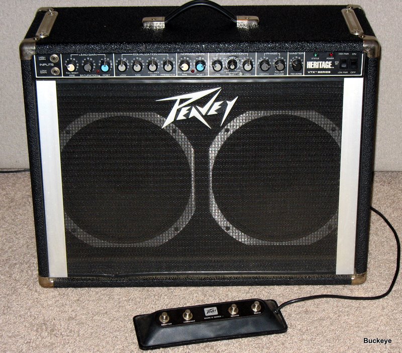

I just fixed one of these Heritage VTX 212 combo amps. It had blown two transistors, one 6465 (SJ6465) and one MPS6530. Got replacement parts at Newark Electronic's (element-14.com) web store.
Peavey's cross says MPS6530 is an MPS6531. Newark shows the exact replacement for the MPS6530 as a 2N4401 (9 cents ea). They also have the MPS6531 for 12 cents ea. I got some 2N4401s and replaced both Q6 & Q8 with them.
For the 6465, I used a 2N3442 ($1.43ea). The gain (hfe) of the 2N3442 can be a little low so you might have to hand-select higher gain parts to match the 6465, or match two 2N3442s. I did the former and the amp works great. Had I seen this thread before placing an order, I would have bought the AES old stock parts. But now, the water's under the bridge & I feel comfortable with my device substitution.
My Heritage VTX is a real nice, near-museum piece. Even has the original vinyl cover & footswitch. Check it out...
