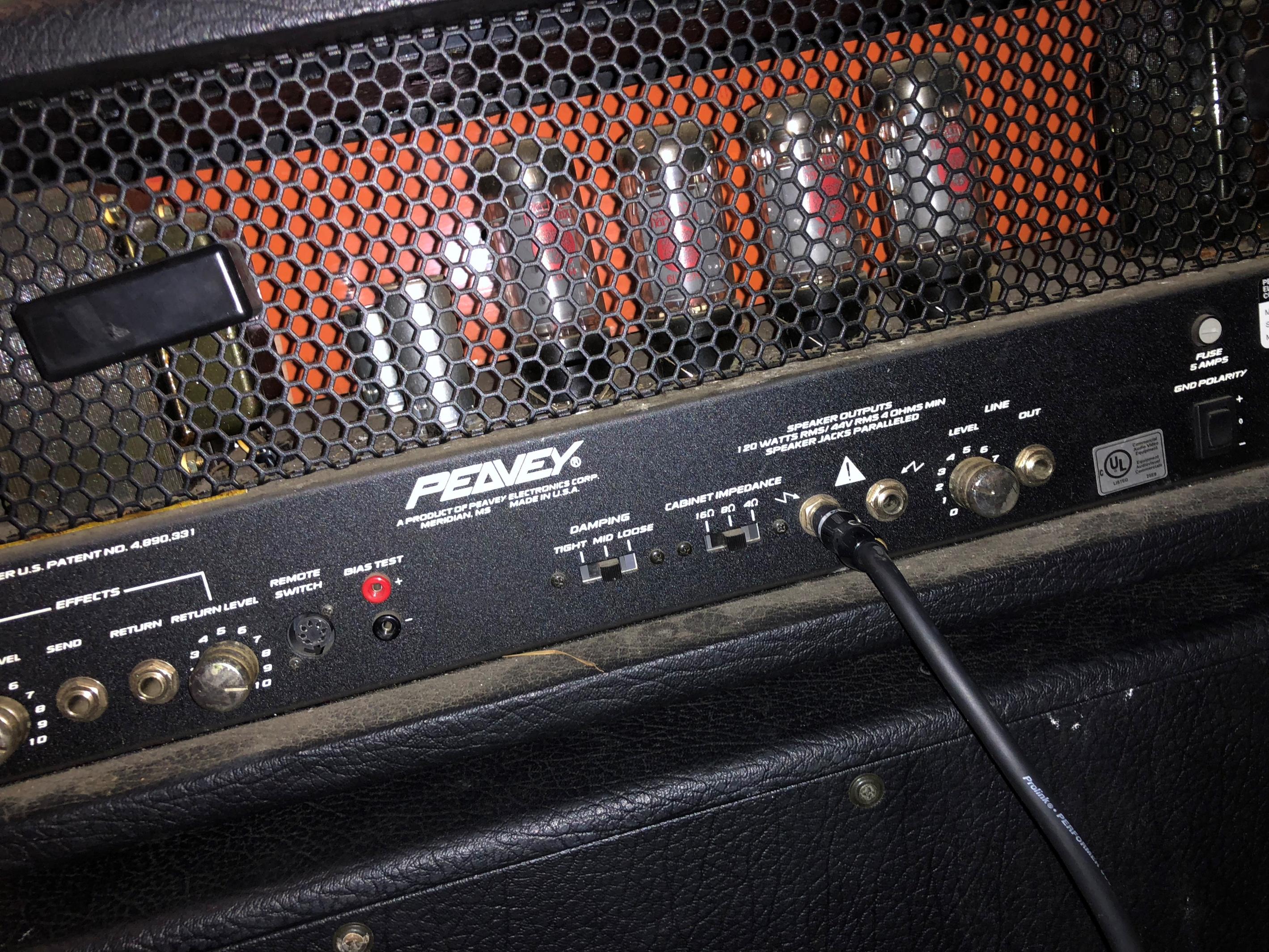

I am not a guitar guy. But I am trying to run my guitar players guitar through our PA, and his direct-out does not seem to be working properly. it is putting out a very low signal and is the same, no matter what the volume level is on the output volume control. It is a Peavey Triple X. Is it possible that the plug and knob just needs to be cleaned up? The amp itself is fine and has been used continuously. This direct out has never been used on this head unit. Or is there something I am missing? I do not see any other controls that may be related to the direct output. Would a DI box fix this? I would think that it should work without one. With any guitar rig that has a DO with a volume control, is it necessary to have a DI box inline to the mixing board?

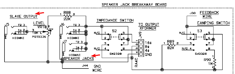

I don't see a direct out on any of my XXX schematics. There is a line out, is that what you mean?
The line out is a simple voltage divider across the speaker output. The level control right next to it should be able to turn it down to zero. It would be easy enough to see if the pot is broken inside.

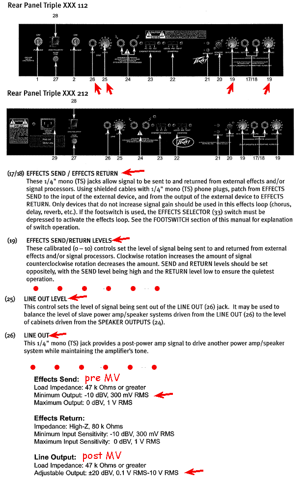

Peeping the Owner's Manual, and the schematic...
I do not see a "Direct Out". What does it really say?
"Direct" is often taken to mean "direct from guitar". That's where you would use a DI box.
"Effects Send" _IS_ a low-level interface to guitar-level effects boxes. It seems to be adjustable. However this is *before* the Master Volume (I had to see the schematic to be sure) so will indeed be trouble in PA.
Over toward the other side should be "Line Out". This is post-MV and is specifically intended to drive other power amps with the same sound the XXX is putting into its speaker. THIS is where you want to tap a PA signal.
Or maybe. There seem to be several variant "XXX"es so it is possible you found one without all the frills. If you work a soldering iron, it would be trivial (maybe not your job) to hack a 22K resistor and a 10K Audio pot. (It seems to say Linear but I think typical levels will be all cramped-up in the 1-2 zone; a Audio would spread this out.)

My mistake. it is in fact labeled.."Line" out. and no, I am definitely not running it without a loAd present. We played a show recently, and tried to utilize the line out option, but ended up having to run a mic, due to the signal being almost non-existent. Im trying to figure out now the best way to utilize it for future use to avoid having to mess with a mic and worrying about ambient noise, positioning, etc. in our jam room we definitely don't need it. it is plenty loud. lol so it sounds like the level pot is probably needing some attention?

But I agree with you of course. What I wanted to point out initially is that the line out of the peavey is actually useless for PA. It's intention probably was to provide a connection for a slave amp.
