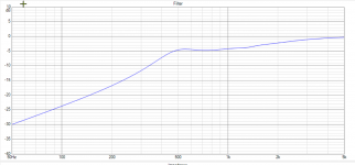

To give people an idea of how terrible an idea it is, I've run a sim using a Dayton RS28. No, it's not the same tweeter, but it shows the general idea of why doing this is boneheaded:
1) At 1khz the tweeter is only attenuated 4dB
2) At 300Hz the tweeter is only attenauted 12dB
So the power handling on the speaker would be something like one watt, if that.
