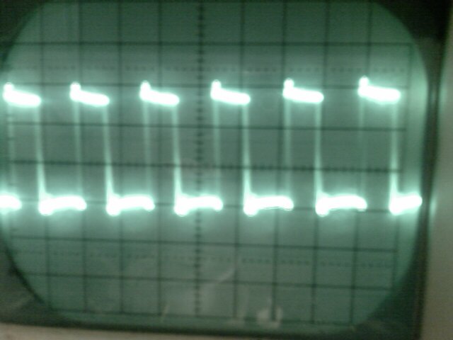

i went and check the truck the voltage is 12.2 off and 13.0 running i got a little 400w
and and hooked it up the volts dropped to 10v before it cut off i guess thats what mess the amp up.i hooked it up in another car and it does the same thing
Does the voltage drop with no speakers connected?
If so, it may have shorted output transistors and it's drawing excessive current.
yeah it does i wasnt sure because it played thanks i got some direct replacements ill put them in tomorrow thanks again man!!!
