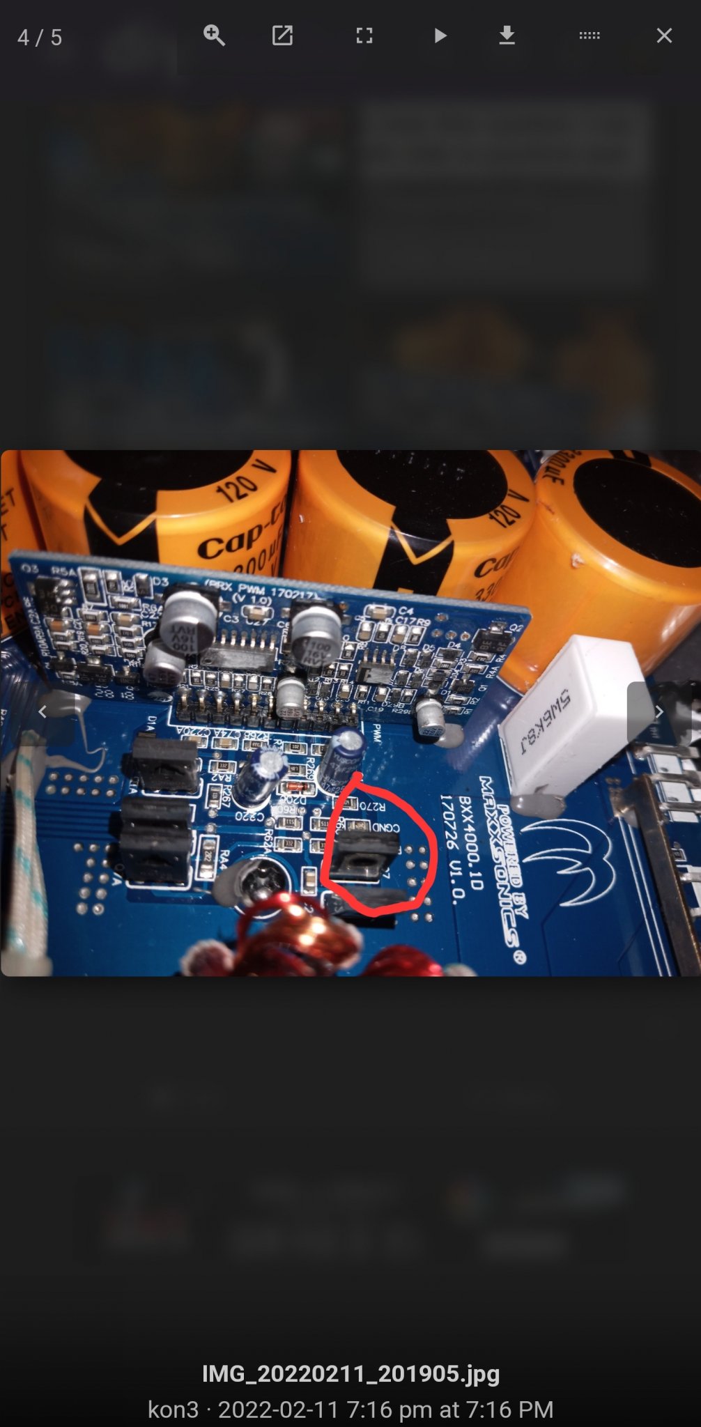

The green capacitor that is circled in red in the picture, i replaced both capacitors on the board like i mentioned. amp still in protect mode after replacing.
please also refer to picture of polarization to make sure i installed capacitors polarization correctly. double checking my work.

Thank you!!! They are fried just looking at both tiny resistors, do you know what proper replacement i can order for both Cgnd and Rgnd? thank youCheck CGND and RGND circled in the picture. These amps seem to open them up alot. It's what connects the chassis ground to the audio ground

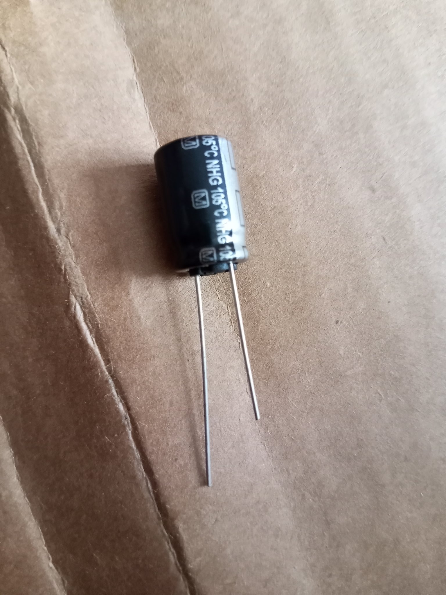

the replacements for the green caps are polarized the one lead is longer on the cap than the other lead.Are the replacements for the green caps polarized or bipolar?

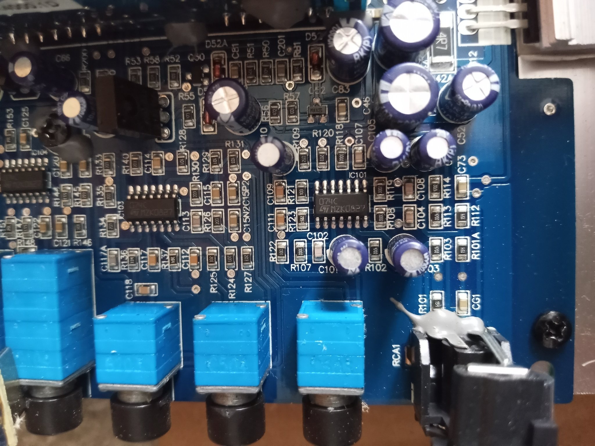

Post a photo of the area around the RCA jacks.

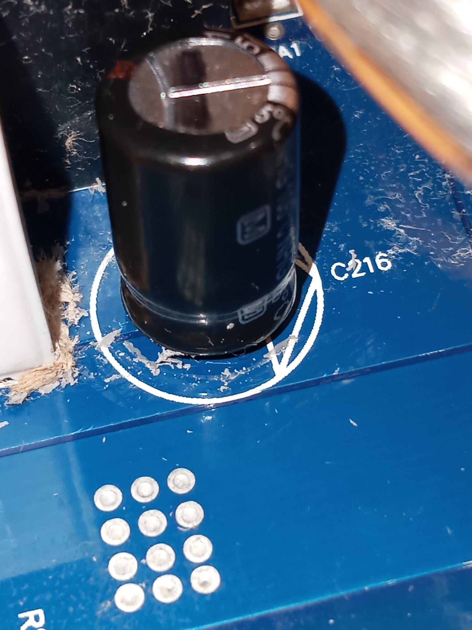

Does the capacitor have a line on it indicating that it has a negative terminal?

here are 3 photos, one of the capacitors i bought and replaced and the other photo of RCA jack internals
the board has this indication feature on the PCb you can see underneath the cap i replaced, i assume the pointing thing means negative side of cap? there is no + or - on the board however, just this indication feature in picture below.
If i replaced the PCB with the wrong capacitors, please link me to the bipolar capacitor needed (i tried searching could not find any "bipolar" 10uF 250v 105c only polarized)
The following is the only single cap solution (not two caps in series) that I found reliable.
https://www.mouser.com/ProductDetail/Panasonic/ECQ-E2106JF?qs=9ouE0kzBZ2qsokZL7Ax3dg==
They will have to be mounted something like in the attached image.

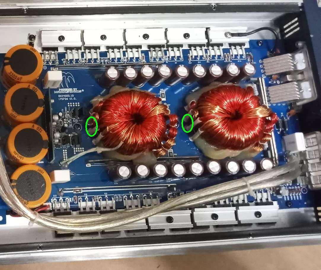

can you please identify or describe where power transformer secondary is located please and what it looks like. is it one of the big red power coil thingys?RCA shields to the center tap of the power transformer secondary?
multimeter was not able to produce any reading of any kind rca shields to power trans secondary on any resistance settingAny of the 4 terminals highlighted below.
