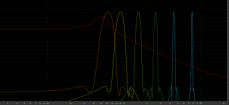

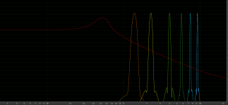

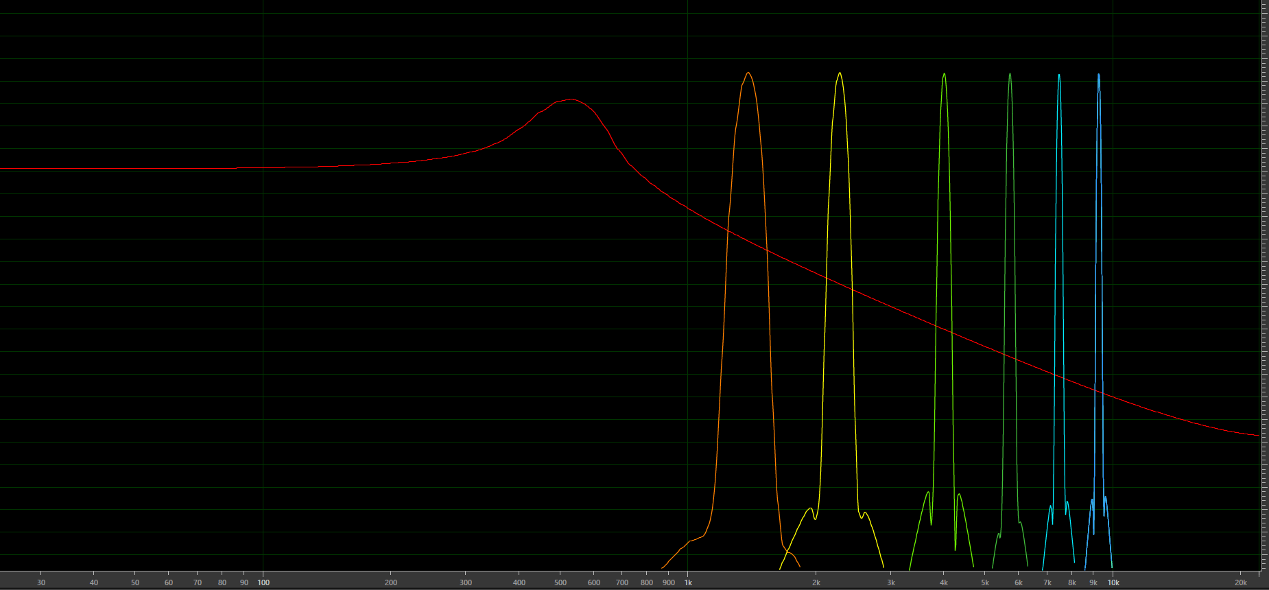

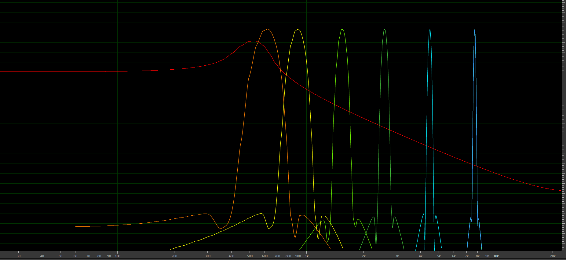

Anyone ever test a log vs linear sweep and try out different phase rotations for the start of the sweep?
I often wonder if flattening the phase for one kind sweep is enough. It is so easy to be myopic - even if you use lots of tools.
I attached a 600hz rotating linear sweep (it tilts up if your system is flat for a log sweep).
