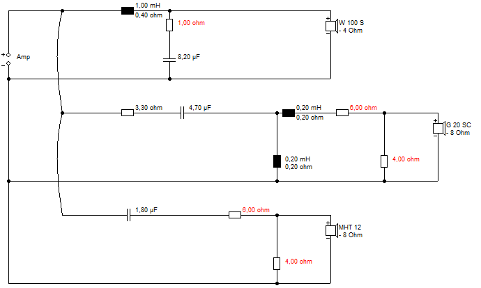

Ribbon tweeters don't usually appreciate being connected to DC, despite the transformer. Removing the 1.8uF blocking capacitor might be a very bad idea. the 3.3R could be anywhere, but I suspect something just got louder.

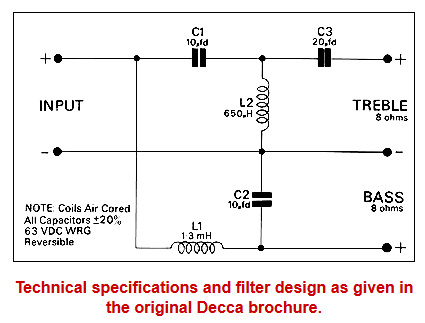

Decca Kelly ribbon schematic below.
Without a schematic, frankly, your ideas don't inspire confidence. 🙂

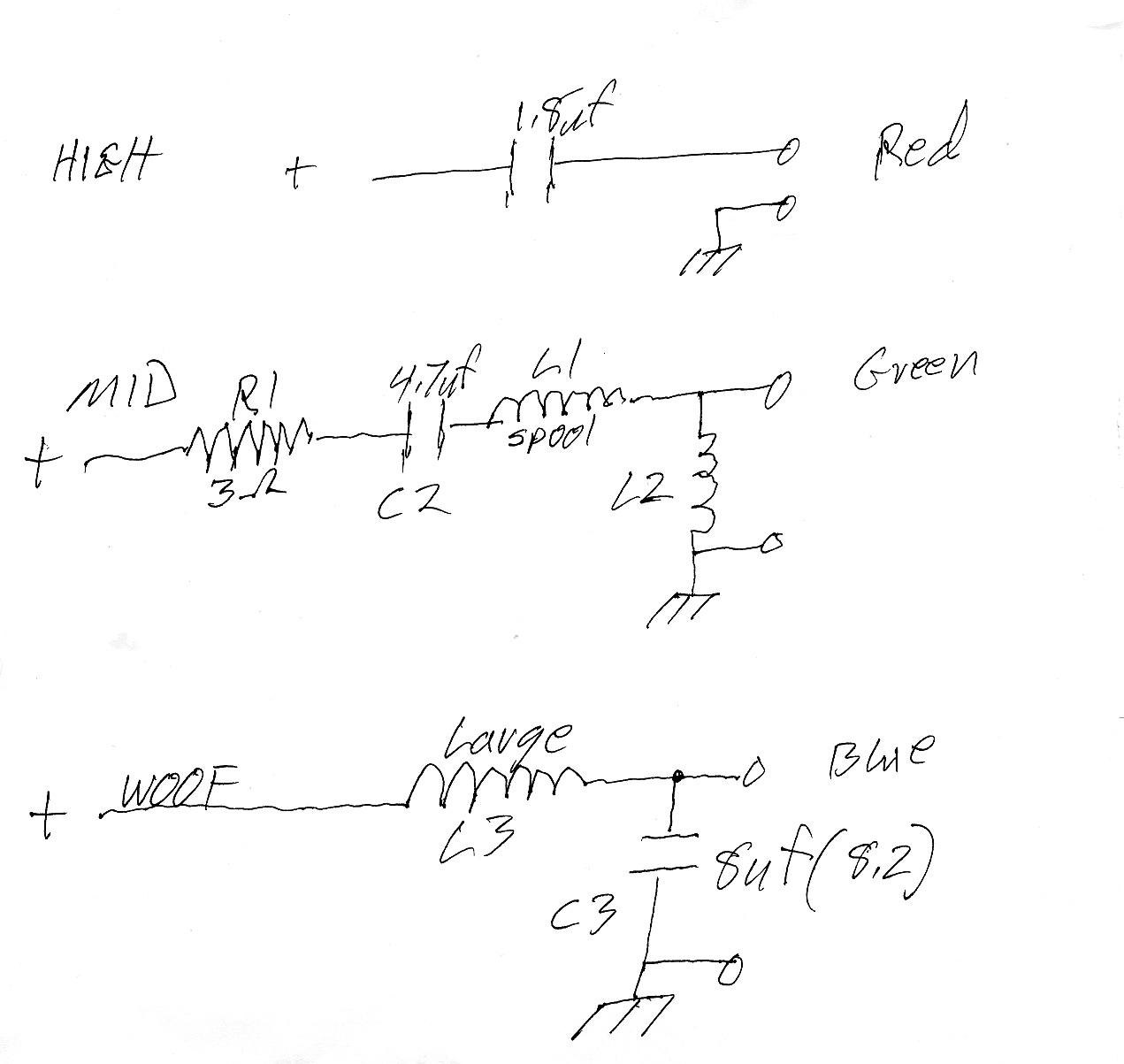

The 3R3 in-line resistor for the mid-tweeter was prescribed, I believe, by formula to reduce the sensitivity. I do have a diagram of the circuit which I made before the change.
About the capacitor for the ribbon tweeter. My issue is the fact that a bi-polar electrolytic capacitor was used here. I now feel perhaps polypropylene capacitor may have been a better choice.

Removing that 3.3R reduces impedance to a dangerously low 2 ohms. Your amp may fry. 😱
Your schematic doesn't make sense to me. The series coil should come after the shunt coil in the midpass. If that is what it is.
It's a 4 ohm 100mm bass, I would guess. A NP electrolytic in the bass shunt helps by adding a little resistance. Tames a tendency to peak at crossover. Hence is a FEATURE, rather than a fault. 😀

I agree. But that diagram I made is truly what what the factory did. I went over it and again and could not fathom it. I agree it does not even look correct, but somehow it works.

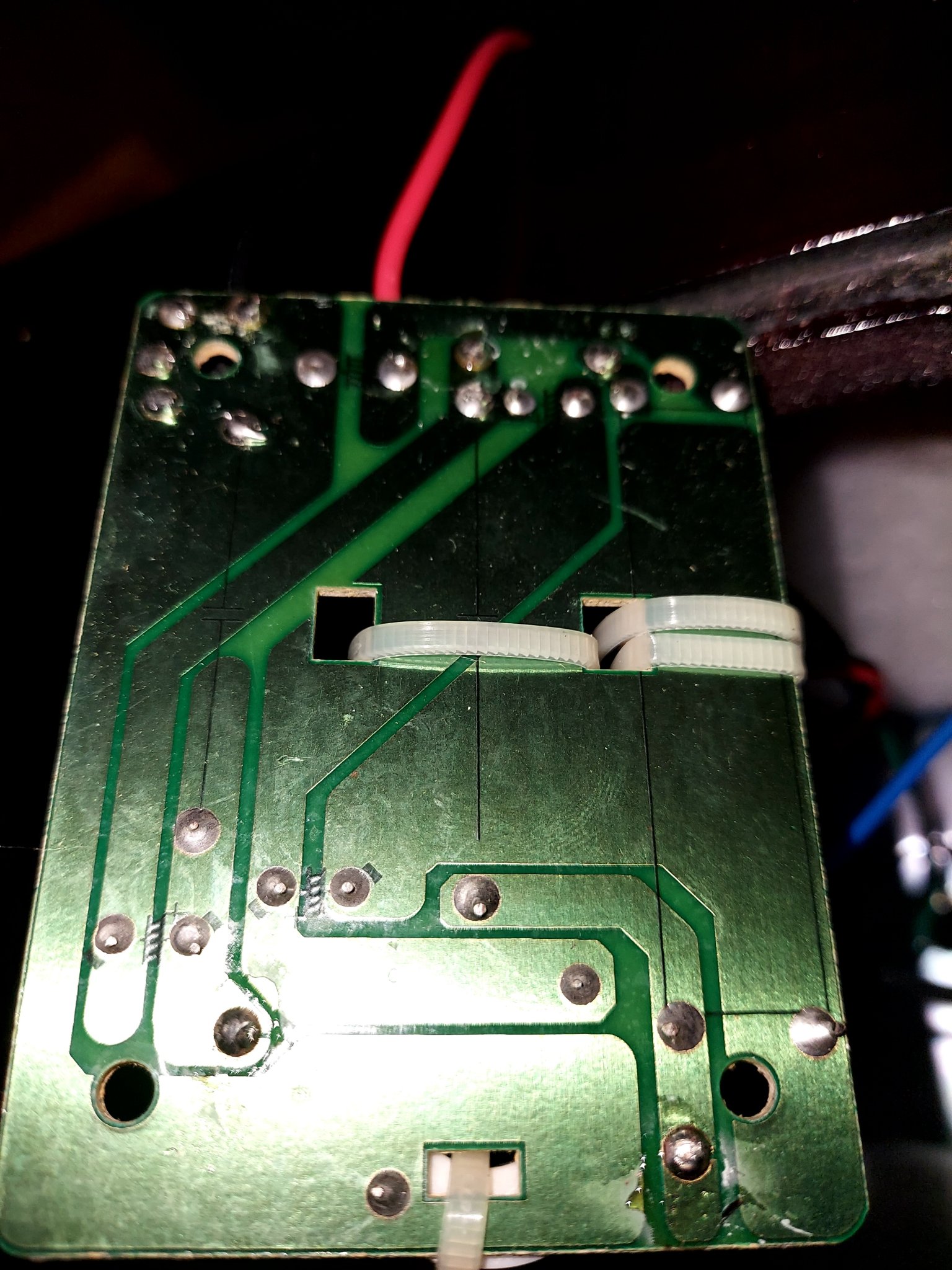

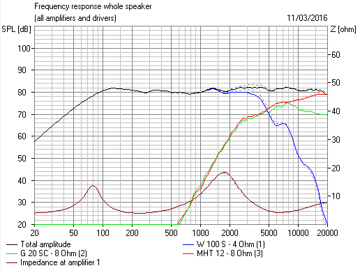

I bought a pair of these this morning from a car boot sale for £10 (should have haggled!). Obviously, I had to look inside. I traced out the crossover, but I seem to have forgotten how to add images here. Anyway, the crossover is pretty much as you would expect. The bass driver has a CR Zobel network across it and is fed via a series inductor, so it relies largely on acoustic roll-off. The dome tweeter is fed by a third order CLC filter but has a 4R7 resistor in series with the tweeter. The leaf tweeter (it's not a ribbon) is fed via a second order CL filter.
They are genuine 4R loudspeakers with quite a mild phase response (<50 degrees). Impedance suggests the reflex box is tuned for 50Hz -3dB (quite ambitious for a small box). I'd leave the crossover well alone - that leaf tweeter is fragile. I may make some acoustic measurements at some point. The box is nice and solid, although I doubt that all that plastic bling on the front does the polar response any favours. Stopping the port to convert it into closed box might be a worthwhile experiment.

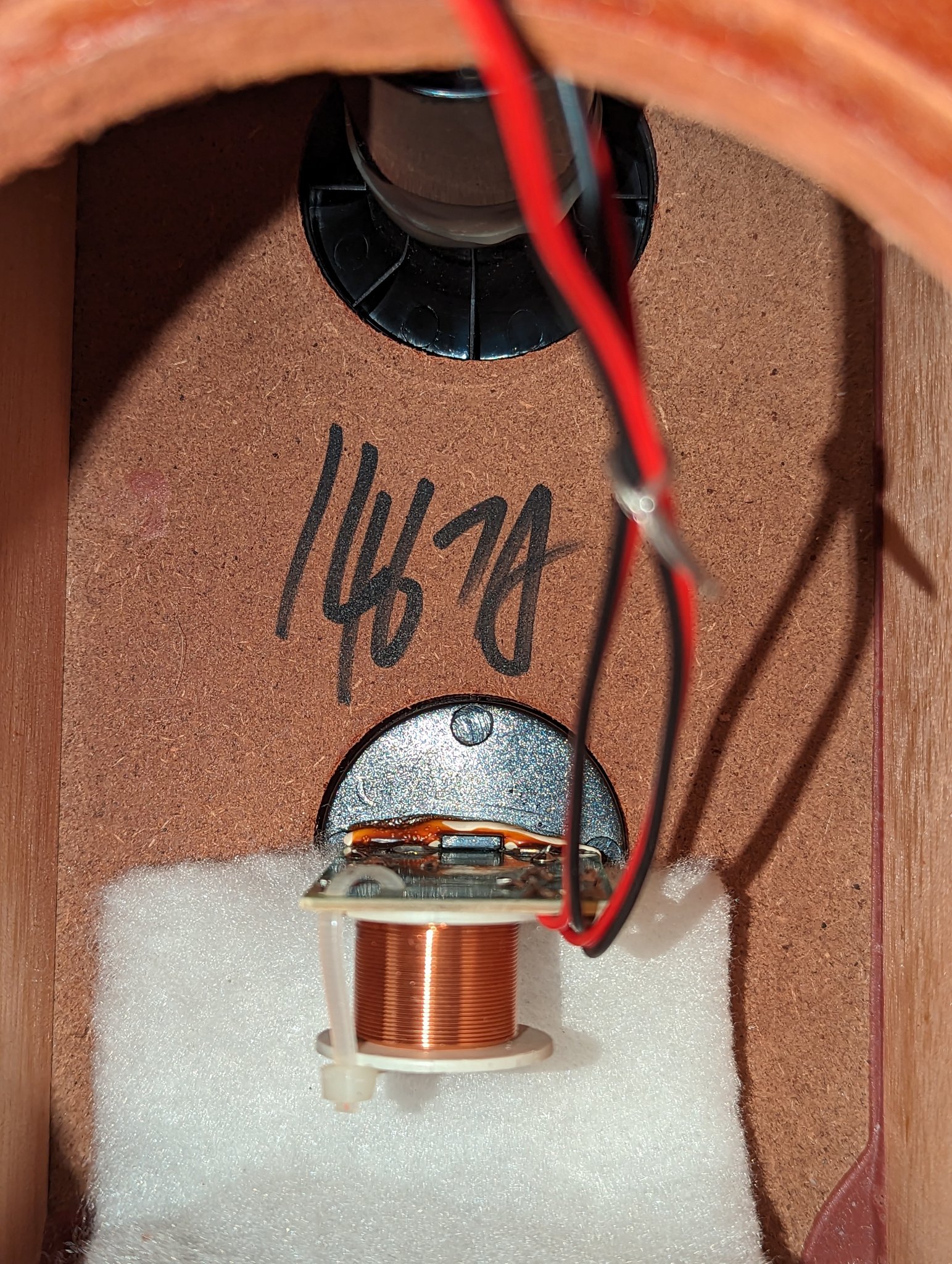

Hi. I have. Pair of MCD708* and ther is a terminal plate with binding posts on back, plus the front ring/tweeter plate is removable, if careful to protect the cabinet face, though I haven't-yet.
My question is: Anybody here know what value of capacitor is used on the tweeter(I'm assuming it's a cheap NP electrolytic but it's not located st the binding post plate as with many small units)? I want to replace with metal film.
And where are cap & coil located in box so I know where to look?

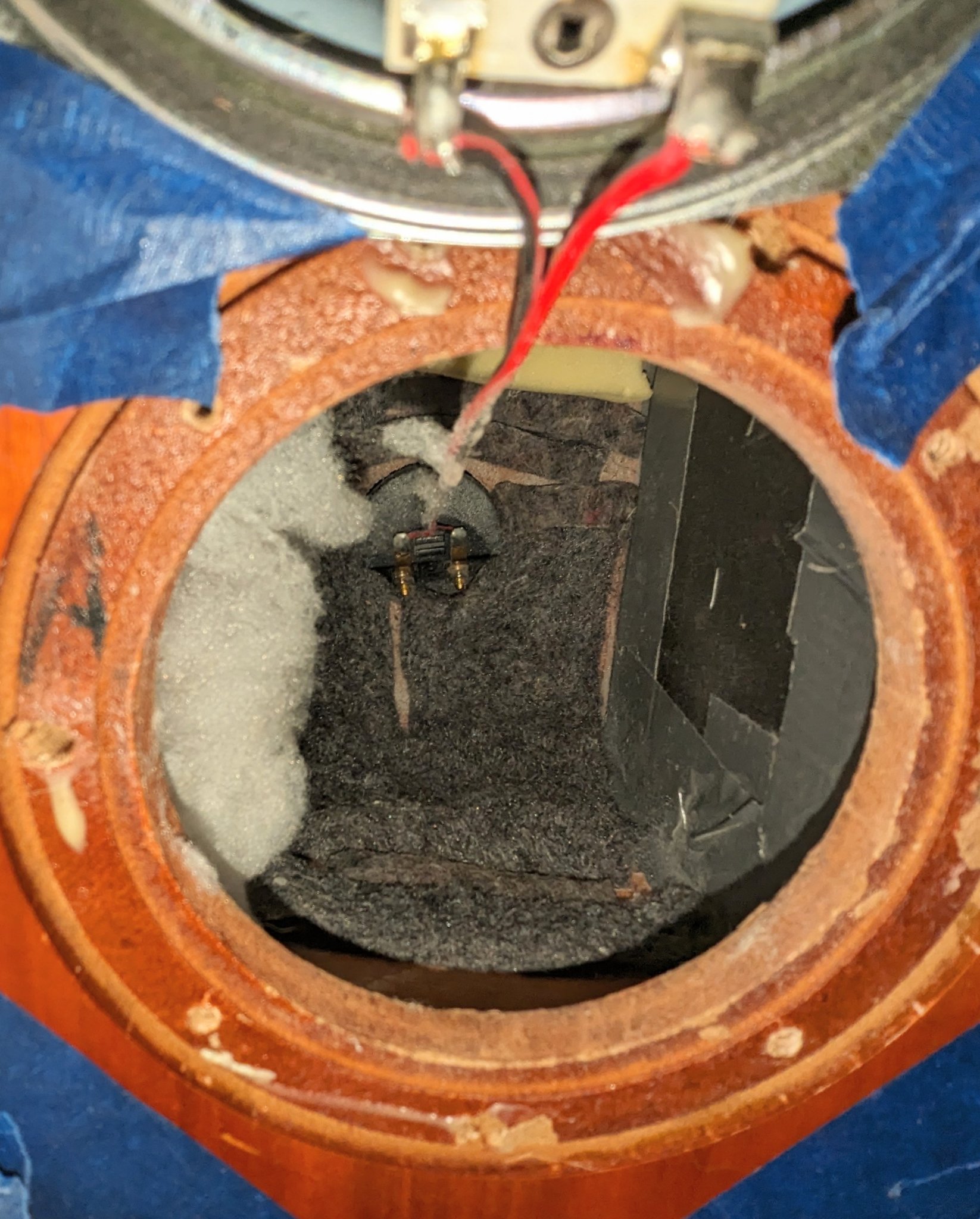

Okay, I finally opened up both MCD708 pairs (yes, I snagged a second pair locally).
On the first pair there was a crossover pcb (board marked "mcd707") attached to the terminal cup, using a cap and air core inductor, with no power resistors to be seen. I will need to measure the unseen values. On the second pair(serial numbers show them to be later production)
there is no crossover board, only a 3.3uf series cap for the tweeter!
Strange, as the stickers all say "MCD708"., and the drivers are identical.🤔

Stock X/O on right. Modified X/O on left, replaced NPE with a Polycap. Subtle, but noticeable improvement in treble detail. 👍
Cabinet mods include a layer of self-stick asphalt (auto) damping,
Dacron on the top and other side, plus 1/2" soft felt on back & bottom. Significant improvement in midrange clarity. 👍
Anyone else have a pair of the MCD708s, and how are yours equipped?
I've had four sets of these (apparently the amp unit fails often leading to the speakers alone being sold). Only one of them had the PCB crossover and inductor. The others just had the 3.3uF cap on the tweeter. Why four pairs? The first pair had the PCB crossover and sounded pretty good...
