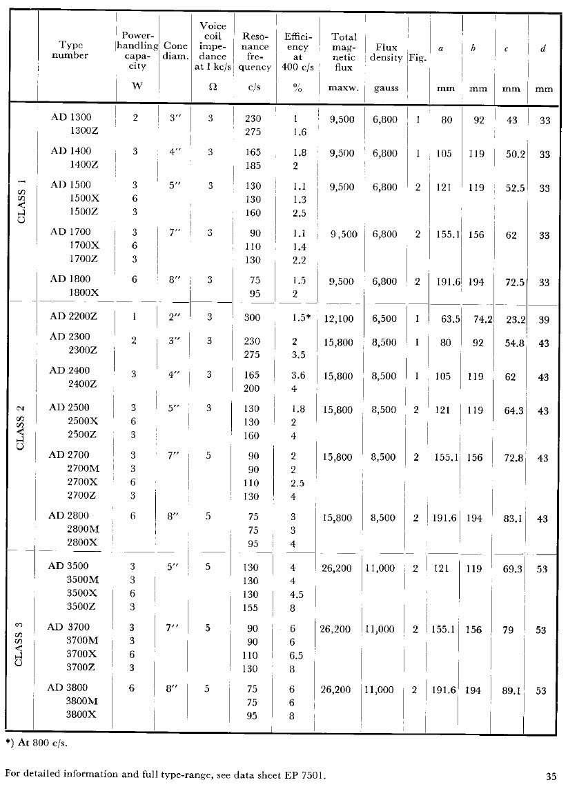

If the Radiomuseum information is correct, it is a nice device. The speakers AD3700M and AD3700X are good dual-cone 7'' fullranges. I attach the data. The sound should be pleasant, expecially after disconnecting the treble-cut capacitor on the side tab of the volume potentiometer. The stylus rubber mount inside the piezo cartridge is probabily unusable, but the turntable arm does use a standard Philips quick change connector and the cartridge should be easy to replace with a later and somewhat better type, although it is quite far from Hi-Fi specifications.
AD3700M is quite efficient, far more than today generic home speakers. But other parameters are worse. It may be damaged very easily by excessive power, as example.
My guess is a paper VC former, 30 ga or smaller wire, but still more than expected. 98 dB, 3%, I would have expected from their best ones. It’s not like the magnet will pin your hand to the refrigerator door like modern ones can.

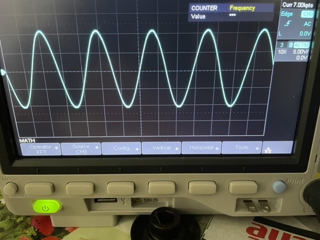

Managed to find time to get setup without pets in the vicinity with the front off to check the EM80. Weak but also not really showing any open/closure which could point at a weak beat detector. However pin access to the triode/twin diode EABC80 is convoluted being shielded tube and box shielded on the underside of the socket. So that will have to wait.
I did note a missing cap (it has the 3.2uF but not the large cap that i could see.
Oscillator seems tight enough in AM.
Switching band seems a little ragged at the top and bottom of the waveform.
