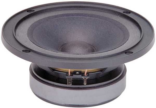

In the box from the attached picture, that I use for demonstation by customers, which want to diy their own loudspeaker, I use a model from the french brand PHL, that I can order in 8 ohms (model 1220) and 16 ohms (model 1230) - go to Welcome on PHL audio web site
or
http://www.phlaudio.com/datasheets/17_pdf/1220_1230.pdf
By compare the value for sound presure level (SPL) at both impedances I observe a curios thing:
The value at 16 ohms is the same (almost - only 0,3db less) than by the 8 ohm version, based on the output voltage and not on the output power as mentioned in the pdf datasheet.
Which reason could be therefore present?

The term 'SPL' indicates sound pressure level (i.e. How loud the sound is.) genereted by the same energy given.
In this case, those midranges; the 1220 and 1230 generate 93dB @ 1W.
That doesn't mean you get the same SPL when the same volume set.
Because almost all amplifiers today is voltage driven, the same volume set means the same voltage shall be given to the speaker(s). NOT the energy.
At the same voltage lower valued resister will consume more energy; Ohm's law.
For example, when the 1220 is driven at 1W, the voltage is calculated to 2.83V.
With 2.83V given, the 1230 is driven at 0.5W.
So you get the half SPL; 90dB. This will fit what you guess from the other manufacturer's example.
If you want to compare the Efficiency per energy, you have to use the way SPL @ 2.83V. And it is common to many manufacturer's specs.
PHL products are dedicated to SR or professional use, rather than home audio.
In the field of SR, Efficiency is more important. I guess that's why PHL represents SPL @ 1W instead of SPL @ 2.83V.

Oops, I made a mistake... In the fifth sentence.
If you want to compare the SPL per voltage(the same volume potition), you have to use the way SPL @ 2.83V. And it is common to many manufacturer's specs.
You mean "so you get a loss of -3db"... this is naturally the relationship. But I observe especially by this PHL models by measuring only 0,3 (perhaps 0,4) db. This means, the efficiency is in fact the best in the 16 ohms version.For example, when the 1220 is driven at 1W, the voltage is calculated to 2.83V.

Thanks for the assist.
Thanks for the assist, tiefbassuebertr.
I missed the difference.
I guess this is because of the stronger motor in the 1230.
The motor in the dynamic loudspeaker is mainly composed of the voice coil and the magnetic circuit.
Given the macnetic curcuit (magnet and pole-piece) is identical to both models, voice coil is the difference.
In many case, higher resistance model have longer wire in its voice coil; this means stronger magnetic field.
BL factor is the reference for the strength of magnetic curcuit.
By the way, I recommend the 2460(8") over the 1220.
