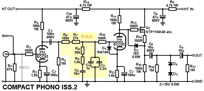

In a similar vein, there's the Valvewizard Compact Phone Iss.2 which I'm about to build into an existing EL84 PP amp.
I chose this because I am limited to one bottle per channel. If you are making a dedicated preamp you can use more valves

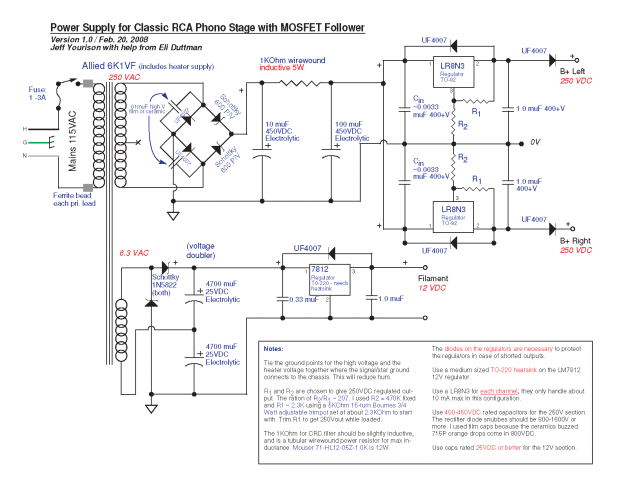

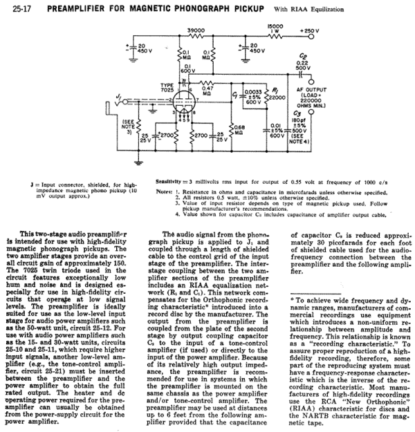

In a PM, Dan asked about a PSU for the tweaked RCA setup. I'm providing Jeff Yourison's drawing of a cost effective, solidly performing, PSU.
I've also provided RCA's original setup, so that the various tweaks the membership has added can be cross compared. FWIW, RCA's specifying the 7025 was not a sales gimmick. Post WW2, which the design dates to, setting DC heater supplies up was difficult. The spiral wound, hum bucking, 7025 heater allowed a VERY careful builder to obtain a satisfactory residual hum level, with AC heating.
Thanks Eli - I may use that PSU for my phono stage. Do you have a slightly higher-res version? That one is just on the edge of legibility (well for my eyes anyway)

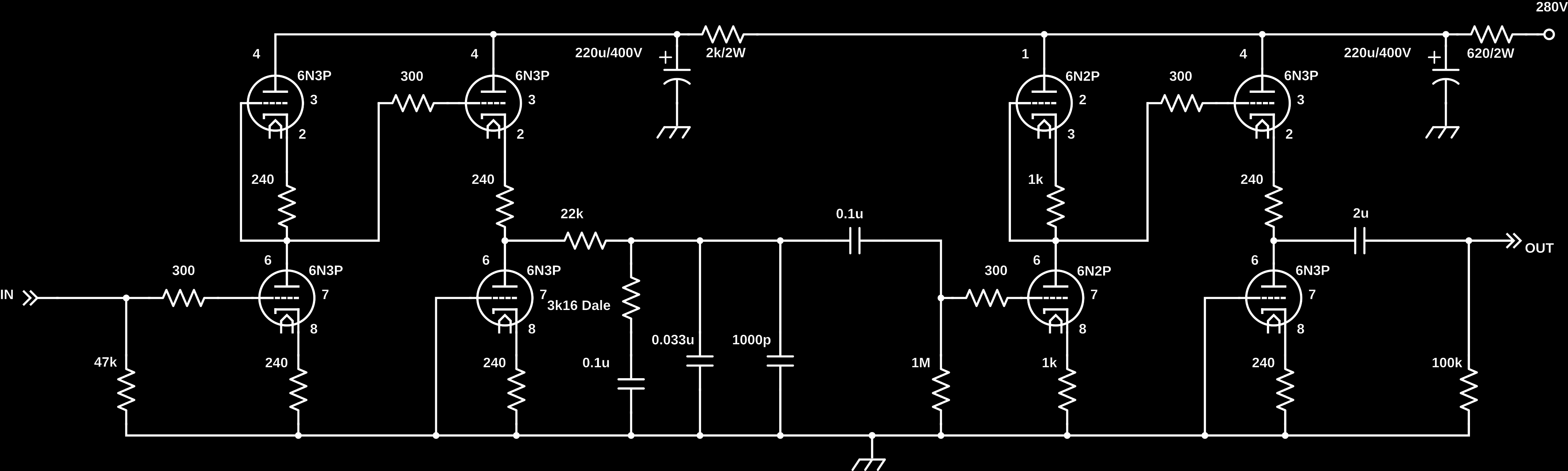

I built this today... Always a great sounding amp, and stupid simple IMHO.

This is a passive build RIAA. Most of those passive EQ sound stupid boring.
An active build can do much better.

If you want to learn something about the challenges of active equalization, you might give this a read. It is authored by a former contributor on the diyAudio forums. Of particular note is the gain requirement for good equalization accuracy. If it is difficult to get the necessary gain from an op amp, then a vacuum tube will struggle even more. Active equalization also introduces an extra time constant which is not part of the RIAA specification; this requires a work-around so as not to degrade RIAA accuracy at high frequencies.
Phono Preamp Design Using Active RIAA Equalization
You haven't presented any convincing information as to why passive equalization should be avoided. In fact, a lot of respected designers would strongly disagree with you. Some of those designs have already been mentioned; here is another one from the late Allen Wright.
