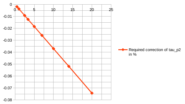

Just a couple of plots that follow from the equations in the document. First the required correction in % for the first time constant to get the first RIAA pole where it should be, as a function of the cut-off frequency of the DC servo loop in Hz:
The same for the time constant that sets the second RIAA pole:
These corrections are small enough to neglect for most practical purposes.

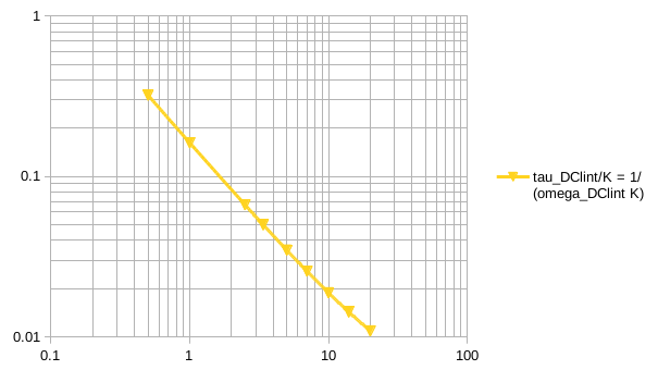

Finally the required value of the time constant of the integrator divided by the forward-path DC gain, so 1/(omegaDClintK), in second as a function of the desired servo loop cut-off frequency in hertz. It is not exactly inversely proportional because of the effect of the correction network in the loop.
Basically, if the EQ network is inside the feedback loop, then the differential input stage will see that the output signal is different from the input signal, so it will produce an error signal to try to correct the output to match the input. Depending on the loop gain at the frequency of interest, the differential input stage can correct what it thinks is a FR error in the amplifier by only so much....what is the factual origin of this shift?
