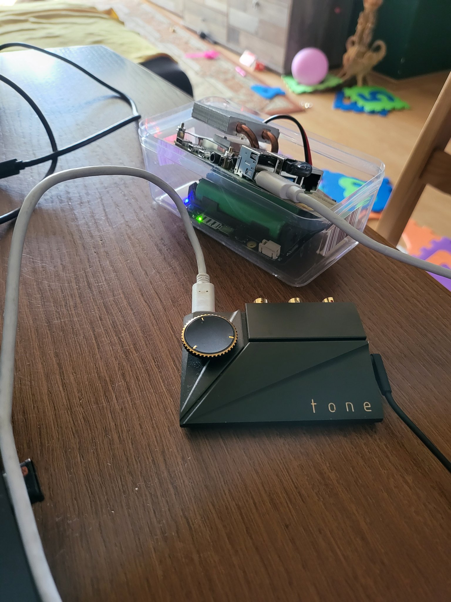

Hello guys. I just wanted to ask how raspberry pi zero 2w performs with jivelite and flac files? I want to build portable 4tb player but after quick test rp4 8gb no display at this moment and currently on flash driver final project usb 2.5" sata or nvme depends of power consumption but the problem is that two 18650 gives only 2-3hr playback juce with khadas tone2 pro
