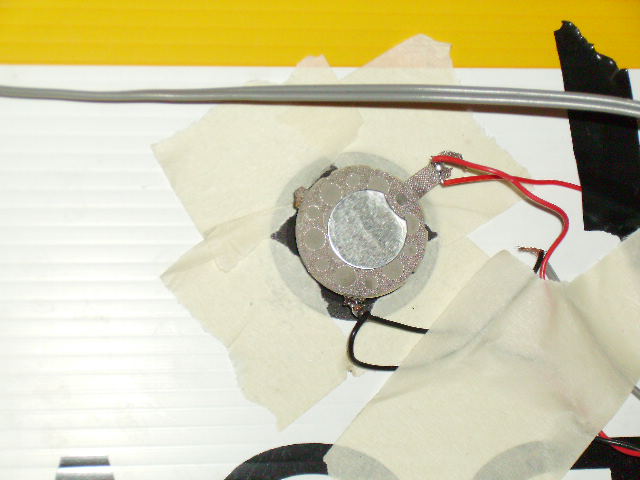

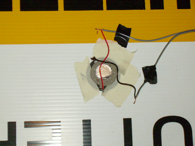

Have been mucking around with a couple of old Motorola piezo elements(dismantled from their casings) - piezo actuator disk and small cone only.
Stuck the small black cones with thin strips pf packing tape to the back of a thin corrugated cardboard panel: 18 inches x 12 inches approximately. Used a small matching transformer from some old Le Son piezo tweeters.
Wow! was I surprised!
on their own in free air sound was reasonable loud but not very ''full sounding''. When stuck to the panel, the sound became louder and deeper. Still needs a woofer to fill in the gap, but I was amazed at the dipole like panel sound that reminded me of the NXT panels I have played around with.
These panels however, produce MUCH MORE high frequencies with lightening speed - and that's just crappy old cardboard

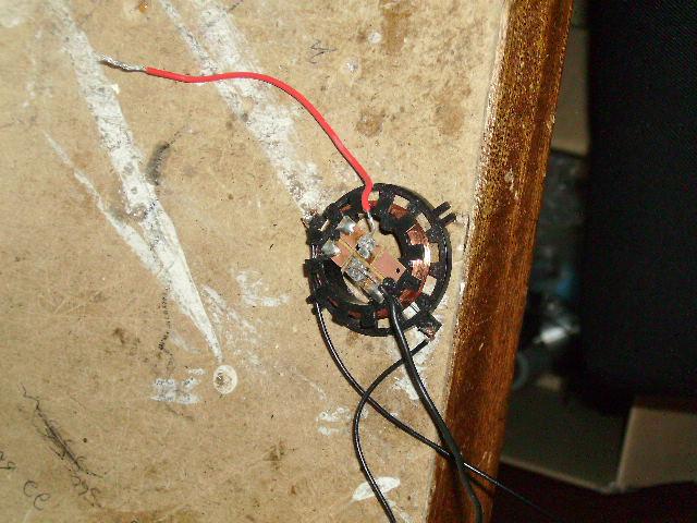

The two piezos are now mounted on a 3mm thick piece of MDF (medium density fibre board : dry wall in U.S ?) 3.5 feet X 2.5 feet. Sound has gotten much louder and deeper again. The high frequencies are still very much audible but I suspect that this is due to the rear radiation of the piezos.
From the front you can tell that the whole board is resonating as one large panel with louder sections where the piezos are mounted from behind.
There does not seem to be the typical ''piezo sound'' that we all know. Perhaps because the transducers are not horn loaded and encased in plastic?
I think there is some potential to this NXT type of implementation providing you have the impedence matching transformer which increases volume dramatically.

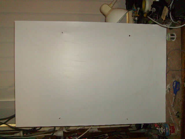

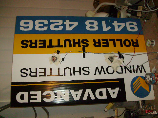

Changed to ''CORE FLUTE'' (corrugated plastic laminate) of around 5mm, 3 foot X 2 foot.
Man, now we're talkin.........two piezo tweeters create this much sound?.........and go this low? You can just feel the entire panel vibrate on voice and guitar/drums.
For those who have frowned upon the idea of NXT panels(including myself), I'm beginning to see where the advantages are : obviously this is only an upper mid(??)/tweeter range, but percussion, piano, guitar sounds AWESOME![hot :hot: :hot:](https://files.diyaudio.com/forums/images/smilies/hot.gif)

At last some replies !!!
I'll try again to post some pictures. May need to compress the images as my last attempt failed.
I think that the coreflute sounds best so far because It is so large compared to everything else I've tried.

As you can see, it's a crude and simple set up
.....but hey, it works as a mid/tweeter panel surprisingly well. BUT.......to get the required output from piezos you MUST HAVE TRANSFORMERS!.
