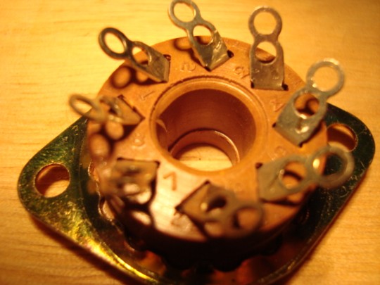

richwalters Member Joined 2003 2009-06-01 10:22 pm #5 2009-06-01 10:22 pm #5 Many IO types have numbers on the tags. Always read from underneath. Attachments dsc01285.jpg 60.4 KB · Views: 323
