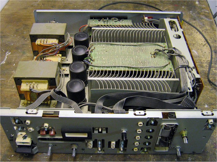

2 trafo's , 2 heatsinks , 2 pair supply caps (in pix).

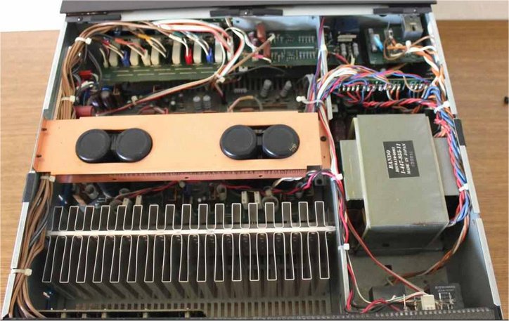

ok! thanx! But further I wonder since today I have to make my decision over ta-f444ES from SONY or the Pioneer A-77X instead! Is the SONY aswell Dual Mono?
Yes ,the sony is ... (below).
But , one trafo/ dual electrical secondary.
While this is theoretically "true" dual mono , A real heavy load on a channel COULD
affect the common magnetic field of the "dual" trafo.

Actually the Pioneer has 3 trafos and seems to inherited something from the legends A-70 and A-80 cousins... It's not an "easy" unity to service though.

This Pioneer is a pure beautty but since I have no grounds to leave this other in the favor of the other one I mean SONY ES over Pioneer I will stick with this one! Thank you guys!
