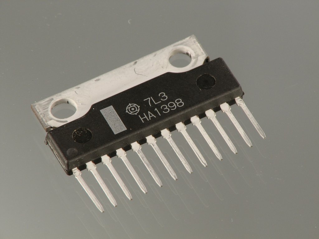

I have a Pioneer KP-500 Supertuner and only one channel has output to the speakers. I'd like to get it working again. I have the service manual but I was wondering if someone on here could identify what to check or replace first.

I'll take a guess at it being the audio amplifier IC. Look up the datasheet for the amplifier IC it uses,and see if there's signal going in to the input pins. If not,the problem is somewhere further back.

Are you talking about checking the input at the AN214 or the HA1137 ?
