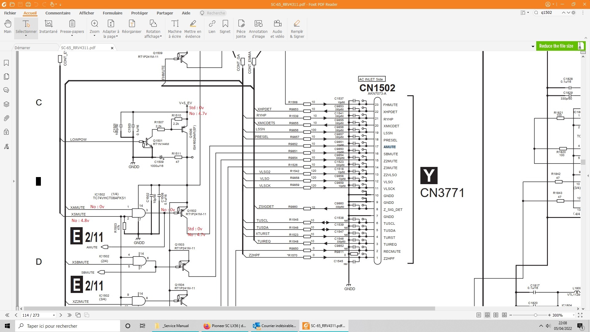

Update : I followed the SM for the SC76, and in the diag flow, they ask to verify the value of "AMUTE signal" on the audio bridge (same bridge on the two amplifier).
And.. Yep, the signal is HIGH on mine, so the signal is muted. But I don't know why.

Yes but already performed..
Attached some measures on IC1502. AMUTE on CN1502 (and next connectors) is High if XAMUTE and/or XSMUTE is low.
In my case, XAMUTE is low, and it is attached to PE7008... So now I need to know why the PE7008 send a low signal (maybe when something is wrong on another parts after a checking...)
