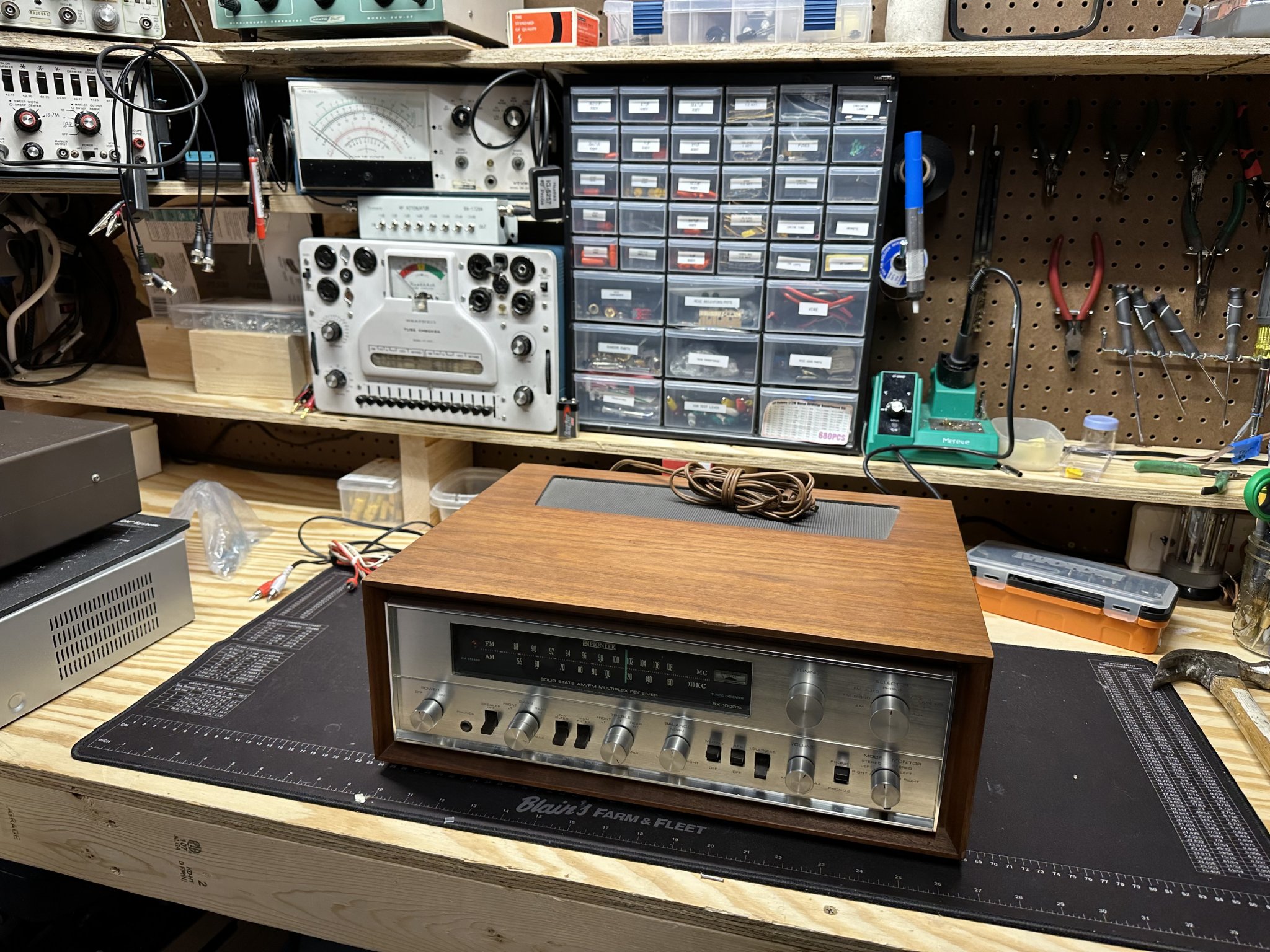

Does anybody have a service manual for this SX-1000TA?
Having an issue. It “works” tuner, phono, aux, tape. But volume is low. Looking to check Bias current.

As a professional tech, I fail to see what bias current has to do with audio level.

I wanted to see if the amplifier circuit is actually fully powered up.As a professional tech, I fail to see what bias current has to do with audio level.

I am going to change all of the electrolytic capacitors either way. Just wanted to troubleshoot it a bit. I’ve replaced all the caps before on systems and found it to not always just fix the issues.Schematic, check for bad low voltage electrolytic coupling capacitors.
There are about seven of them in each channel. Just replace them.
That doesn't make any sense to me.I wanted to see if the amplifier circuit is actually fully powered up.
How will a circuit be partially powered up?
Do you mean a wrong voltage?
Then that stack of equipment is there, and you have the manual.
Also, low volume is the fault with all or just one input?

On the tube amps I normally work on at, when I have a volume issue, the first think I do is check bias current. I’d there is a loading capacity or bad resistor, this will be made clear.How will a circuit be partially powered up?

It’s on all input sources
Where would you start besides the shotgun approach of replacing capacitors?
Already cleaned pots and switches.
Just inject a 1khz Sine wave? And follow the signal path with the scope? Compare amplitude at input to output? Easy enough
Yes, just use AC coupling on the scope, with around 0.1 - 0.5V amplitude into the stereo line inputs.
Don't run it into clipping. Keep the volume set to minimum until you get to the control itself.
Using a triangle waveform makes distortion and clipping easier to see.
Make a point of comparing the input and output nodes of each of the seven coupling capacitors per channel.
