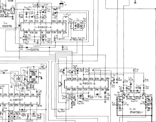

To all vintage enthusiast & FM experts, I had this unit on my bench for a while now.
When I feed the unit (via Variac) 60 VAC the FM band is perfect, low noise, sensitive station tuning even without an antenna.
No stereo light (sound is only present when pressing the mono button).
As soon as I plug it directly to 120 V there is distortion & noise all across the FM (stations are still there but much lower sound quality & garbled).
AM & all other inputs are working fine.
The 76 Khz signal on PA1001A demodulator is present until the a certain voltage threshold then it disappears.
The majority of the elect. capacitors have been replaced, perhaps it is a power supply issue or one or more components that are failing beyond a certain voltage. Looking for other opinions. Thanks

Measure the DC power supply voltages at full AC line, and compare with the service manual info.
Especially look at the voltage regulators.
https://www.hifiengine.com/manual_library/pioneer/sx-680.shtml

There certainly are voltage regulation circuits in the receiver.

In AM mode those chips have no IF signal applied, however the voltages look about right.
My 780 uses the same chips. You may have to scope the IF signal going into the PA3001
It could be a bad capacitor or something starts oscillating at higher supply voltage.
There is a 13.8 v regulator that is a zener and npn transistor. This will be on a small heatsink that will get hot.

Something puzzles me on the FM front end: the voltage on the Drain of the dual gate mosfet is 11.6 V (it supposed to be 10.2 V) & only when I reduce the AC, to obtain such voltage the FM works fine. My analog scope bandwidth is up to 100 Mhz.
The fet may be weak, there may be a jumper or resistor supplying it that can be increased so the voltage there is lower.
Try a 220 ohm where R104 (47 ohm ) is.

Just tested my sx -780, the front end works well from 6 to 18 plus volts. I did not go higher for fear of killing it. The pa1001 and 3001 should not go higher then 13 but will work on less.
The front ends look identical.
Further along you have a npn IF amp mine has a HA1201. If you scope the output from the transformer you should see a clean 10.7mhz sine with fm mod on it.
There is a power wire to the front end that goes on when the selector is on FM. I put power here after pulling the wire leaving the IC's on the 13.5v regulator. The IF amp transistor could be oscillating at full power. This is after T1 which is fed by the 2SC535 mixer.
