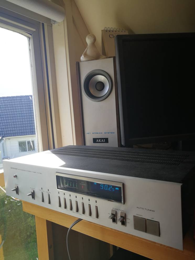

The issue with the unit I got was that FM tuning would be okay for a while, and then would start jumping wildly about (creating a horrendous noise in the process). It would sometimes settle down again for a while then go nuts when you least expect. It would also sometimes take a long time to settle on a station.

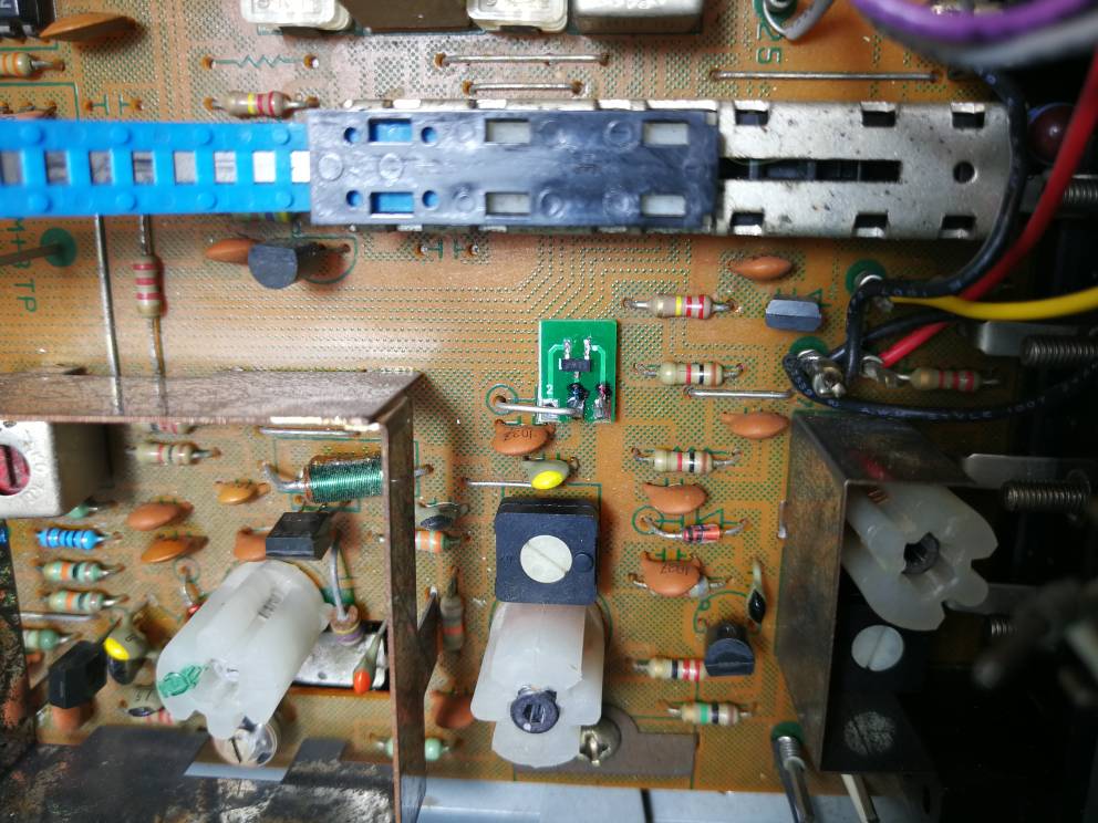

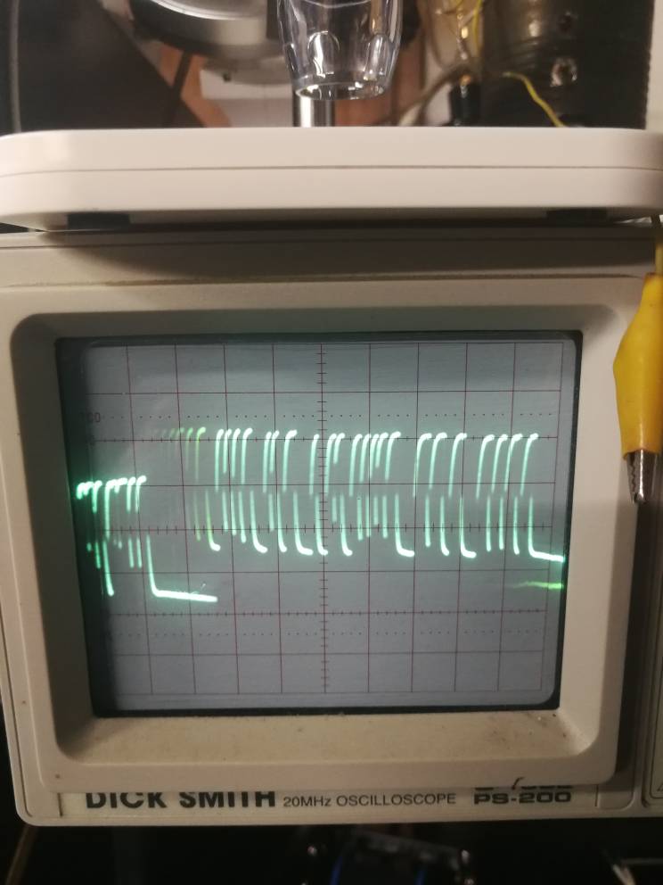

Determined, after a few more red herrings I finally tracked the source to D2, one of the varactor diodes. Take a look at the scope when on the cathode. That's on 200mV/div scale! Something very wrong there. Glad I found the fault at last, but now I need a replacement. The tuner actually works without it, but with reduced signal strength.

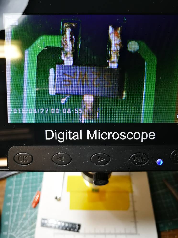

I'm planning to replace the 1sv68 with a BBY40 (on an adapter board). Both data sheets are in this post, it appears to be an equivalent but in SOT-23-3 package. Now, we wait.
