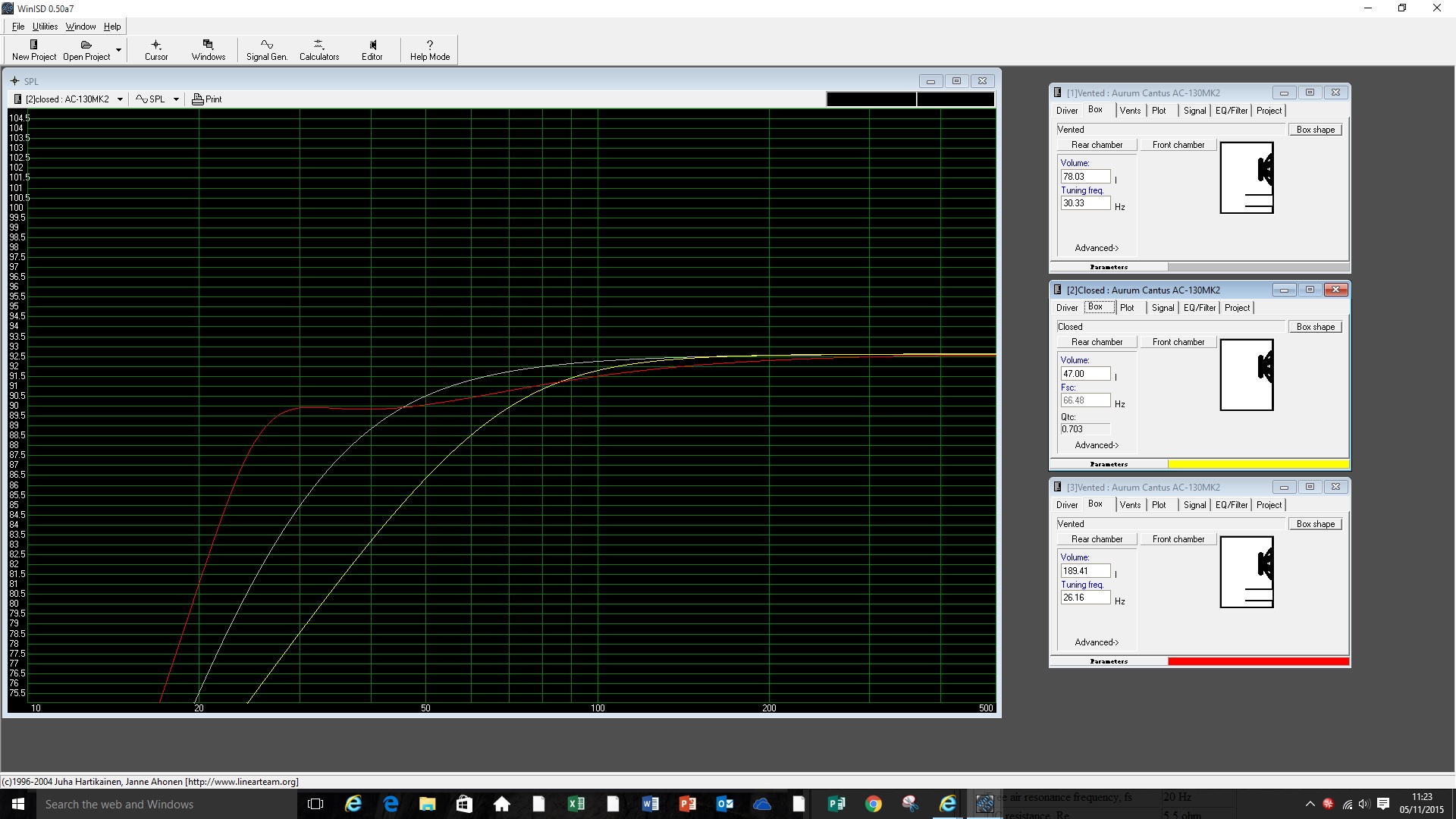

GM
Cory,
If this is your first speaker design attempting arrays of tweeters is very ambitious. One of the advantages of speaker projects is the almost always work to some extent i.e. you will get sound out. However optimising such an array of HF drive units will be very difficult. One limited did a design something like this but they used a DSP to manage the phased array they subsequently sold the IP to Yamaha I believe.
The bass drivers look like they have a good fairly well controlled mid response, I would recommend looking for a good standard tweeter to go with them and create a 2.5 way design.
Small drivers are not ideal for very low frequency solutions as you will need high levels of excursion which will mess up the mid range response. 35Hz will push these drivers very hard. I did a simulation of this driver in the optimum box size (as predicted by the simulator you can often optimise manually better). You can see to get down to 35Hz you will need an extended bass shelf design which will make your bass sound somewhat thin. You could EQ this however the excursion limit of the drivers will be exceeded at fairly low power. It also requires a massive box.
The second graph shows the excursion for 20W input this provide around 100dB of output which is loud but not excessive. As you can see the drivers are on their excursion limit at even this fairly modest power.
If you want to play down to 35Hz or lower you really need a large sub to go with the system.

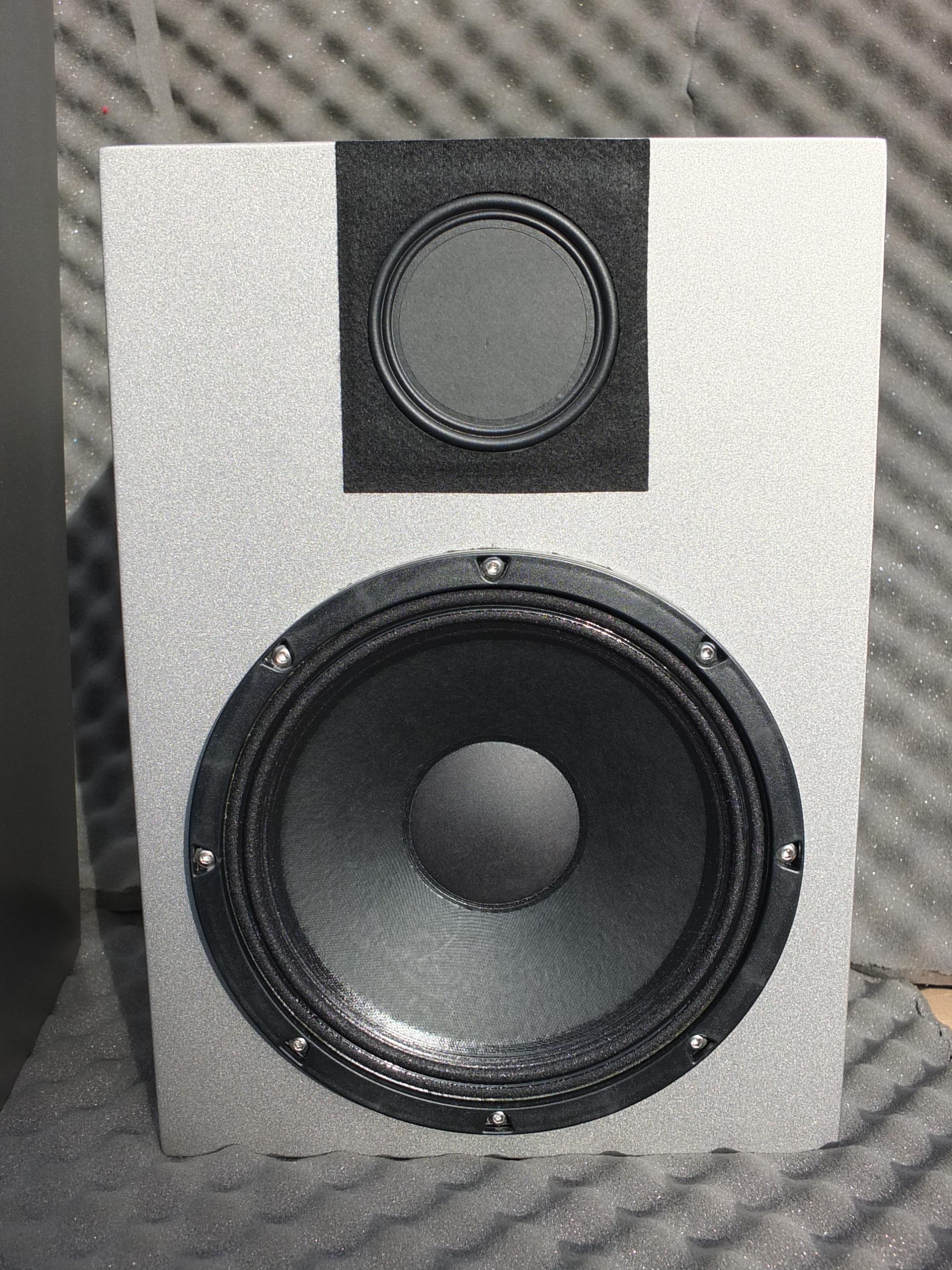

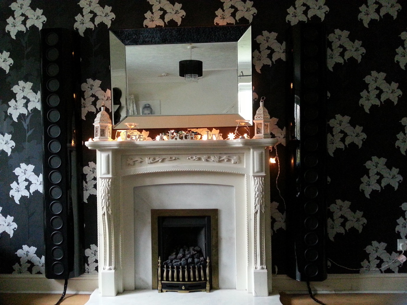

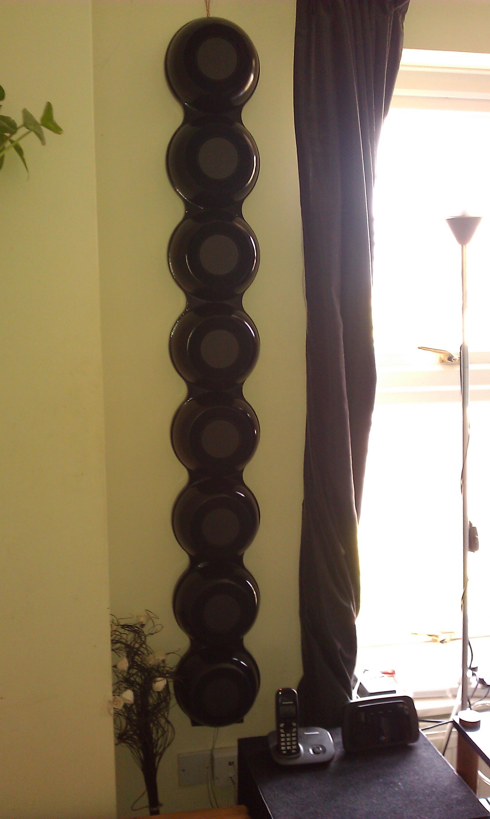

Hi Cory,
I have been developing a range of speaker designs using various commercially available BMR drivers as well as an OEM version using a 4.5 inch (112mm square) chassis and strong Neo motor with a silk surround and treated cotton / linen spider.
BMR's come in all shapes and sizes and just like conventional drivers there are good ones and bad ones!
I have had some great results as well as some disasters so hopefully I can help you avoid the same mistakes!
The attached is a small nearfield studio monitor using our 10 inch bass mid and a single 4.5 inch BMR.
The production versions are really small 312mm by 412mm by 175mm (width height depth) well under a cubic foot external volume and under half a cubic foot (14 litres) internal air volume after internal components.
The performance is staggering in my opinion (biased!) and gob smacking in the opinion of others....I will be doing some demo's of this prototype pair over the next few weeks and some of the DIY guys will no doubt be posting their opinions....!! 😉
My general advice is if you are using the small PE BMR's use lots of them....at least 4 per side, even better with 8 or 16 and build tall shallow cabinets you can hang on the wall.
For the 3 inch (Sd of only 19cm 2?) PE driver in a small room and average listening SPL's here are some suggestions for crossover points to a small bass / mid driver.
Single BMR - Min 400Hz best with 800Hz.
Twin BMR - 300Hz to 500Hz.
Four BMR - 250Hz to 400Hz
Eight BMR - 150Hz to 300Hz.
Sixteen BMR - 80Hz to 200Hz.

Hi Cory,
Major peaks and troughs in a drivers frequency response are never a good thing, but not always a deal breaker.
I believe accurate time domain (CSD plots show time and frequency performance) performance is far more important than an accurate frequency (amplitude) domain performance.
The reason....? Because, in certain circumstances one can fix frequency response errors with Eq, but one can never fix time domain errors....Not even with DSP Servo control systems.
Please see the attached doc which explains my reasoning in a bit more detail.
Re the frequency response of drivers in general and BMR's in particular I have found that Eq can be a great solution or actually cause more harm than good....It all depends on the drivers "power response".
The power response is the term describing how much a driver suffers from "beaming". ie directly on axis the driver might give you a nice even response covering 200 Hz up to say 10KHz, this is good, but off axis, say 30 degrees it might be 10dB down, and by 60 degrees it might be 20dB or 30dB down.
This looks bad on a graph, but is fatal in real rooms due to the dominance of reflected sound in most listening positions.
One exception is in a treated studio environment sitting very close (around 1 meter ear to speaker distance) to near-field monitors, but in most domestic or commercial spaces reflected sound dominates both measurements and subjective sound.
I believe all beaming is bad, even controlled beaming or "controlled directivity" as the marketing dept of horn speakers call it!...Broad even coverage over as wide an area as possible is good!
The Holy Grail being a totally even 180 degree coverage (plus / minus 90 degrees) in both vertical and horizontal planes. This is deemed almost impossible to achieve (until the pulsating Plasma Sphere drivers are invented!) and many loudspeaker designers believe "constant directivity" is the only alternative .....I disagree!
One very important and point which is misunderstood by many designers is that you can not successfully Eq any driver (or combination of drivers) which do not have a very flat power response.
How flat....? Accuracy = to or better than plus / minus 2.5 dB over both vertical and horizontal axis and covering at least a 140 degree (plus minus 70 degree) is required to achieve a balanced sound.
If you Eq a driver(s) on axis that suffers from beaming the already bad off axis performance will be significantly degraded and all the subsequent room reflections will amplify these errors.
I hope I have not rambled on too much some of this makes sense?
The bottom line is that Eq'ing conventional drivers can be problematic in domestic rooms, but is easy with BMR's and produces great results!
All the best
Derek.
