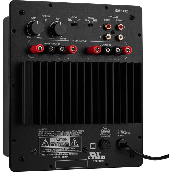

maybe there are exceptions, but in general Plate Amps are designed to effortlessly take internal air pressure and seal it, so no need for dedicated internal chambers, just "cut the hole and mount it", they can share the general volume inside the cabinet with speakers.Looking some advice on whether its worth the extra volume to have a separate internal chamber for a plate amp.

Well, yes,that´s the normal way to mount them: heatsink and connectors on the outside, board/supply/components on the inside.
Commercial plate amps come already mounted on a PLATE
Complete with mounting holes around so it fits in a proper sized cutout, most even with some kind of gasket to seal air leaks and ready to connect, mount and use.
Now the Powersoft product is more of an OEM one, not directly hobbyist or end user friendly, maybe it´s "just that": a populated board and a heatsink (and nothing else) inside a cardboard box, leaving mounting "details" up to end user.
Very different kind of solution, specially for a DIYer.
I suspect/(fear that you´ll have to cut and drill a flat aluminum plate, where you´ll sandwich the board inside, heatsink outside, also using thermal paste between contact surfaces.

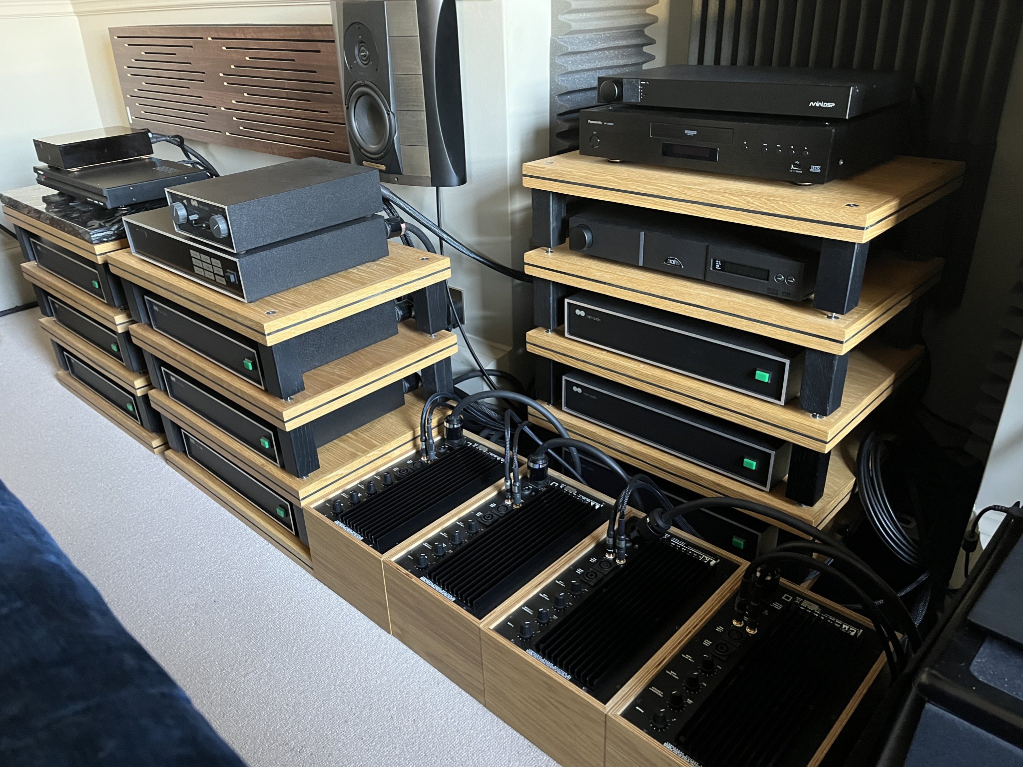

A plate amp inside a speaker is in any case a wrong installation, the correct photograph is above.
