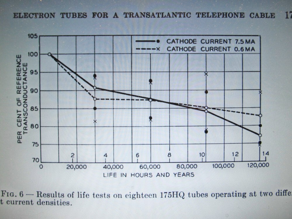

It seems as a tube is used, its transconductance lowers - is this correct ?
However, I can only find one graph of how gm decays with use - which is in this article on page 173.
http://www.alcatel-lucent.com/bstj/vol36-1957/articles/bstj36-1-163.pdf
It seems gm does not decay linearly with use.

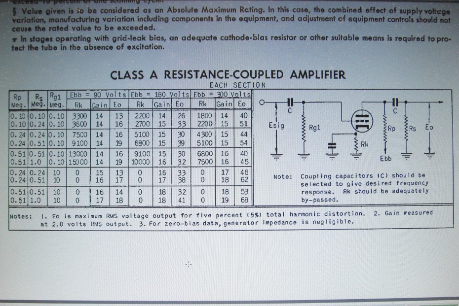

Yes. Your idea is better. In fact testing the tube in the intended circuit is the best way to test a tube. In fact even if yo own a "real" tester this way is still the best.
But even with the above you may still reject some tubes that would work in some circuits. Tubes inside a local feedback loop or cathode followers can work even if they test poorly in the class A amplifier. In fact I've swapped 12AX7 for 12AT7 and don't see any difference in performance in cases there the tube is on a local NFB loop. That said, most of the time the tube, or at least one section of it is NOT in such a circuit.
As for balance in applications like phase splitters. If you care a lot, design in a "balance" adjustment.
Yes, testing the tube in the intended circuit is the best way to test a tube. In fact even if you own a "real" tester this way is still the best.

For a 6sn7, here is the class A resistance coupled amp as shown in the data sheet.

For a tube - here is the only gm decay curve I can find - I've posted it only to show the shape of the curve.
For a 6sn7, the life expectancy would be more in the order of 10,000 hours.
The practical problem with tube testing for life expectancy is this:
Lets agree the when you are at 80% the tube is "on it's way out". But the 80% figure starts from whatever the tube measured when it was new. Do you know what it measured new? Tubes can vary by 20% out of the box. So you might have a brand new tube that measures 80%
So the only way to use this curve is to start a measurement program where you test each tube when new and then again every few hundred hours and look at the SHAPE of the curve and use relative numbers
In case I'm not clear. Lets say you want to measure a block of ice to see what percent of the ice has melted. So it weighs 3 pounds. Now you tell me what fraction of the ice is gone. Hard to do without knowing the starting point
One more thing. Your class-A test circuit is very sensitive test. But some circuits in amps are not. For example unity gain cathode follower might show zero change as the tube ages until one day it just stops working. This is why tube-swapping sometimes fixes a problem. A nearly dead tube would work fine in that spot. So what is the definition of "lifetime"? How many hours it will work in a class A common cathode amp or how many hours it will work in your specific use case?

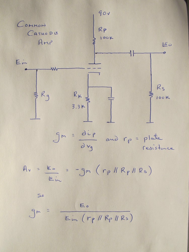

I would like to have some method of measuring the state of a vintage twin triode.
Referring back to the Class A resistance coupled amp from the data sheet,
this is a common cathode amp with the cathode resistor bypassed.
I think the equation for Av is correct. Certainly, from an AC point of view, Rp and Rs are in parallel.
However, the problem from measuring gm from this circuit, is the wide range in a tube's plate resistance.
For example, my RCA data book says for a 6sn7, rp min and max is 6.7K to 7.7K ohms.
Unfortunately, rp dominates the other resistor values.
How about using a new Sovtek tube in this circuit and then comparing it to the vintage tube in question ?

gm and plate resistance are related: Rp = mu / gmUunderhill said:However, the problem from measuring gm from this circuit, is the wide range in a tube's plate resistance.
Measure any two of these and you can calculate the third. You could measure Rp by varying Rs in your circuit and seeing how gain varies. Then, knowing Rp, you can calculate gm from your results.
