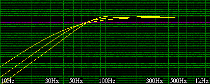

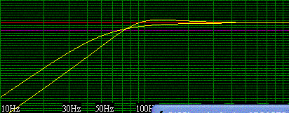

F3 is the -3dB point of the filter, the point where the power is halved.
For speakers usually F6, the -6dB point is regarded as the bass cut-off.
(Its also relevant for linkwitz-riley crossover alignments)
For subwoofers using room gain, F10 the -10dB point is very relevant.
In electrical filters F3 is nearly always regarded as the cutoff
point of the filter. Consequently F3 is still used to compare
different bass alignments of a speaker, though as suggested
above its probably not the best parameter to use.
With a typical driver and sealed box F3 is not an issue over
the Q range 0.5 to 0.9 as the attached plot shows, 0.7 is
also included. note that 0.5 needed 70 litres whilst 0.9 only
needed 14.5 litres. 0.7 needed 24 litres.
The purple line is F3.
But look at the differences in F6 and F10.
🙂 sreten.
