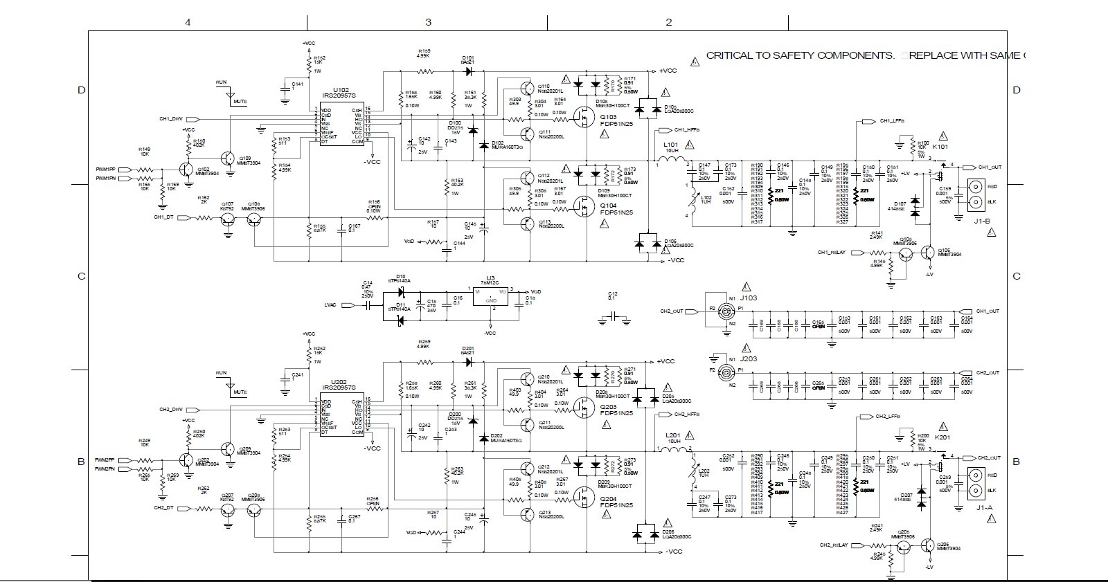

I just looked at the schematic... this is not quite what I expected tbh its not diy friendly unfortunately.
This is a complex uP controlled amp with smps and Class D output stages. Fault finding is going to be complex and involved and would need a very methodical approach to see whether the power supply is OK and the problem elsewhere or whether it is purely a power supply fault. Much of the power supply is live at all times which is a real safety issue unless you are familiar with correct working practice for these.

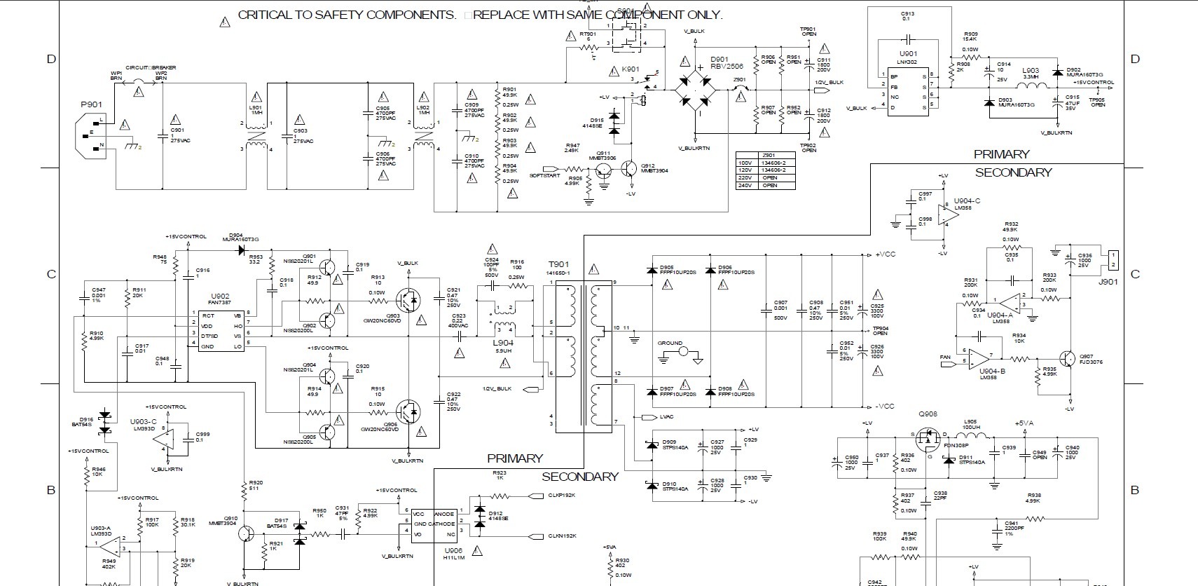

I assume we're talking about RT901 in the drawing, yes? The relay contacts short it out after inrush so it doesn't impede current delivery.
So, if it gets hot and stays hot then the relay is never shorting it out. Does the relay click a few seconds after power-on? If yes, you might have burned contacts in the relay itself.
And to be clear, downstream of any burned contacts you're likely to find the real problem. Again, not a rookie job, this one...

Thanks for the advice. Yes it is RT901, gets hot to the point that you can smell it, removed from the circuit it's shorted. Turning on the amp, no clicks, no fan, nothing. Not a beginner but definitely no expert, which is the reason I'm posting here. The amp didn't cost me anything, I took it as a project but definitely over my head, nothing like working on the older amps.Agree this is not a beginner repair.
