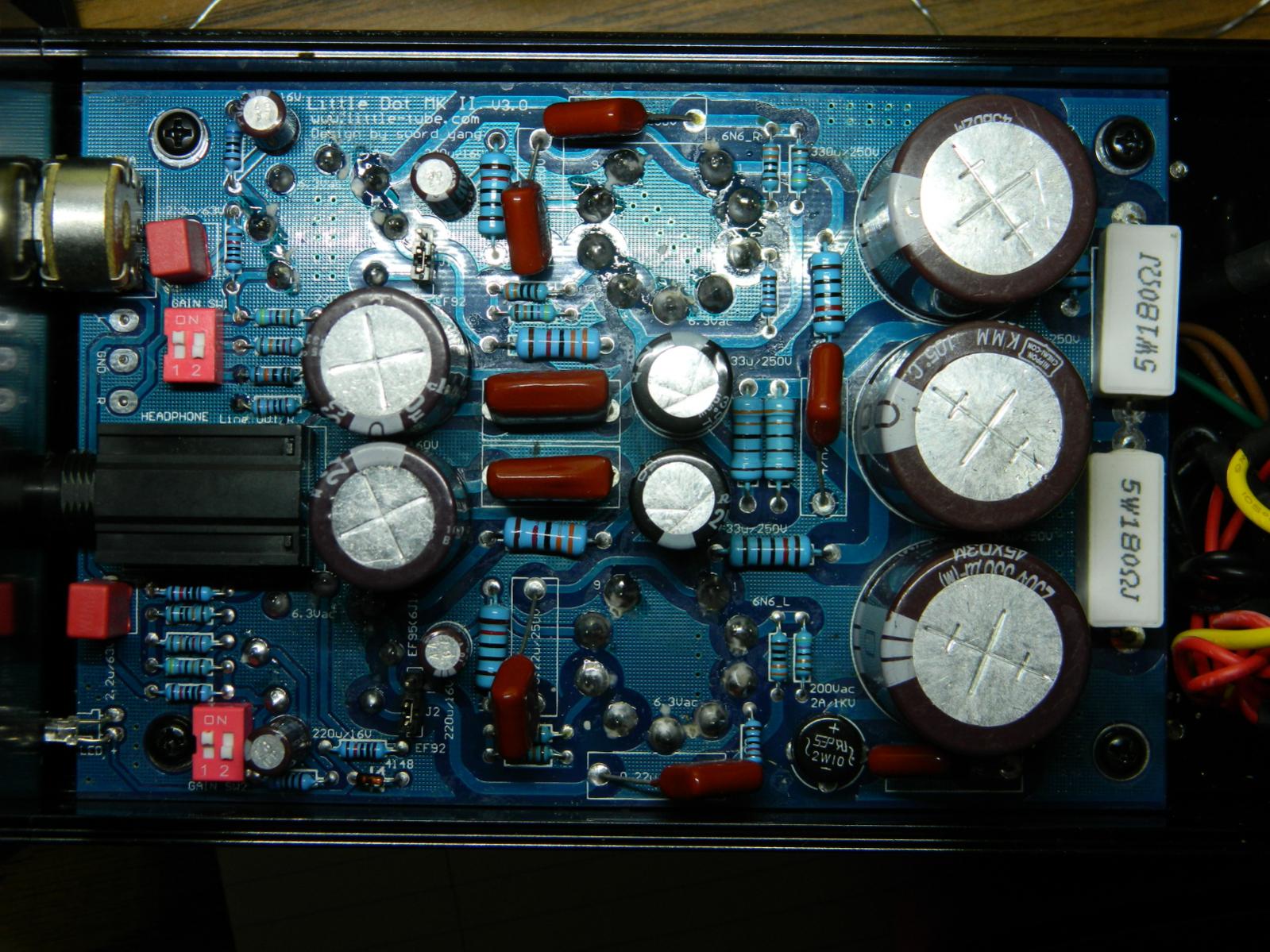

I have bought a little dot mk2 tube amplifier for my HD6XX about 1 1/2 years back. It has 4 gain settings that can be changed by jumpers inside. It sounds wonderful but it does have this annoying noise which I cannot figure out where it is coming from. I tried moving from the electrical outlet to another, isolating it from ground, changing tubes, keeping it away from other devices, etc and nothing helps. It is worse at night. However, the gain stage 4 which is the lowest it is almost inaudible unless you listen to it in silent passages. Other gain stages it is there and at gain stage 4 it is very audible. This however is worst on small IEM's and low impedance headphones including monk plus. HD6XX is the least effected headphone I have from this noise/hum.
Could this be something wrong with my A/C supply from the grid?, I checked the polarity as well and everything seemed to be in order. I will upload sound samples with the hum along with this post. Please let me know what you think it is according to hum. Could it be filter capacitors?

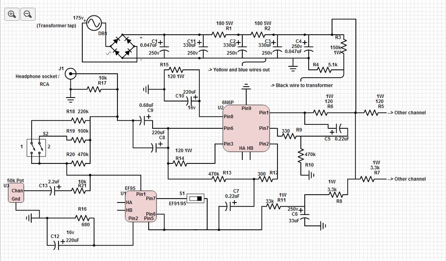

I think you just have a little capacitive pickup on the input. Could be something external or from the heater supply. Does it go if you ground the input. Does it disappear immediately when you turn the power to the unit off but before the HT has time to collapse. Could you include the heater supply in your schematic.
#1. Yes sir! it does go off immediately after switching off the amplifier. Even if i disconnect the power chord it goes off immediately (The tubes are still glowing and the sound is slowly playing and fading away)
#2. It does get minimize to inaudible level if I connect the preamp outputs to another small power amplifier or something while using LD MKII as a headphone amplifier to HD6XX.
I also found out a post and here are the text from it. I don't understand much of but someone with LD MK1 amplifier fixed this problem by doing this.
Right now I am searching the internet for heater supply schematics.
"soo, i finally got to fix this problem.
i followed a hint from a comment on amazon, regarding the heater filament wiring of the tubes.
then i desoldered the wires on one of the tubes, twisted them nicely around eachother and resoldered them.
this helped a bit, but the humming was still quite audible.
i kept on researching the topic of correct heater filament wiring between tubes, and found out about the so called "artificial center tap".
this "artificial center tap" is built by soldering one 100Ohms resistor to each of the wires. those resistors have to be connected to ground later on.
i did exactly that. After i was done the humming was almost non audible. i hope this can help others who have the same issue."

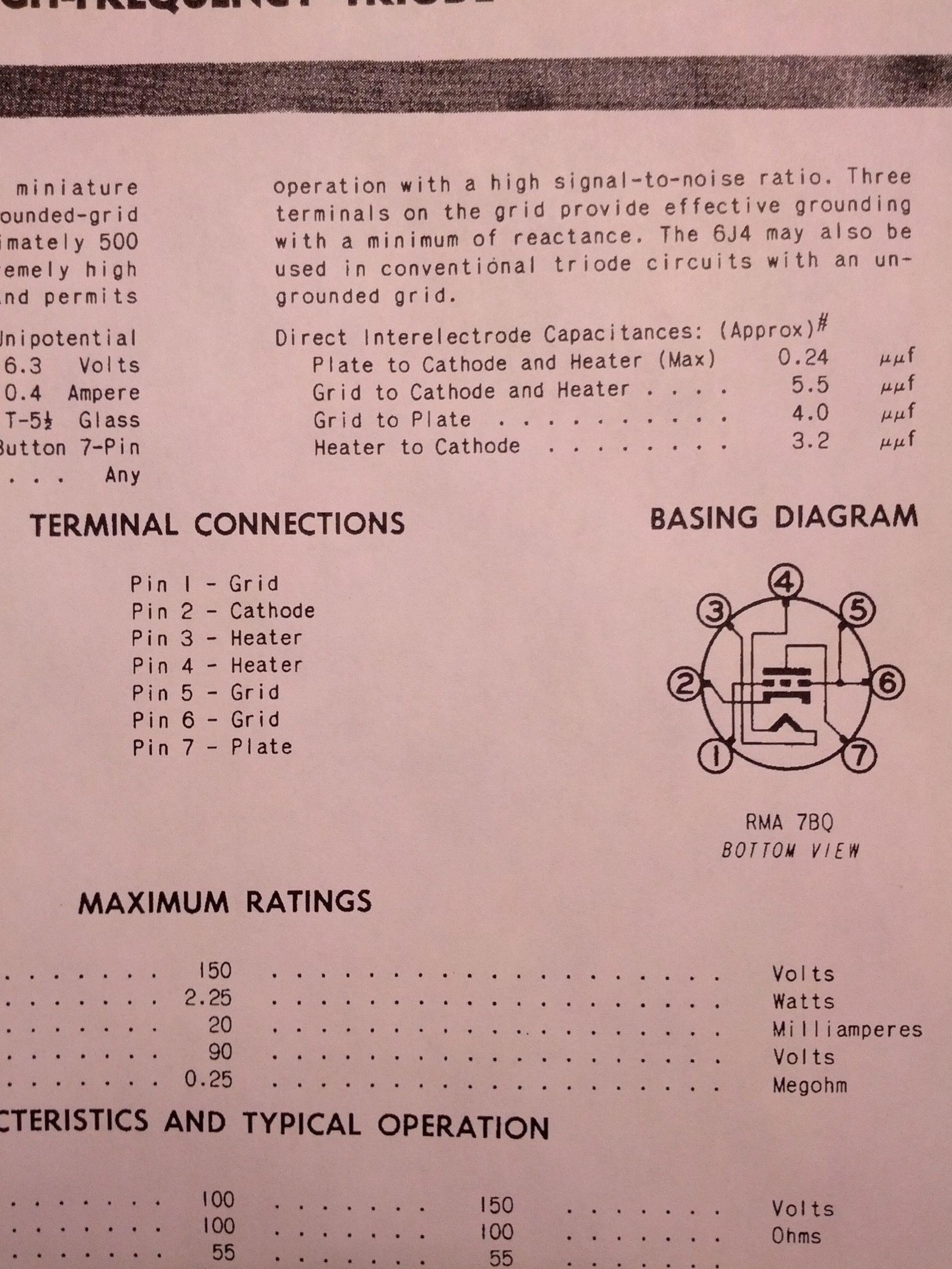

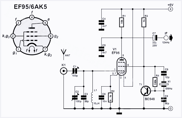

By the way, this is all I found when I search as schematics for EF95.
I am not an electronics professional but I can solder. If soldering 100ohm resistors to each cable that connects to heater filament and The other end to ground, I can do it. I just want to make sure I got this right...!
Hi nofacemonster,
You can use pins 3 and 4 and place a resistor from both pins to ground.
Alternatively you can elevate the filaments from ground. This means you don’t connect the resistors to ground, but to a positive voltage (lower than max. Grid-Cathode voltage), say for example 30 volts.
Read more on this topic so you will know what you’re doing, before you actually try this.
Regards, Gerrit
Regards, Gerrit
Sir...! One single question remains. Should I do this to all the four tubes or just the Gain preamp tubes? 6J1 (EF95) family is the gain tube, and 6N6 (6H6P) are the power tubes. I think i will be able to solder one resistor to 3 and then 4 then both other ends connect to the ground. I will definitely read up on this topic musch further before trying anything by myself. I am not an electronics expert but I gotta do this somehow otherwise it is really annoying with the buzz.
You do know the EF95 is an RF amplifier valve specially designed to amplify RF signals ?
Its designed that way , I have several in one of my old UK ex-WD communications receivers and a good job it does under those design conditions.
Its listed in Mullard,s own industrial guide as - SQ /industrial receiving valve.
Also used in VHF communication.
