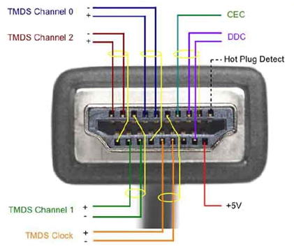

I would experiment with the Hot Plug Detect Pin 19 or the +5V pin 18.
Let both outputs connected and interrupt pin 18 or 19 and see what happens.

When connected (or re-connecting) any HDMI device, a 5v dc from the source is powering a chip in the sink device "HPD" (hot plug detect, for everyone here is not familiar with these abbriviations, nothing personal).
This chip then is requested to offer a HDCP license key to the source. This needs to be done within a few seconds otherwise no image will be shown (snow/ encrypted).
In order to switch between outputs you will have to switch the 5v as well to initiate a new HPD.

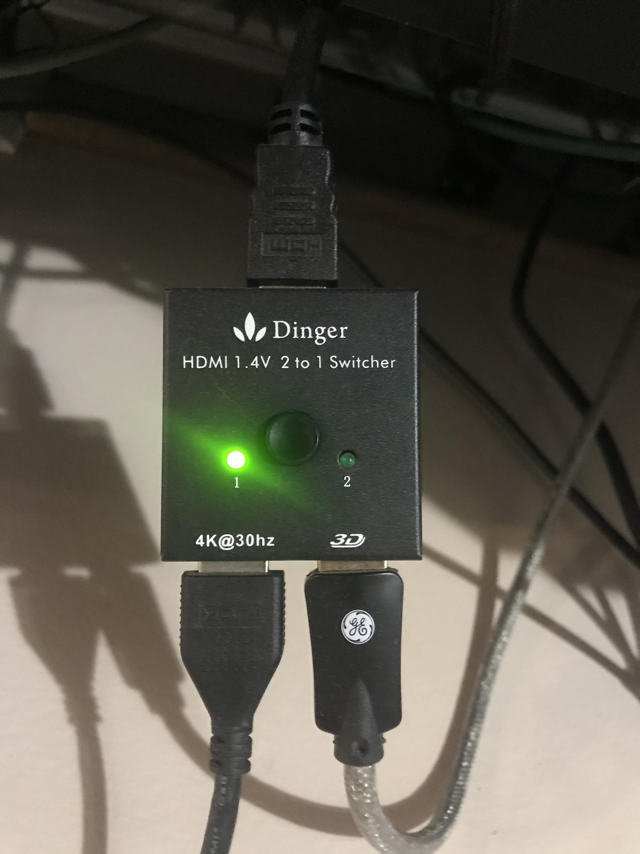

In an attempt to certify what I have and what I want.
I want to replace the little box in this image. I’m using it as follows.
Input on top. Outputs on the bottom. You could flip it - two in; one out.
LH output to TV’s HDMI 1 input
RH output to one of the SSP’s HDMI inputs. SSP output to TV’s HDMI 2.
Pressing the button directs the signal to one output or the other. I don’t know if it directs just the 5V or everything.
Before deploying the switch, I would unplug one HDMI and plug-in the the other. Crude but effective.

So what you need is something that pushes the button, right?
This can be triggered by the 5V from your SSP when you power this up (someone needs to modify this switch to make it happen).
All other solutions are not cheap !

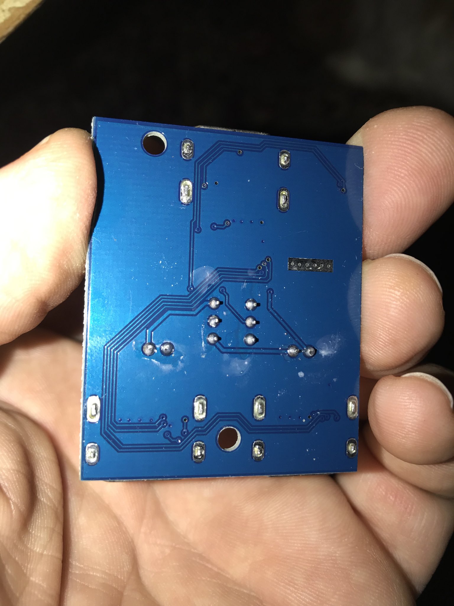

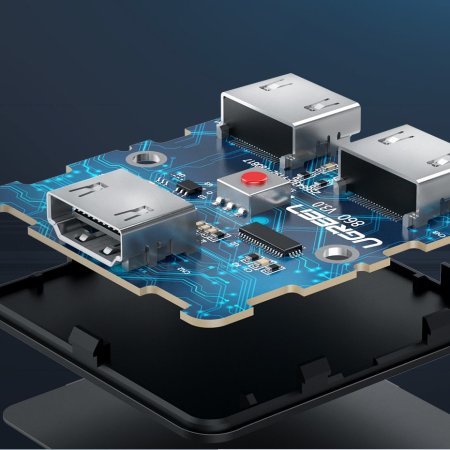

Finally got around to updating y’all...
Got another of these:
https://m.pt.aliexpress.com/item/10...V2N_tCh0PoAibEAkYBiABEgK4HPD_BwE&gclsrc=aw.ds
Nearly identical to the one I’m using. I was pleasantly surprised to discover they’re both in a metal case held together w/screws.
When I clear a (work) space in my storage bldg/man cave, I’ll begin the “hacking.”
Meanwhile a big thanks for everyone’s input. Tony

I have scraped out a work space, desk, modest sound system, and all.Hello 👋
Tony
at first glance, the above switch appears to use electronic switching - the 5V mentioned in an earlier post.
So if I can hack it to default the switch’s output to say, output 2;
switches to output 1 when I fire up my pre/pro, I’ll be a very happy camper
