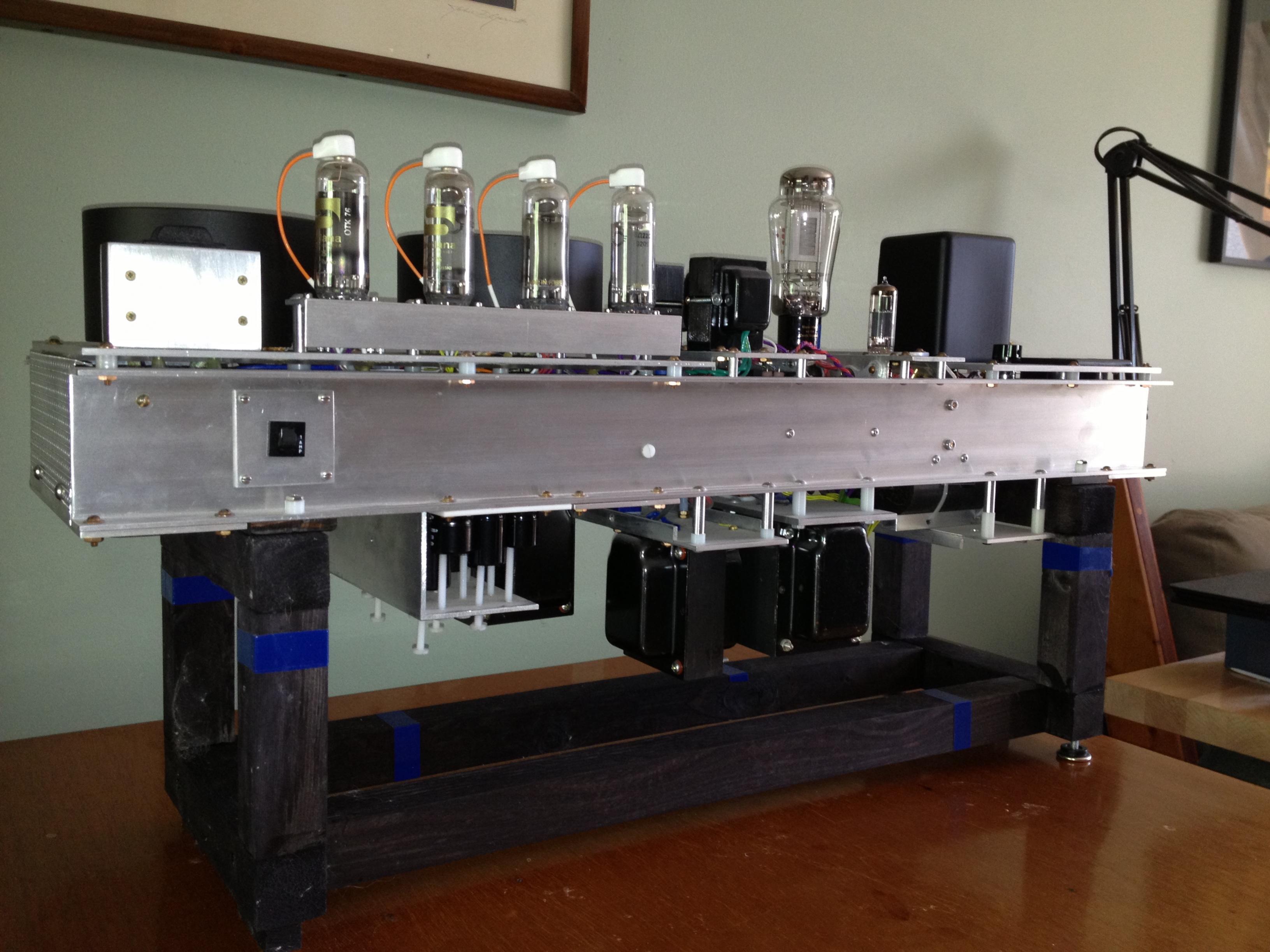

Here is a photo of his amplifiers with EML45's along with the James. they are quite large taking up a space nearly 3ft by 3ft. We used a pair of torrid power transformers in parallel to help with the 6D22 heater currents we also paralleled the HV secondaries.

Finally was able to get at this image of jdg123's BOS46's as they are named.
jdg123 built these in what I like to think of a 1930's style.
Surprising how quite they are for being so large.
Most of the iron is underneath.
Plitron's to the left.

[/URL]Thanks, but the real credit goes to jdg123 for the build I was the circuit designer which BTW is not a classical design. He used a jewelers saw for most of his metal fabrication. The warm glow is the LED cathode biasing of a 12BH7.
Oh, nobody really wants the schematic because nobody’s going to drop $2k in (even if you bought all Hammond) iron on something they’ve never heard. And there is no way around the iron if you want to build this amp, it is all about the iron 🙂

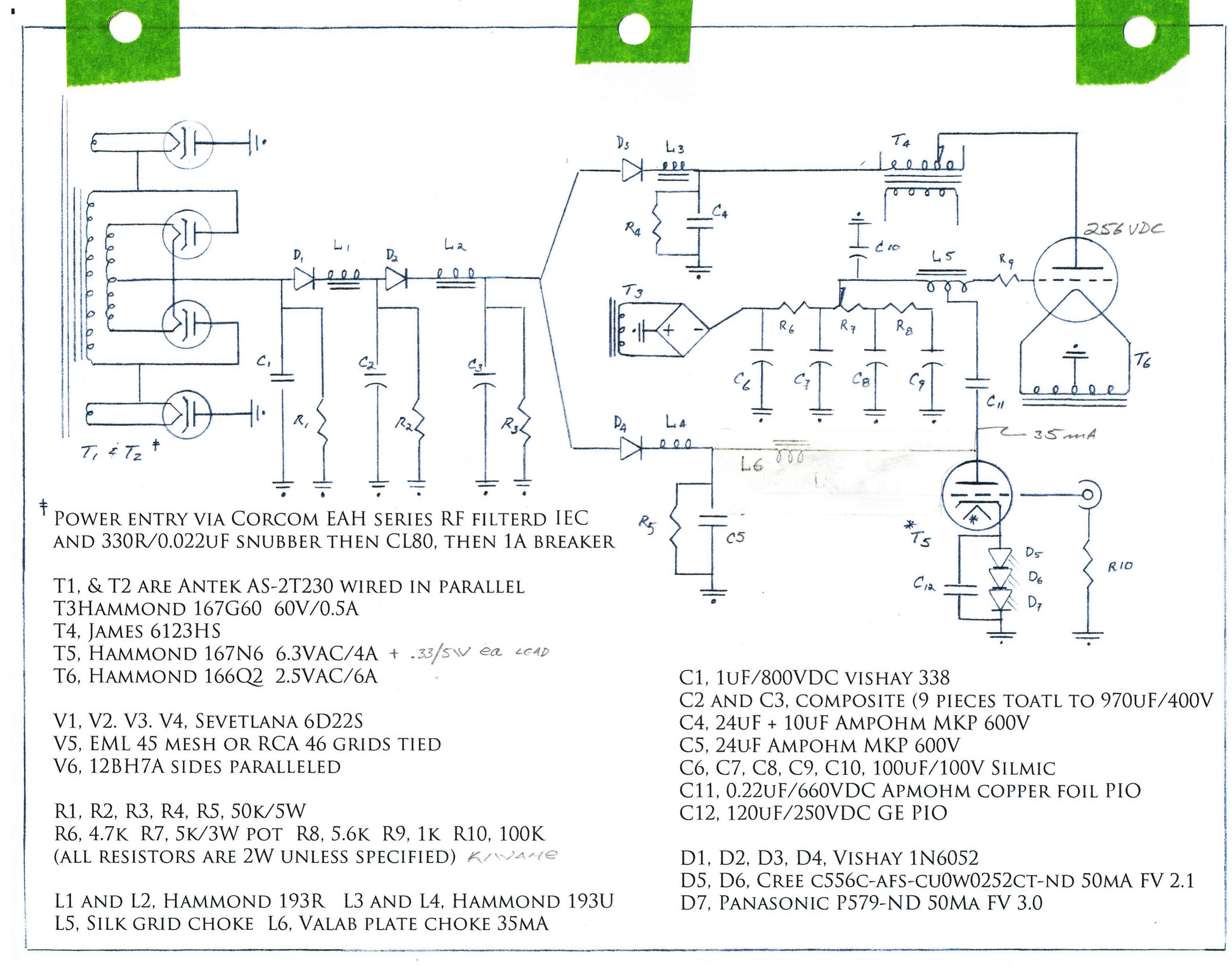

Heck, i'd just want to see the schematic purely out of curiosity -- it loops good in real life. Now I wouldn't understand the math or theroy behind it all, but it must be awesome to see nothing but one resistor and one capacitor in the signal path and all the iron on paper.

BOS 46
Alright Shef, it is just hand drawn and needs some corrections like the value on the bias depends on the tube, 35mA for 45 and 22mA for the 46, L6 is smudged but you can still see the connection, the James OTX is now Plitron... there may be others. I keep thinking I'll get around to making a better version but the basics are there.
Cheers and happy New Year!🙂
