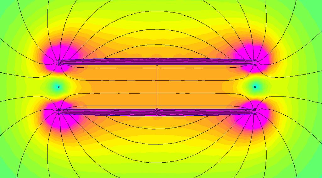

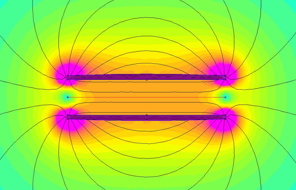

Here is a finite element analysis simulation of a horizontal cross section of such a ribbon:
The two sheets of neodymium look like thin bar magnets in this image because it is a cross section. To understand this diagram imagine that you took a 2 meter tall, 4" wide ribbon, cut it in half and are looking at the cut from the ceiling. The thin horizontal red line denotes a plane where the ribbon surface would be situated. Here is a magnetic field magnitude plot through that red line:
As you can see it is possible to create a wide region where field strength is uniform to a very large degree. This ensures that the entire surface of the ribbon is driven uniformly ( in this example using 4" wide neodymium sheets a ribbon of about 2.5" width would be uniformly driven ) ensuring minimum flex possible and therefore minimum amount of related distortions.

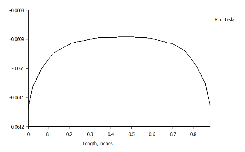

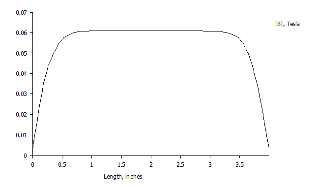

Observe now field uniformity along a different axis:
The thin red vertical line here represents the range of motion of the ribbon. Here is the corresponding plot of the normal ( perpendicular, or effective ) field intensity along that line:
Uniformity in this plot is by far more important than in the previous one because any nonlinearity here will DIRECTLY translate into distortion. The graph doesn't seem particularly flat until you look at the scale to the left. 100*(0.0611 - 0.0609)/0.0611 = 0.3% The maximum deviation of normal ( perpendicular ) field intensity throughout the ONE INCH of peak mechanical excursion range is only 0.3% ! ! ! This linearity of 99.7% would in itself be impressive but in normal operation the excursion of the ribbon will be of course much smaller. The flat and symmetrical plateau in the middle of this curve means B field will be approximately 99.99% linear for normal range of excursions ! ! !
This number means the technology is theoretically capable of distortions as low or lower than the best audio amplifiers. But most importantly the inherent symmetry of the curve ensures that as excursion decreases nonlinearity tends towards zero.

May I ask a question? From the field line diagrams, I can only assume that a current carrying element -the ribbon - passes into the plane of the diagrams of the B field analysis? Another way to think of the design is that the ribbon sits within the field that would exist inside a hollow magnet. Am I correct?
You certainly get a superb uniformity. The overall field strength (as shown in the simulated configutation) is only a small fraction of what could be achieved with the same NdFeB magnets in the more common gap designs. However, I don't know what the field strength is like in systems such as the Magnepan speakers (no Neo magnets there, and wide spacings) so perhaps this configuration could be rather promising if sufficient BL product can be devised.
the ribbon is where the thin red line is :

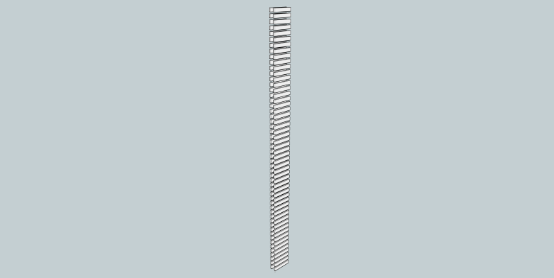

in a 3D view it would be like this ( diagram by NeoDan from another forum )
so in this diagram you see two arrays of neodymium bar magnets. and the ribbon element would go right between the two arrays.

compared to a regular ribbon which, admittedly, would have a much stronger field, my driver would have much larger surface area because it is able to create a field across a wide ribbon.
in a conventional ribbon as you try to make it wider the field strength drops dramatically. so much so that perhaps 99% of all ribbons stay at or below 1" wide. but in PLUR there is no strong relationship between ribbon width and field strength.
field does get a tiny bit weaker in the middle of the gap and stronger at the edges ( thats why in my simulation my magnet is about 5% thicker in the middle than on the sides ) but this effect is very minor. in other words unlike in a conventional ribbon you could double the ribbon width and lose very little field, maybe 5%. you can make it as wide as you want basically. you can make it a foot wide. and doubling the width automatically gives you extra 6db of output. so compared to a conventional ribbon PLUR can use its width to compensate for weaker field to bring output back up.
Ah, OK, so the ribbon is seen edge on, with the current "vector" perpendicular to the plane of the diagram. The extended design is a vertical slatted array of magnets, within which the ribbon is suspended. I understand better now - thanks for the clarification.
I wonder how your efficiency and frequency response will work out, since driving force is proportional to current, and the increased area raises the mass of the ribbon element. Also, the wide ribbon will have a very low DC resistance and overall impedance, so a matching transformer would seem necessary.
Please do not take my comments as destructive - This is an interesting design, and there is a lot to consider in its implementation!
