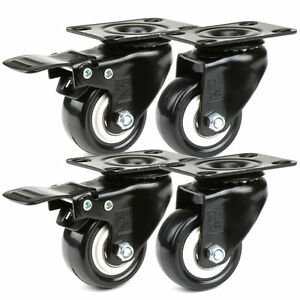

And some heavy duty castors!Just put PA handles on the bass bins.
