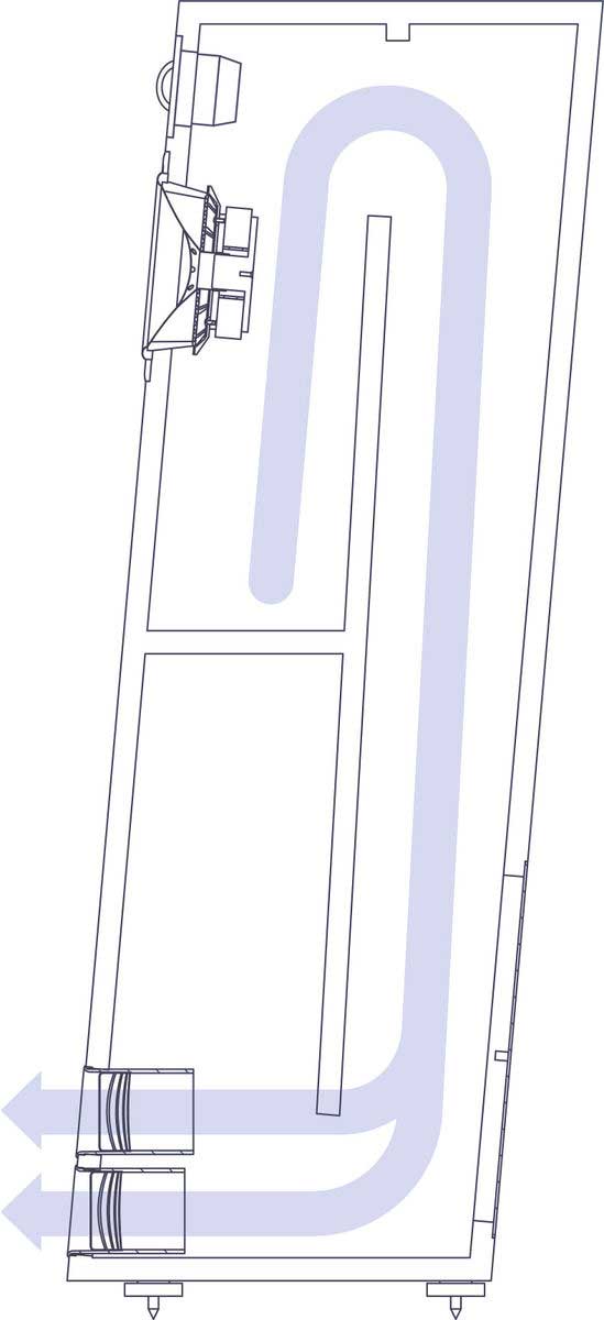

Few month ago I discovered the PMC twenty5 range and especially there tower speaker (23i, 24i and 26i). 2 way speakers MLTL type. Completely amazed by the design (and their price), I’m serching for a way to make an inspired version of those speakers, especially the 24i tower speakers.

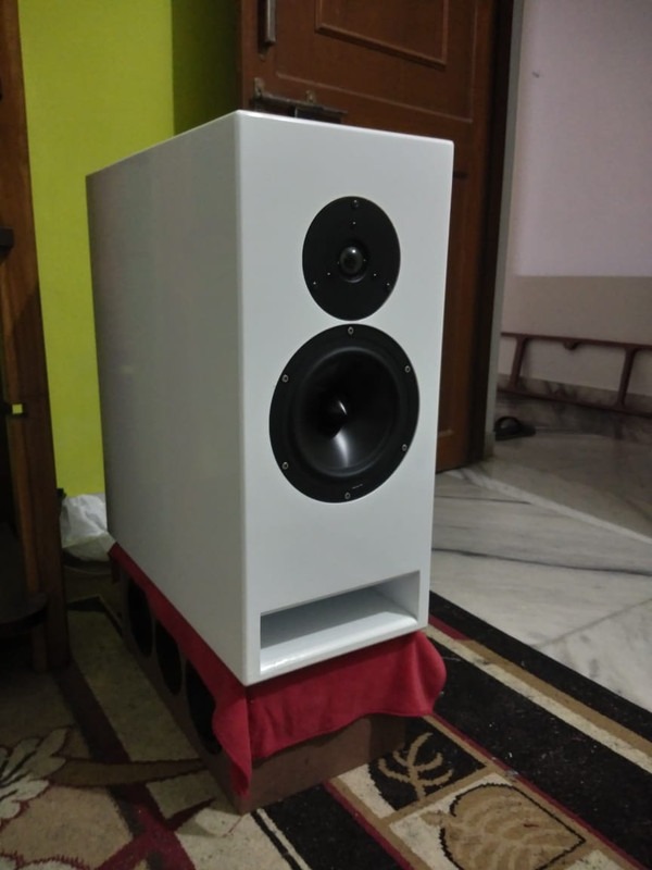

I have a PMC TL homage here:

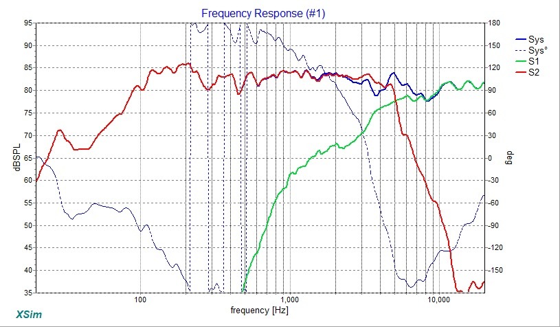

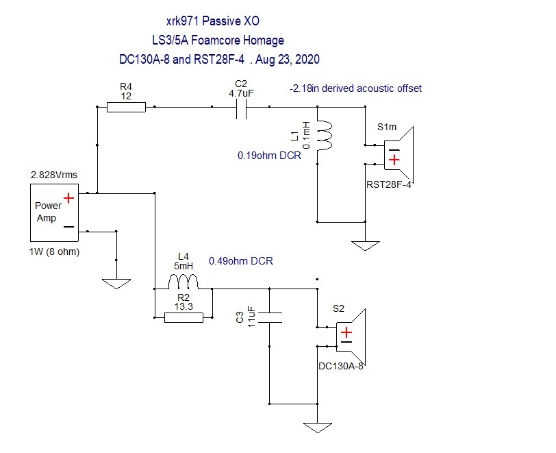

I recently developed a 2 way using the DC130A-8 with the RST28F and have a nice passive crossover design for it. It sounds wonderful. I would suggest the crossover and drivers from this speaker:
https://www.diyaudio.com/community/threads/rst28f-and-dc130a-foamcore-homage-to-ls3-5a.359176/
So basically, this crossover:

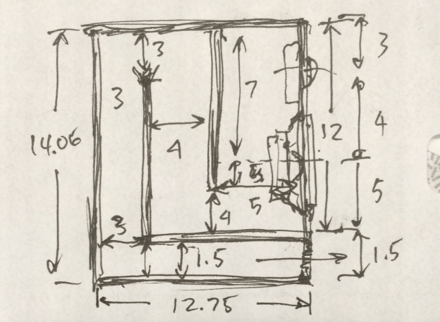

In this cabinet:
It would resemble something like this:
The bass is incredible. Very articulate and deep for a 5.25in woofer.

There are plenty of TL plans on DIYA - mostly in full range forum or subwoofer forum. I have not seen too many that are similar to a tapered TL for a 2 way like what PMC did though besides what I have done. I also have one for the 6.5in Purifi in a TW and an MTM tapered TL.
Largely because an MLTL does more or less the same job with in most instances a physically simpler enclosure, assuming the object is LF reinforcement; if flat impedance is the goal, then that is (to a point) another matter. Since a tapered TL is inherently mass loaded, you can achieve similar results with a high taper ratio. You may want to have a look at the Tritrix TL and its Triune TL predecessor, which are popular and quite inexpensive (the former being available in kit form from Partsexpress for those in the US):
