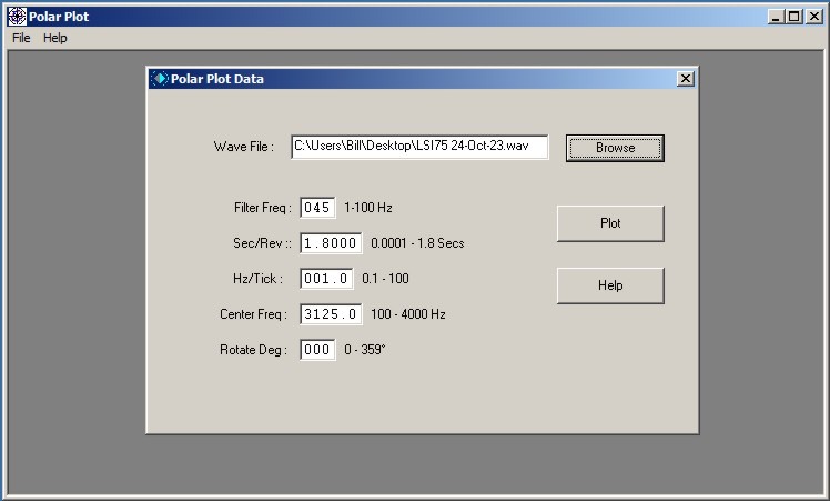

3. Added a direct W&F measurement (2-Sigma method) and display the results on the plot.
4. Created a simple Visual Basic app that allows the user to load the .wav file and set the parameters.
5. A "rotate" parameter to realign the output with previous plots to make comparisons easier.

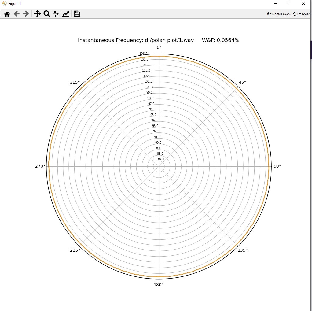

Below is a plot I made from a prototype direct drive turntable taken directly from the optical encoder attached to the platter. The Hz/Tick value is 1Hz where the normal resolution on Scott's version was 3Hz, so it is 3x more sensitive.

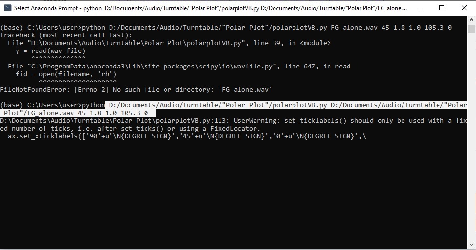

Ok Got it working I downloaded and installed Anaconda. And finally worked out you need to add the full path for the .py script then the .wav file

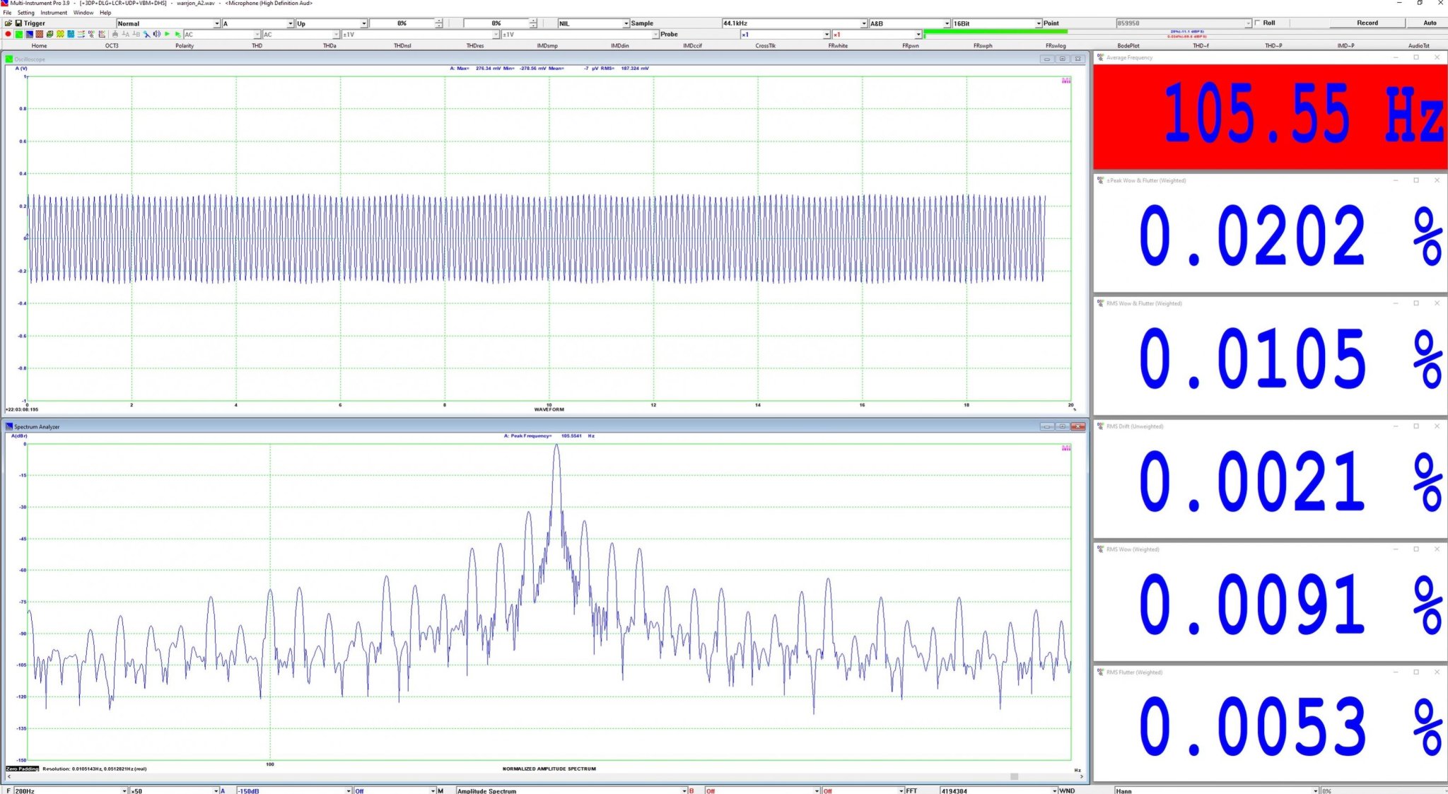

At 3kHz the settling of the filter doesn’t cause an issue. At 100Hz it does. You’ll see a similar issue with MI at the beginning and end of the signal if you look at the FM demod in the time domain.

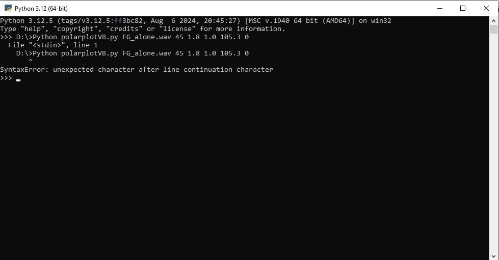

You are typing Windows command shell syntax to a Python REPL!! To just run a python file don't enter the python REPL, just run from the commandline, as in
"python polarplotVB.py FG_alone.wav".
Just typing "python" enters the REPL, from which you can type python code directly.
