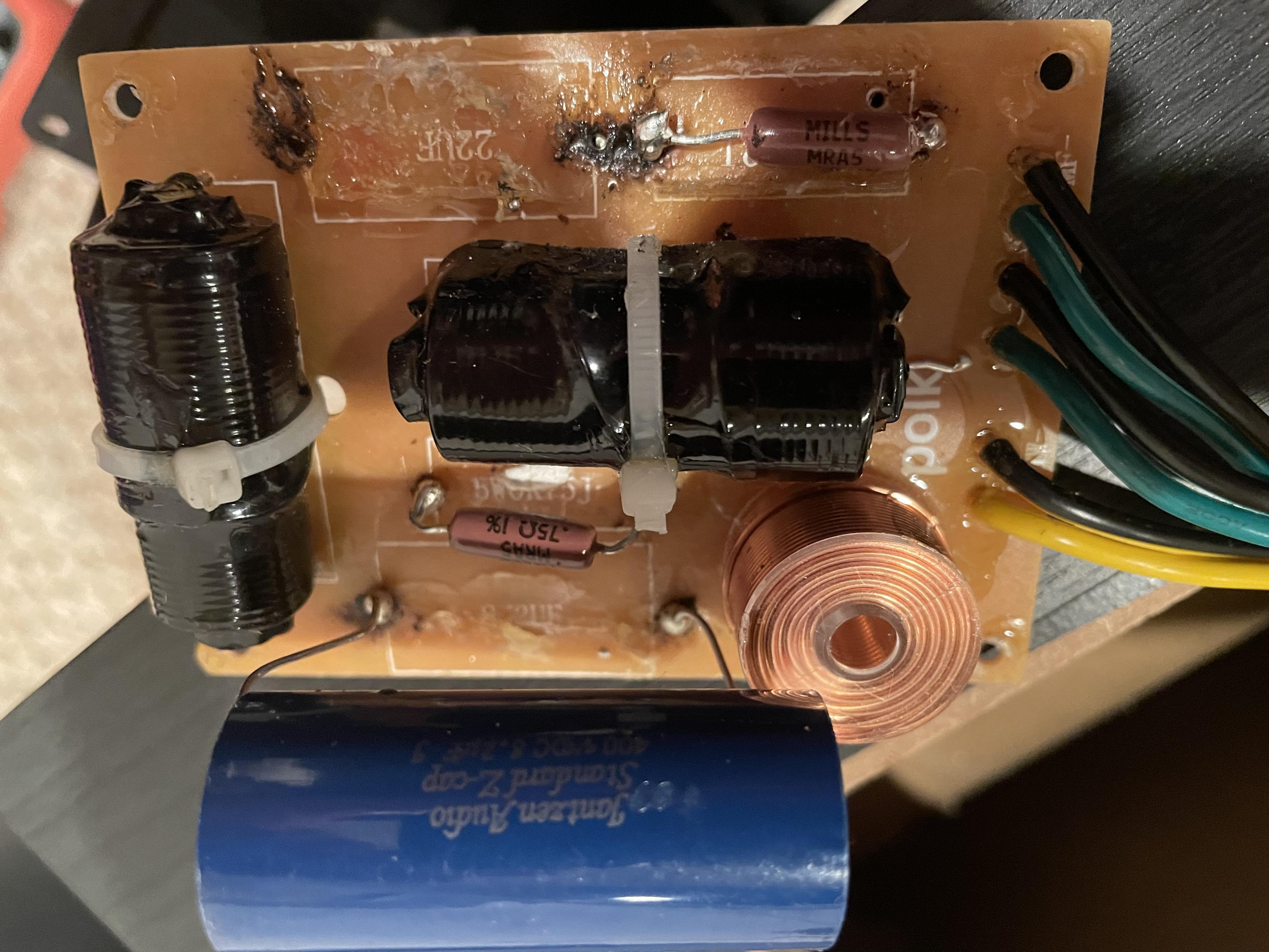

I'm looking for a little help concerning the crossovers in my Polk Audio S55 speakers. I recently purchased replacement caps and resistors and would like to point-to-point wire the crossover with the new parts. (The board has some damage.) However, I don't feel comfortable reverse-engineering the crossover schematic for fear of doing it incorrectly. I know some very basic concepts but not enough to look at the crossover and know what goes where.
As I said, I have the parts and Polk-made crossovers, I just need the proper design. I enjoy learning so if anyone could help me out and work through this I would be much appreciated. I'm also more than willing to compensate anyone for their time and effort.

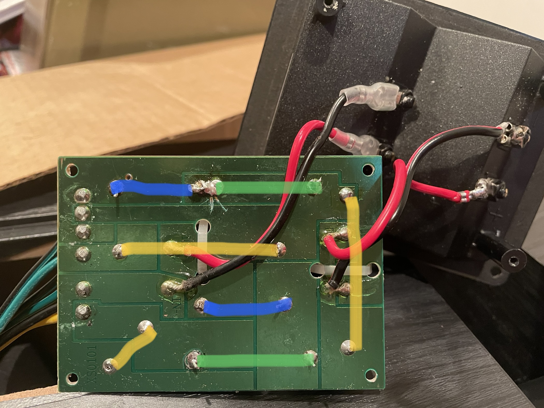

Photograph the board from both sides and print off.
This makes it easier to follow the connections.
I appreciate the suggestion. Right now I have both pictures on my phone; printing may be easier. I’m still skeptical I’ll be able to trace it properly. I’ve looked at the bottom a few times and it just seems confusing.
That is how you reverse engineer a product: characterize it, dissect it, document it. This all takes work.

OK. I uploaded a photo that I drew on. It’s a bit amateurish, I know, but here we go.
1. It’s a dual binding post speaker so (obviously) it has the two positive/negative ins.
2. On the left are (from top to bottom) woofer, woofer, tweeter. My understanding is Polk calls this a phased array meaning both woofers run in a two-way but roll off differently. I’ve read it could be seen as either a two-way or 3-way crossover. 🤷🏼*♂️
3. Polk specs say the speaker is 8ohm.
4. The blue lines are resistors. Top left is 5W 6.2ohm. Middle is 5W 0.75ohm.
5. Yellow are inductors. I don’t know the specs.
6. Green are caps. Top is 22uf 400V. Bottom is 8.2uf 400V.
What’s most confusing to me is which component connects to which. I can figure out a few of the more obvious connections but the others I just can’t wrap my head around. Plus, the dual binding post really sends me sideways.
Anyway, any help with what connects to what so I can toss this board and simply connect the components would be great. Thanks!!

Other (component) side photo please...

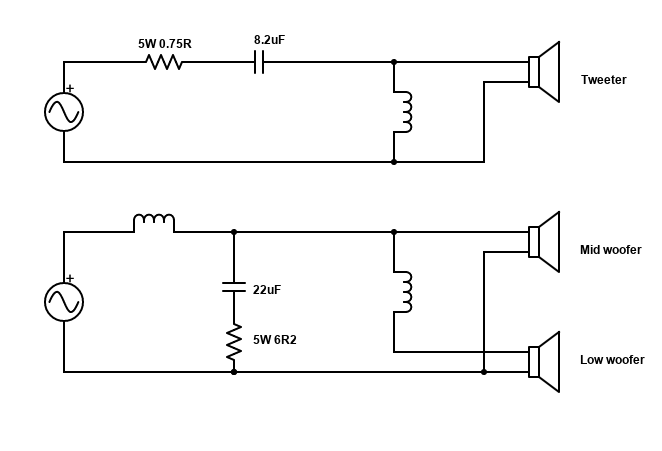

The tweeter is connected separately to the amplifier?
If not, please make the drawing again, as if the three elements are connected to the same terminals.
It is tweeter, mid range and woofer, also sometimes sub woofer.
And some schemes use more than 4 to 5 elements connected to the same input. But not relevant here.

As for the board, I removed the stock components, replaced them with the new ones, and the speakers just didn’t work. At first glance, I thought I may have burned the board because I was a bit heavy-handed with the soldering iron. (See pic) So first I tested the components. Resistors read proper ohms and the caps read OL off the board which I’m told tells me they aren’t shorted. So then I tested the board with my multimeter where one of the caps is designed to sit and I got at .9 (or something close) milli-ohms response, and not OL, which I’m told means that part of the board is shorted. At that point I stated to think I may have damaged the board elsewhere and should try and connect the components point-to-point and disregard the board entirely.

Yes, for bi-wiring. Presumably there are post jumpers.The tweeter is connected separately to the amplifier?
It also called 2.5 wayOn the left are (from top to bottom) woofer, woofer, tweeter. My understanding is Polk calls this a phased array meaning both woofers run in a two-way but roll off differently. I’ve read it could be seen as either a two-way or 3-way crossover.
If you have a pair, use the PCB from other speaker as a reference.I tested the board with my multimeter where one of the caps is designed to sit and I got at .9 (or something close) milli-ohms response, and not OL, which I’m told means that part of the board is shorted.
Yes, I currently have them bi-wired because the post jumpers are junk.
Please correct me if I made any mistakes
Thanks again for this! I’m going to lay this out today and see if it works. If it doesn’t, clearly something is off with one of the components. I’ll send a pic when it’s done.
Well all is complete and things went swimmingly. I can tell the differences already with the most noticeable being the separation between instruments that I didn’t hear before. Everything sounds less muddled. Thanks again for everyone’s help and suggestions. I’ll be sure to stay connected to the board going forward!
Your board (pic post 10) does look rather blackened.
however, the board is heavily plastered with some sort of glue (to secure the components).
It may be the glue that has burnt and so a bit of cleaning and scraping might resolve the issue.
