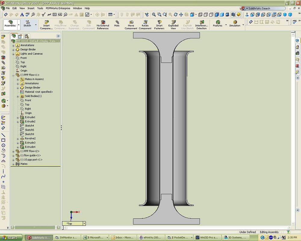

Wow this is a blast from the past...That's my screenshot from eons ago!
This type of port works and does seem to offer some improvements in air noise, but I never did objectively verify that.

No kidding. SW2007, that takes me back.🙂Wow this is a blast from the past...That's my screenshot from eons ago!
jeff
Haha...Yes SW's 2007. I barely knew what I was doing back then. I had maybe 1 or 2 years experience at that point.

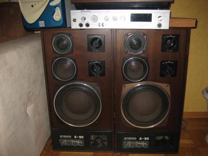

I remember when I was a small child the only decent speakers in Soviet union were radiotechnika s-90. I've heard rumors that those were copies of Yamaha ns-1000 speakers but not confirmed. Just rumor you know.
Looks like ports resemble x-ports in a way. What do u think? Or just aesthetics and protection against big rodents or cats trespassing or squatting inside speakers
No clue, but going with the latter since sad, but true, too much of the so called civilized world still struggles with the problem, not to mention all the little critters, i.e. Roaches, ants, etc., that can (have back in my youth) wreaked havoc till I wised up.
