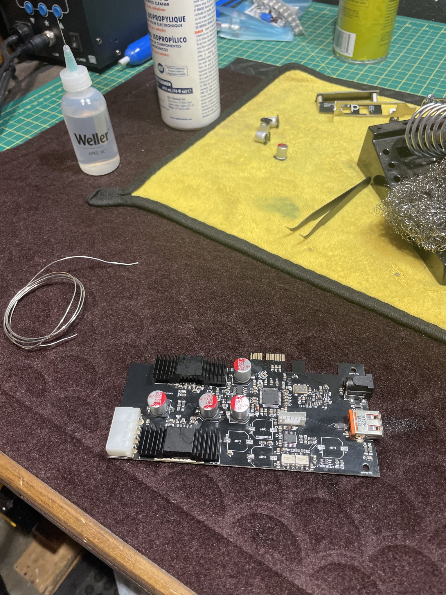

So I have been arguing with AI on the pros/cons of switching from SMD electrolytic capacitors to SMD polymer on my computer PCIe USB card intended for audio and the benefits/drawbacks of each. It boils down to ripple current, but how much of a factor this plays considering the benefits of way better ESR and ripple from polymer - what is your take.
If we compare two caps:
Factoring this is a digital audio signal on a USB card, is leakage much of a concern or would be benefits of the polymer be evident translated to sound differences.

I doubt that 680 microfarad capacitors are being used for anything except power supply smoothing ("bypass"). In power supply smoothing applications, 2.2 mA of leakage current is completely insignificant. Especially since this is a "USB card" which suggests AC mains power, not battery power. Electrolytic capacitor leakage won't drain the battery if there is no battery.
Thanks Mark, so you'd align with my thinking that the polymer would be optimal in comparison - now whether this would translate into any tangible sound benefit, that would be interesting.

AI doesn't work well for this sort of question because it doesn't ask questions back. In particular, you can't choose between them without knowing exactly what they are used for. For instance, if this is at the output of a SMPS, it might have to handle high ripple current, where low ESR will help. If it's not, then low ESR may actually be harmful, as it won't be as good at damping resonances with nearby inductances.

IMHO, stick with what the designer decided to be appropriate. Only when you have a schematic and clearly understand it (as well as the PCB layout) and have professional equipment to verify performance, then you might try things like this successfully.You guys think the polymer move isn't worth the hassle or is there something there you think?
Of course there is nothing wrong with still trying and see what happens, just for fun.
For sure, it’s a small investment generally speaking and an hour or so of having some fun adding what could be an ‘upgrade’ - just trying to wrap my mind around thoughts on any potential sound benefit. Lower ESR, higher ripple, on a computer usb pcie card intended for audio? For smoothing, maybe not a shred of difference, maybe something there …. Certainly wouldn’t harm much.

Well for closure on this, I swapped out all 8 electrolytics for polymer - same brand, Wurth, to maintain the land size available. The ESR difference x 8 makes a difference. Whole thing sounds more accurate, maybe more detailed but tighter sounding while maintaining the great fidelity of the card.
Lesson learned for me - polymer for digital and power all the way.
