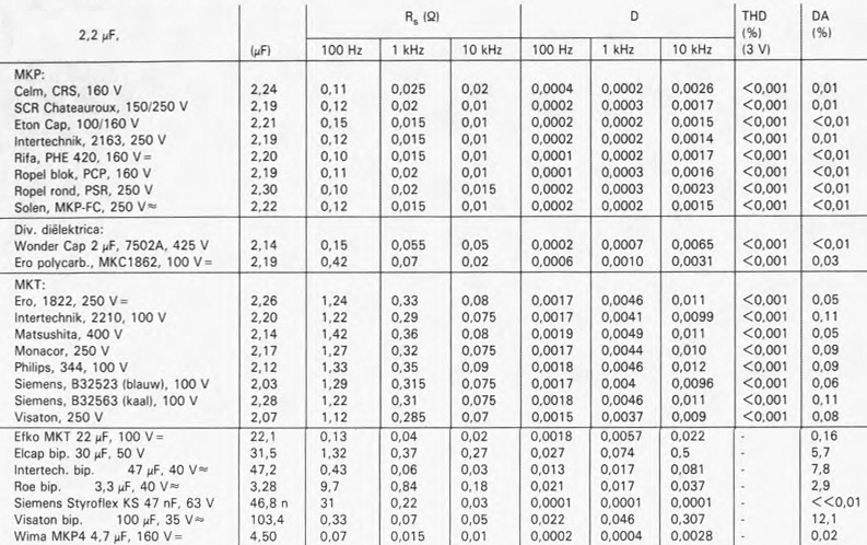

Elektor tested caps for audio back in the 90'ties: MKP the best.

The article which Sam Groner and Scott Wurcer wrote for Linear Audio Volume 12 ("Quadrature Bridge Measures Harmonic Distortion in Capacitors") indicates that C0G have much more consistent distortion than polyester or polypropylene. While the hybrid metalized polypro can be much lower, it can also be much higher!
Reactions: Bonsai
Those tests appear to show that distortion was below the measurement threshold for all film caps, so in what sense is MKP the best - based on those tests? DA does not count because DA does not affect audio.
True about the distortion , but since this was an arcticle from 1991 , and the way they measured the distortion (at 250hz ) , I wouldn't trust it too much. Elektor says that DA does have an influence on the sound quality .

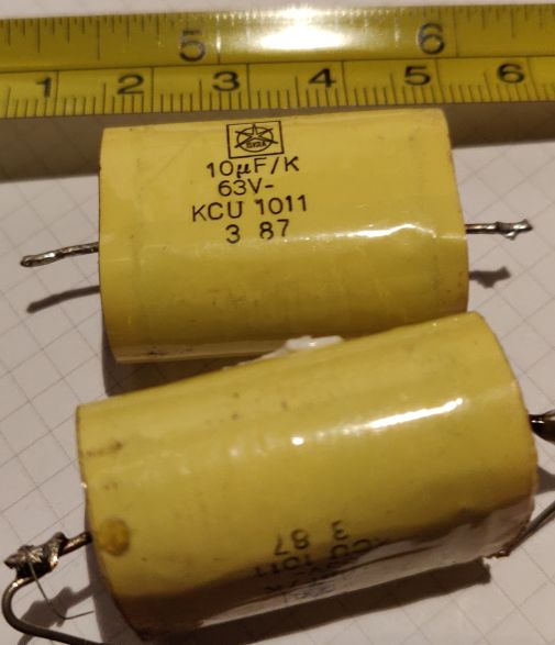

If you accept NOS, I only know about "Iskra" oval - KCU polycarbonate type. Search in Slovenia.
As far as I know, "Iskra" copied German ERO capacitors.
Polycarbonate is a great sounding capacitor.
Philips HQ-MKC is superior, but I don't know that there are below 100V. I use 9,2 uF/100V.

I use low voltage polycarbonate caps when I can find them for applications where I need small size, and can live with a low voltage rating. Polycarbonate is tougher stuff than polypropylene, so you can used thinner films and still tension them properly. I grab Wima and ERO MKCs when I can find them. I also have a bunch of Sprague polycarbonates back from when dinosaurs roamed the earth...
I will mostly use them as input caps and as coupling caps in a "Nakamichi" type feedback arrangement (anything to avoid putting an electrolytic in series with my feedback network).
DA is a very low frequency phenomenon and appears to be linear so that is two reasons why it cannot affect audio. However, it is conceivable that DA is correlated with some other unidentified dielectric problem which does affect audio. If so, nobody knows what it is and blaming DA diverts attention from whatever the real issue is. Personally, I suspect that people are just afraid of DA without actually understanding it and so 'hear' poor audio with a high DA cap - but only when they know DA is present.
