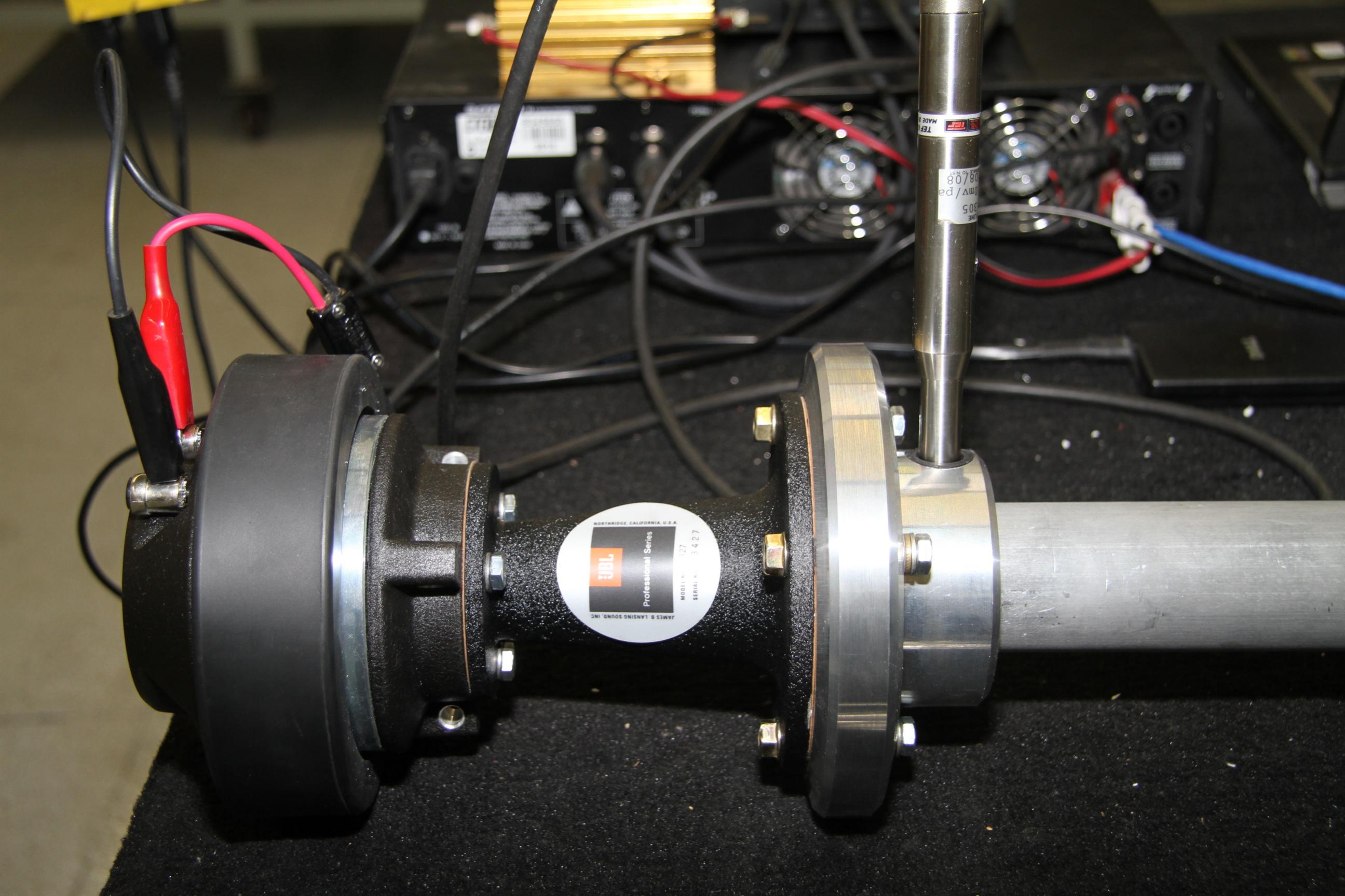

I have one, how can I help?

Cool PWT. Looks like a pro setup.
I'm curious how the mic is mounted--in some kind of a soft grommet to isolate from vibration, or is it hard-mounted?
Also curious about the adapter--looks like 1" to 2"? Does that flare compromise anything?

As I outlined above, below say 5 kHz for a 1" driver almost anything works. There are only plane waves and the mic doesn't matter so much, neither does the mounting, etc. But above about 5 kHz and all the problems that I write about above start to come into play.
So what may be the most reasonable approach would be to just start with a system, get widespead usage and then refine it as required.
I just want to be clear that the simple approach is not going to be very good above about 5 kHz.
