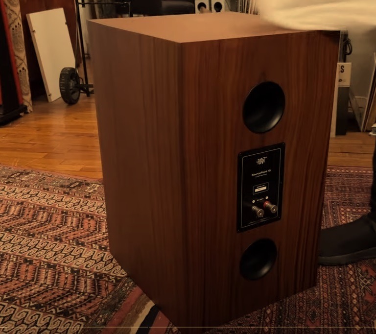

Is there a formula or calculator to figure out the optimal placement of single or dual ports on a ported box?
Andrew Jones mentions it while unpacking his latest design
The idea is to place them such so the enclosure's internal standing waves are cancelled out at the farfield. Does it mean two ports are necessary? Can someone help with this or provide tips?

There are standing waves in the box, between every two opposite boundaries (and perhaps some complex ones, but lets keep it simple). If inlet of a port is at pressure node of a standing wave, the sound likes to leak out like he says.
Usually a speaker box has some damping material in it, which is more effective the shorter the wavelength, hence standing waves are less problematic the higher the frequency, the higher the harmonic, right. Also woofer is low passed at some point and out of band wouldn't get excited that much either.
So, most problematic modes are the lowest ones and especially for the longest dimension, which is usually height. Lets consider modes of height of the box. Perhaps two or three first 1/2wl, 1wl, 3/2wl would be the most problematic. Pressure nodes of these are at the boundaries, and then 1/2wl doesn't have any more, 1wl has one pressure nor middle of the box, third harmonic or 3/2wl has two pressure nodes in the box, at 1/3 height of the box. And so on.
So, the ports should be located so their inlet is not center of the box, 1/2 height, nor 1/3 height of the box but some where else. Perhaps reasonable compromise is to have them somewhere 1/4wl height or so not to leak much the lowest most problematic standing waves, or harmonics.

Golden ratio. So located about 62% down the longest dimension of the box.
Alternatively, any pair of ports arranged asymmetrically along the longest dimension of the box should be pretty damn good.

Yes, for example single woofer middle of dimension basically prevents the lowest mode happening on that dimension, something AJ seems to be utilizing with the speaker in question. Not sure if he mentions this on the video? With two woofers symmetrically placed would also have acoustic center of the dimension as well.
So, woofer on the middle handles 1st harmonic, ports not in the middle reduces leakage of 2nd harmonic to minimum, using two ports symmetrically negates at least some of 3rd harmonic leakage, rest is probably less offensive anyway and affected by damping material. Very fine solution for such speaker concept I think, ported two way speaker.

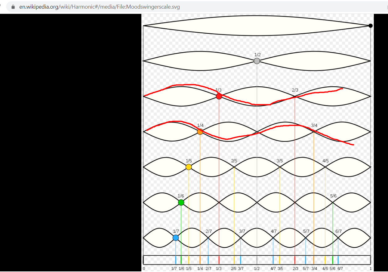

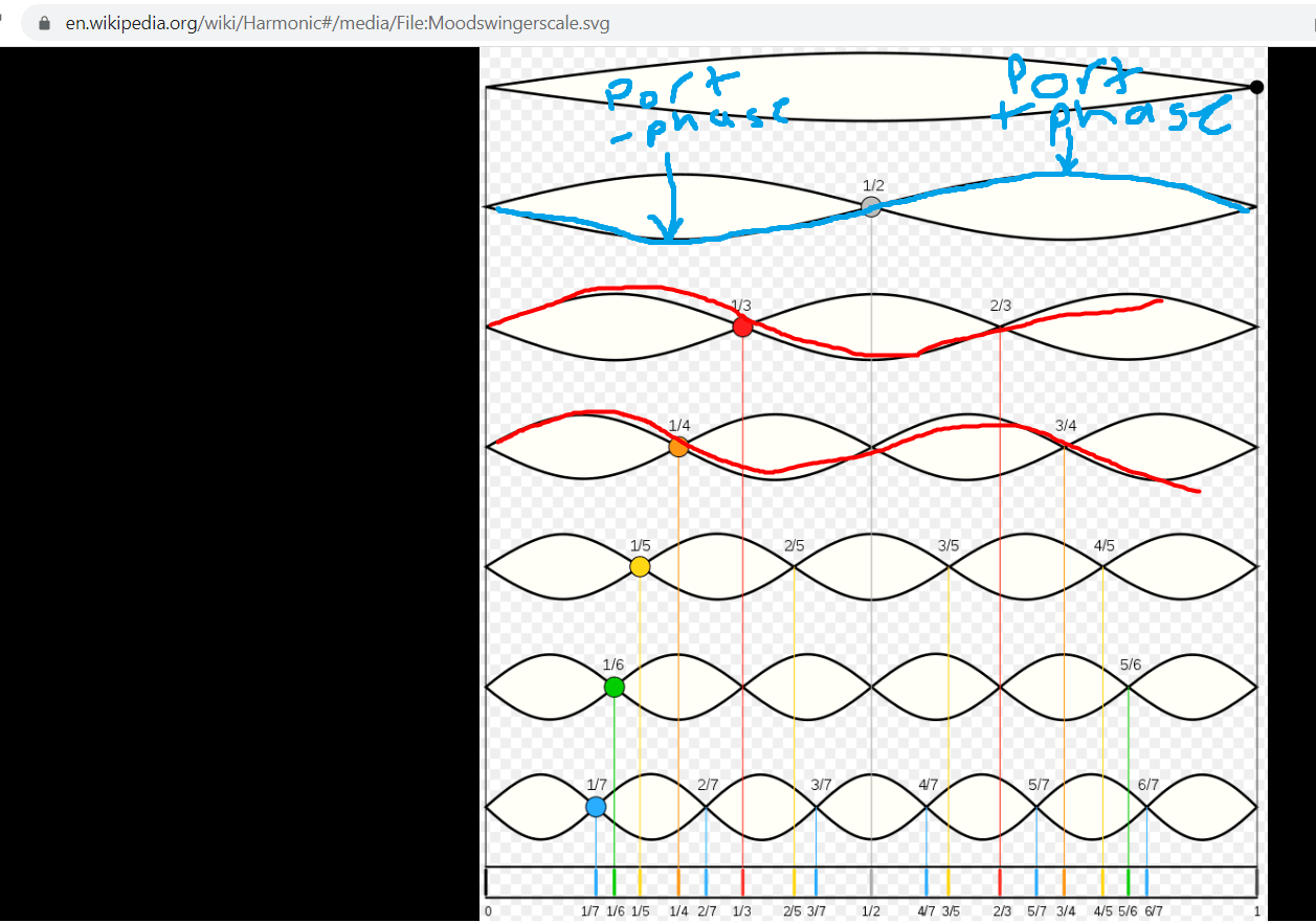

I took his explanation to mean placing the ports at 1/4 ID, so they are both addressing the same mode, but the phase is opposite at the two points, so the sound emitted for that mode cancels out in the far field.
check out this graph to imagine it
I've traced the 3rd and 4th harmonic. These have pressure nodes 1/3 and 1/4 of the dimension where the ports are roughly located. In order for the port leakage to cancel out they would need to be opposite phase I think. If you follow the red marker line you'll see 3rd harmonic wave being opposite phase on the nodes where ports would roughly locate, while 4th harmonic have them in phase. But I could imagine this all wrong, as its standing wave sound is going both ways which is the definition for standing wave, there is time involved and so on. Perhaps its enough just to have them ports symmetrical for some cancellation happen. Perhaps he just slapped them there roughly and the performance is good enough so not too important where they are at as long as not at the walls and symmetric, or something. After all the leakage should be less if they are not exactly at the nodes. Perhaps its best to have them right there that takes account more things I'm able to fathom 🙂

I think you right regarding those two modes, but looking at the mode above those, I think he is doing this:Hi,
I assume the first couple modes are the strongest, so he just trying to suppress one of them. But I'm really just guessing.
Yeah the few lowest / strongest ones are the problematic. The second harmonic has velocity nodes where you have marked them in the image, and you are right they are opposite phase and its easy to visualize from this kind of graph/presentation. But, those velocity nodes have pressure minima, in other words that second harmonic has almost no sound there. Pressure maxima and boosted sound is at the pressure nodes which are at the walls and center of the box for the second harmonic.

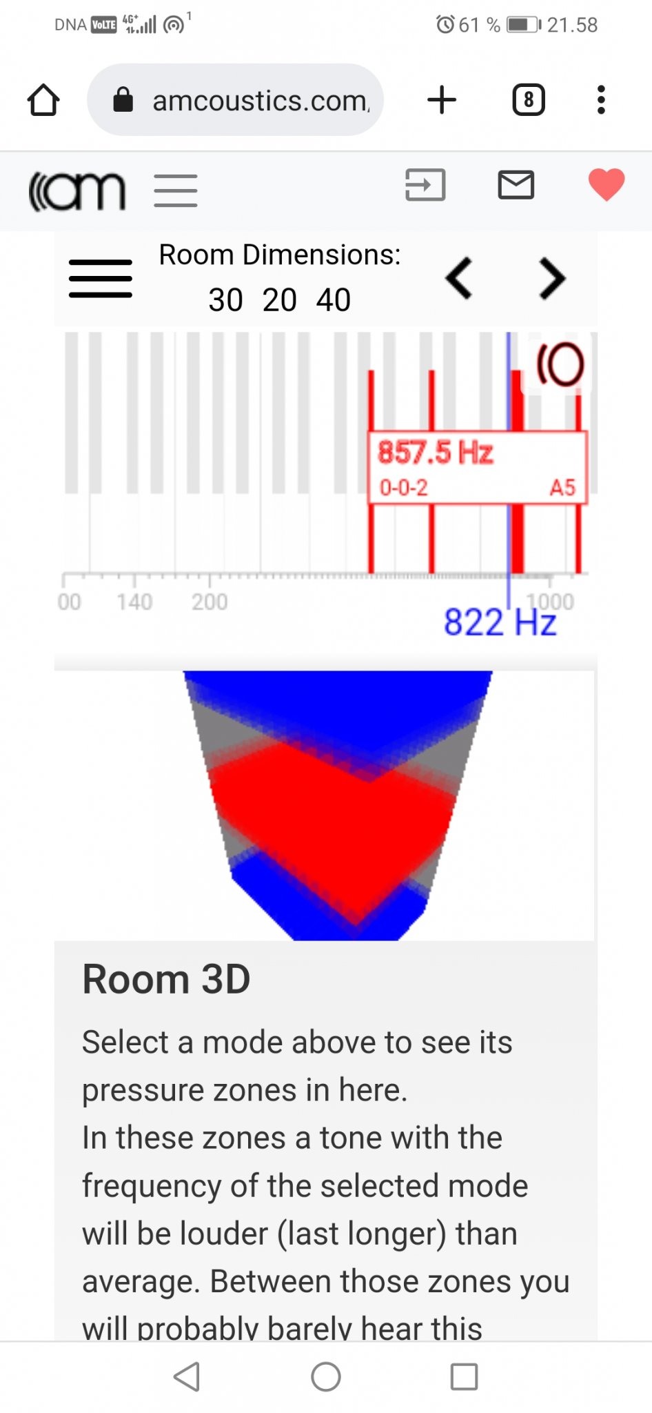

These are analog to room modes and you could think how room modes sound, lots of boost near walls and middle of room has peaks there dips here. Room mode calculators can be used to look where pressure minimums are, multiply speaker box dimensions by ten and input as room, inspect sound pressure peaks and nulls.
Can I just say that 3700 bucks is alot of money for speakers of this nature. I'm curious to hear these things, but I'd never buy them even if I had the money. A fair price would be half that IMO. In fairness, they are using a custom driver, but its still rather steep..
The vibrating string image is kind of misleading, although easy to get quick look where the nodes are/line up its kind of reverse to where is sound and where is null. See amroc room mode calculator, has nice visualization for axial modes. Colored areas have sound and empty space not so much. It seems to work in loudspeaker box scale too, which is nice 🙂... visualize from this kind of graph/presentation...
https://amcoustics.com/tools/amroc
