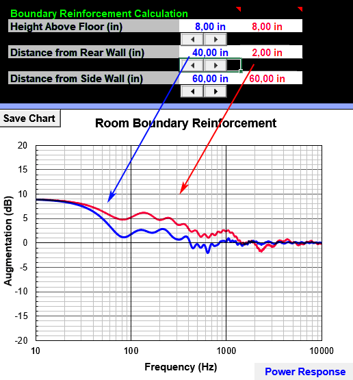

correcting and refining my statement above here is a simulation of back wall distance 40" and 2" done with jeff bagby's excel-tool.If you place it near the back wall you get reinforced and possibly bloated bass response.
@colmo: keep in mind that this may not apply to your speaker, it's just an example for an idealized speaker, assuming arbitrary values!
