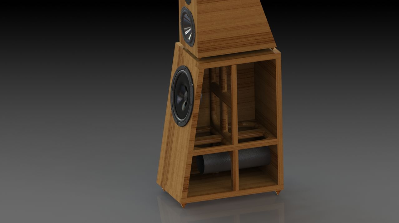

Thanks to you both for the input. My heart sank when I read the first post. Another facet of speaker building that is technical and critical. The second post was good news. My reason for asking is that I am looking at an established 3-way design that has the woofer in a separate ported box but doesn't specify exactly where the port is located on the plans. Several builders of the design have placed it somewhere on the back panel but I kind of fancied it up front, but where to place it...................
haha, sorry, i think it is not that critical since there really isn't that much emphasis about the port placement in this forum or if you do some googling. However I think it would be good to take a look where commercial similar sized speakers have their ports placed. I thought to write all info I've gathered lately, for reference.

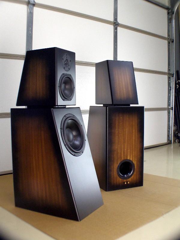

Simply achieve a symmetrical arrangement of woofer and port openings. If it looks right, it will no doubt sound right!I kind of fancied it up front, but where to place it...
Depending on port resonance frequency you can put it on the front baffle, in some cases mounting on the rear baffle will help and in others it will make a mess where ever you put it. So, with that in mind, at what frequency does your port resonate* ?
*Not to be mistaken for cabinet tuning frequency.
With modern speakers being narrow and also smaller, there is no place to mount the port on the baffle then it will be to mount it on the back. Then we should not forget that some do not like to see a hole on the front so then design so that the port on the back.
My two cents.

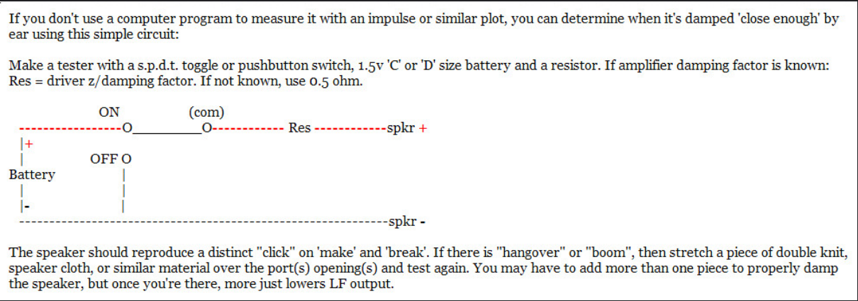

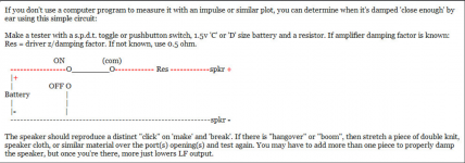

Not necessarily since we don't know the size, shape of the box nor its XO point/slope as tmuikku's post rightly points out that all this can matter.
If it's a typical relatively small cube or mildly rectangular cab and doesn't have a real long, large a vent, then sure, it doesn't matter where on it the woofer, vent is since it should have a ~uniform particle density and a bit of damping should quell any cab eigenmodes, woofer HF and if the vent is large, long enough to have audible pipe harmonics, then critically damping the vent per below or using an impulse response is a good plan.
GM
